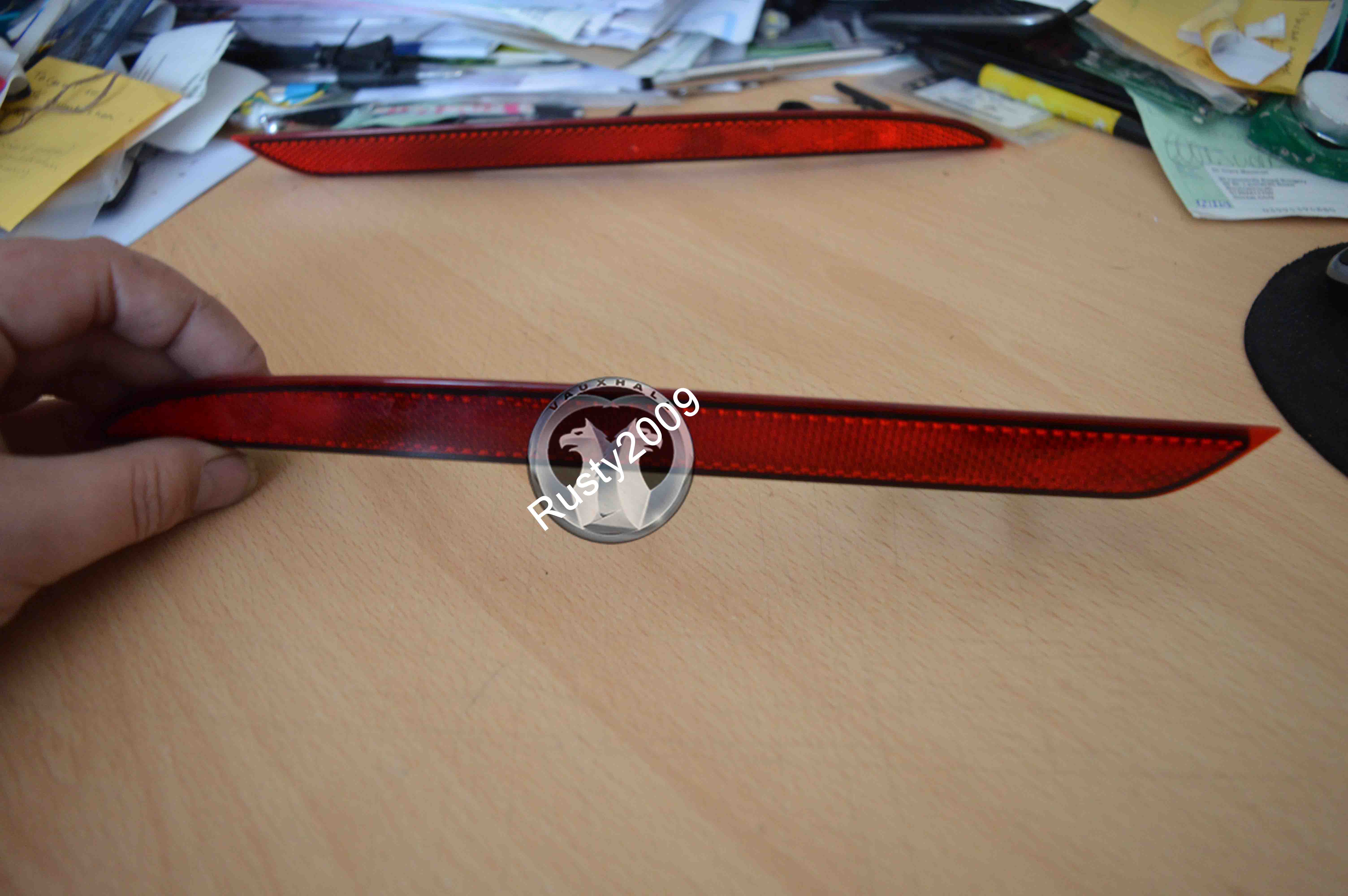

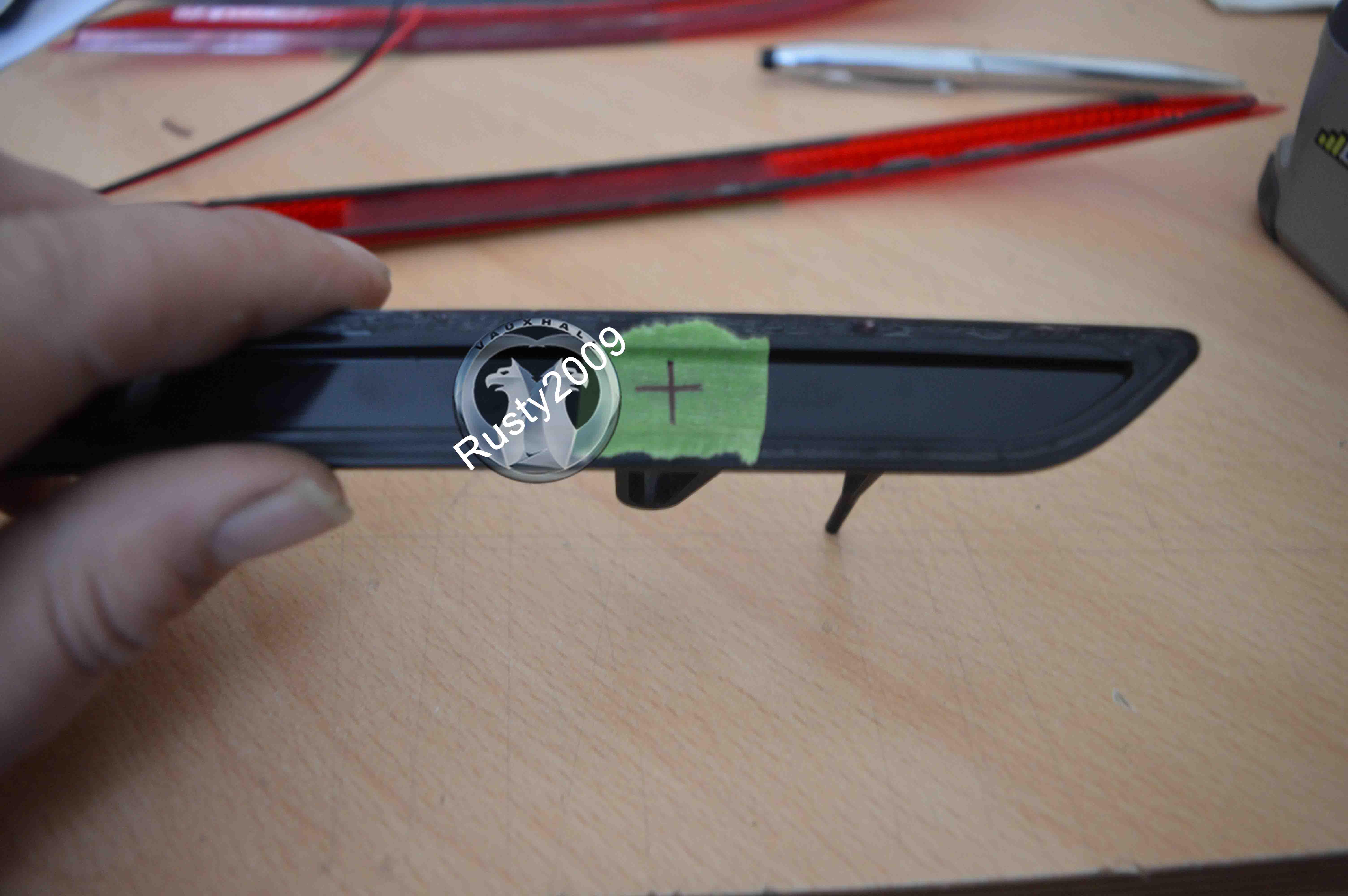

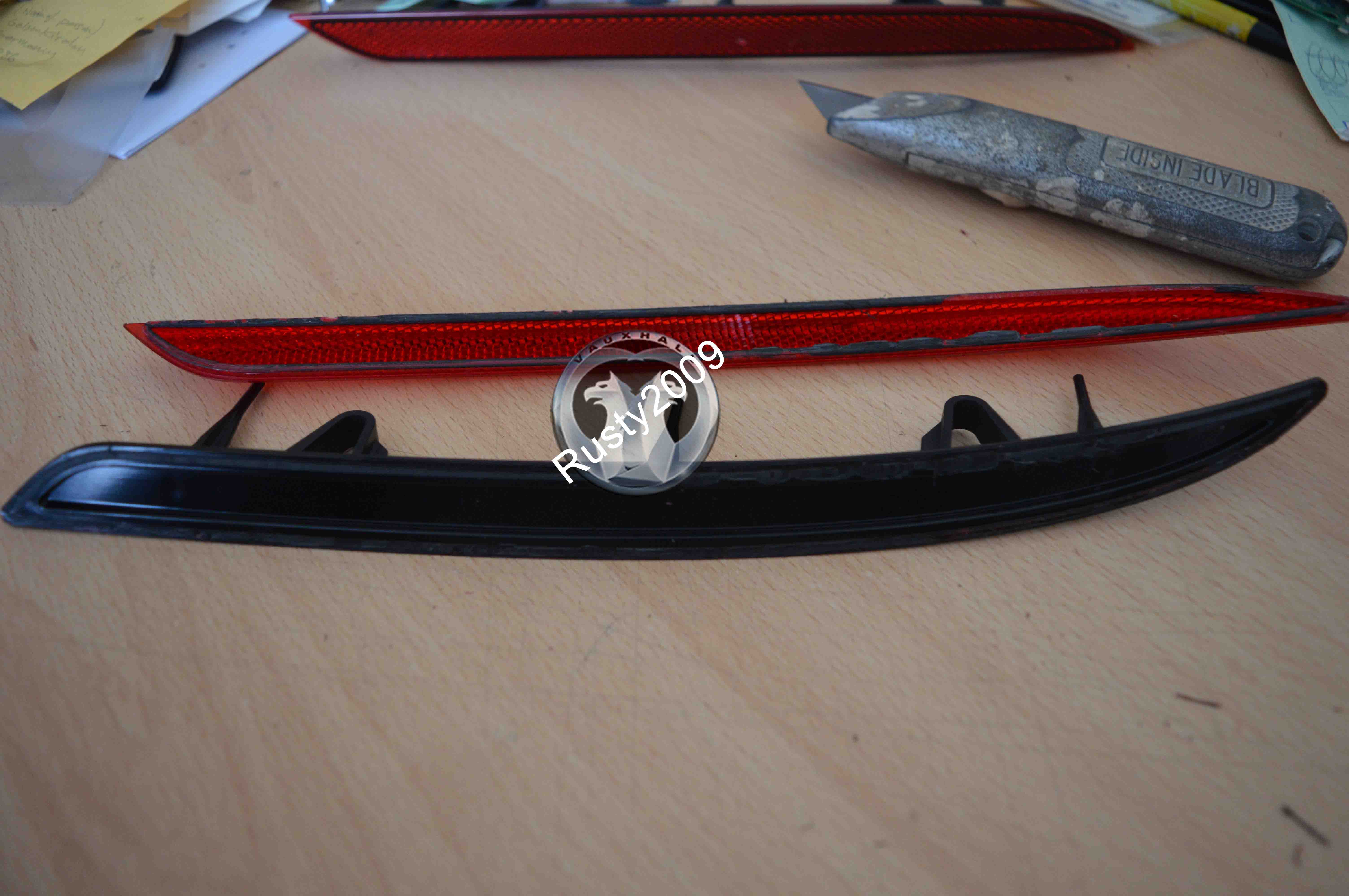

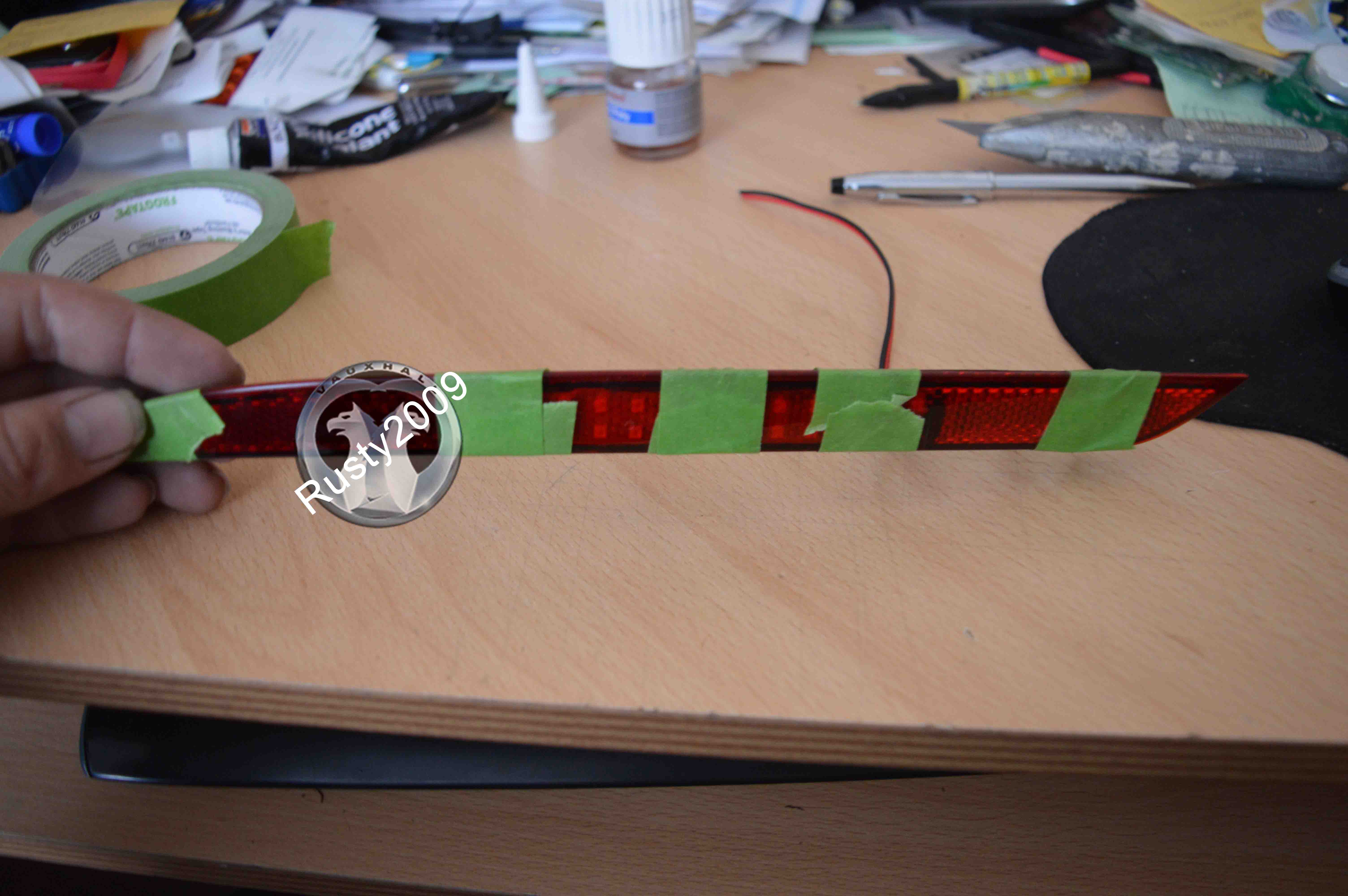

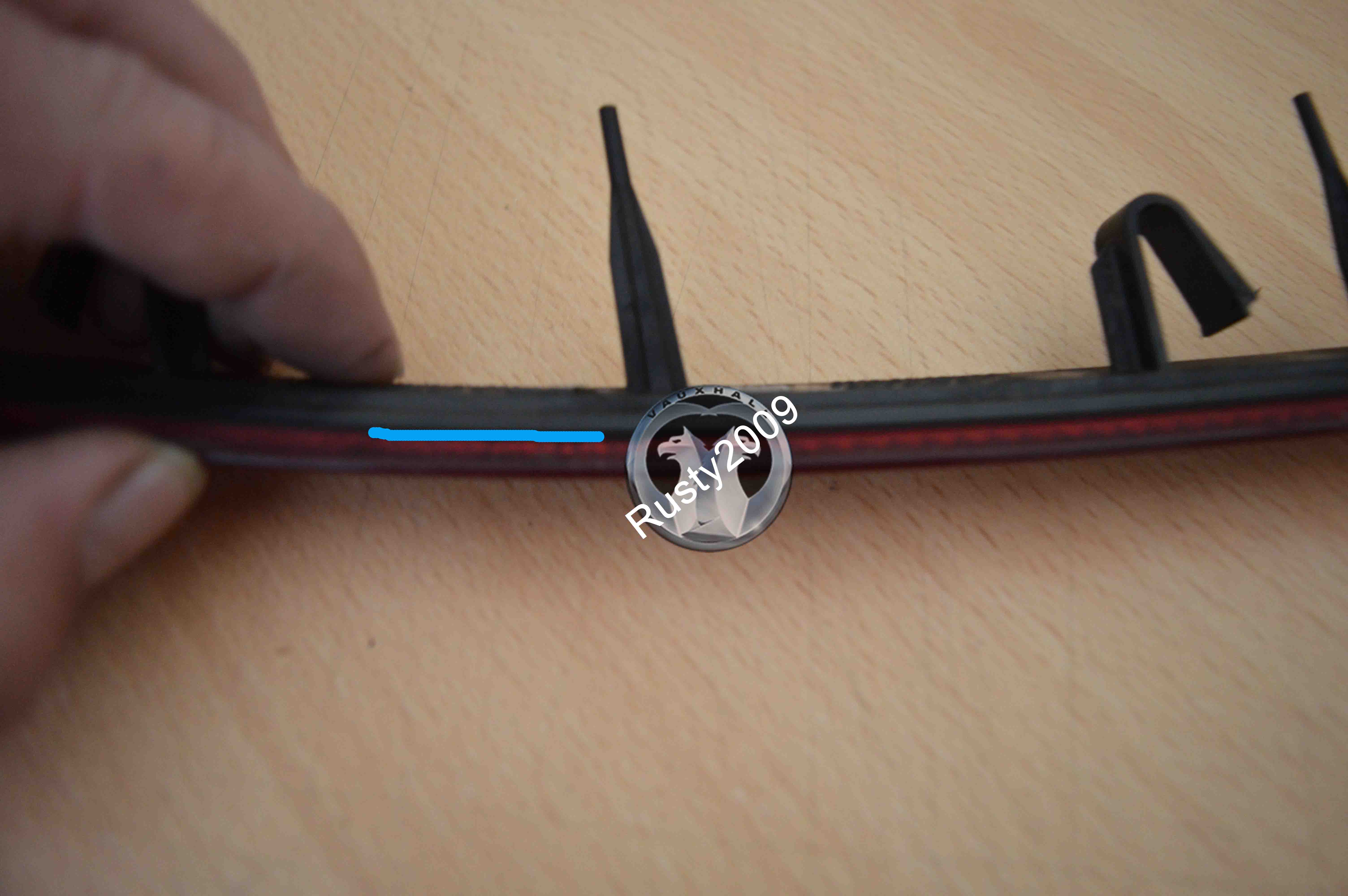

So start with the reflector

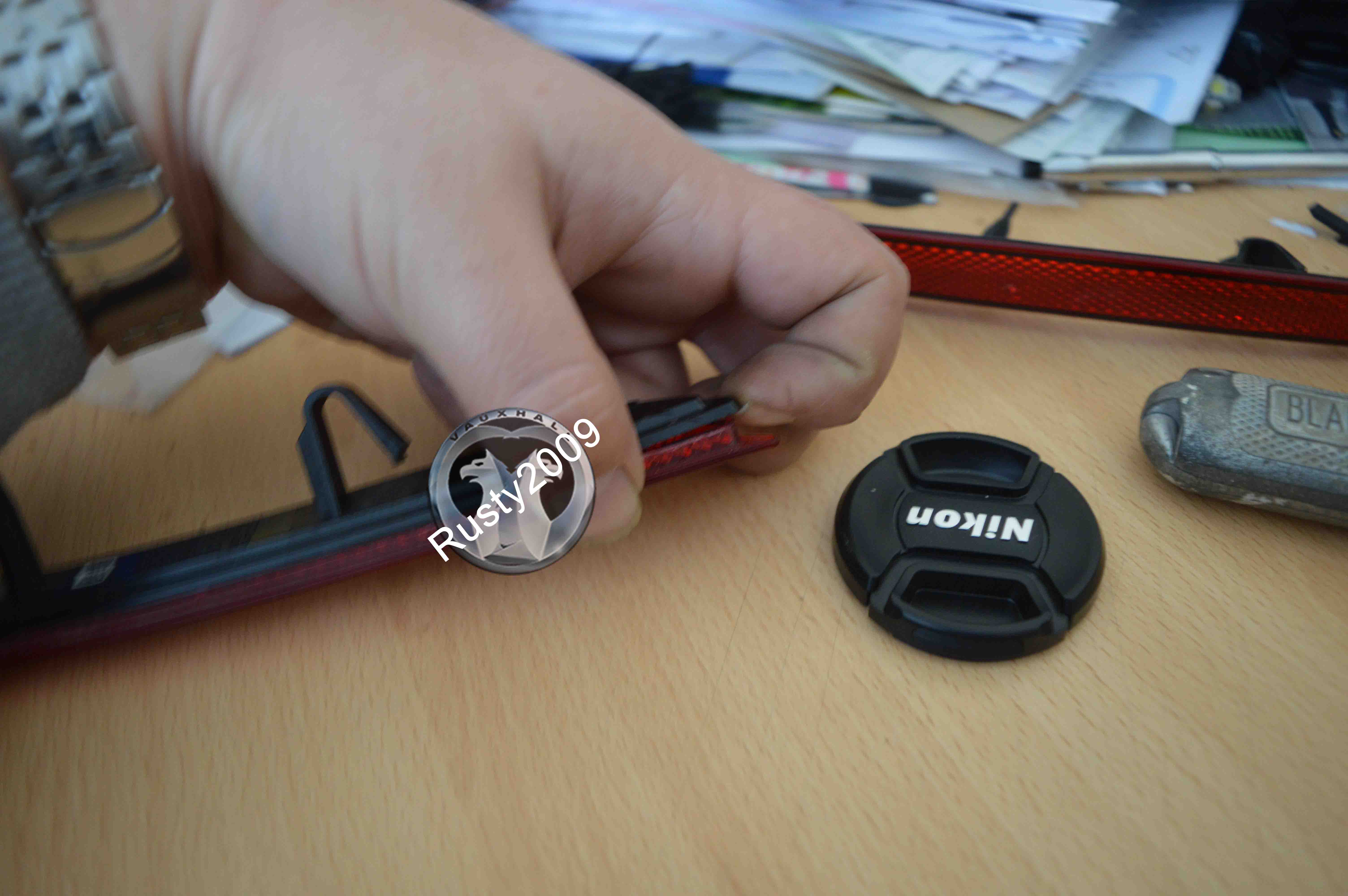

We need to cut though along the blue line

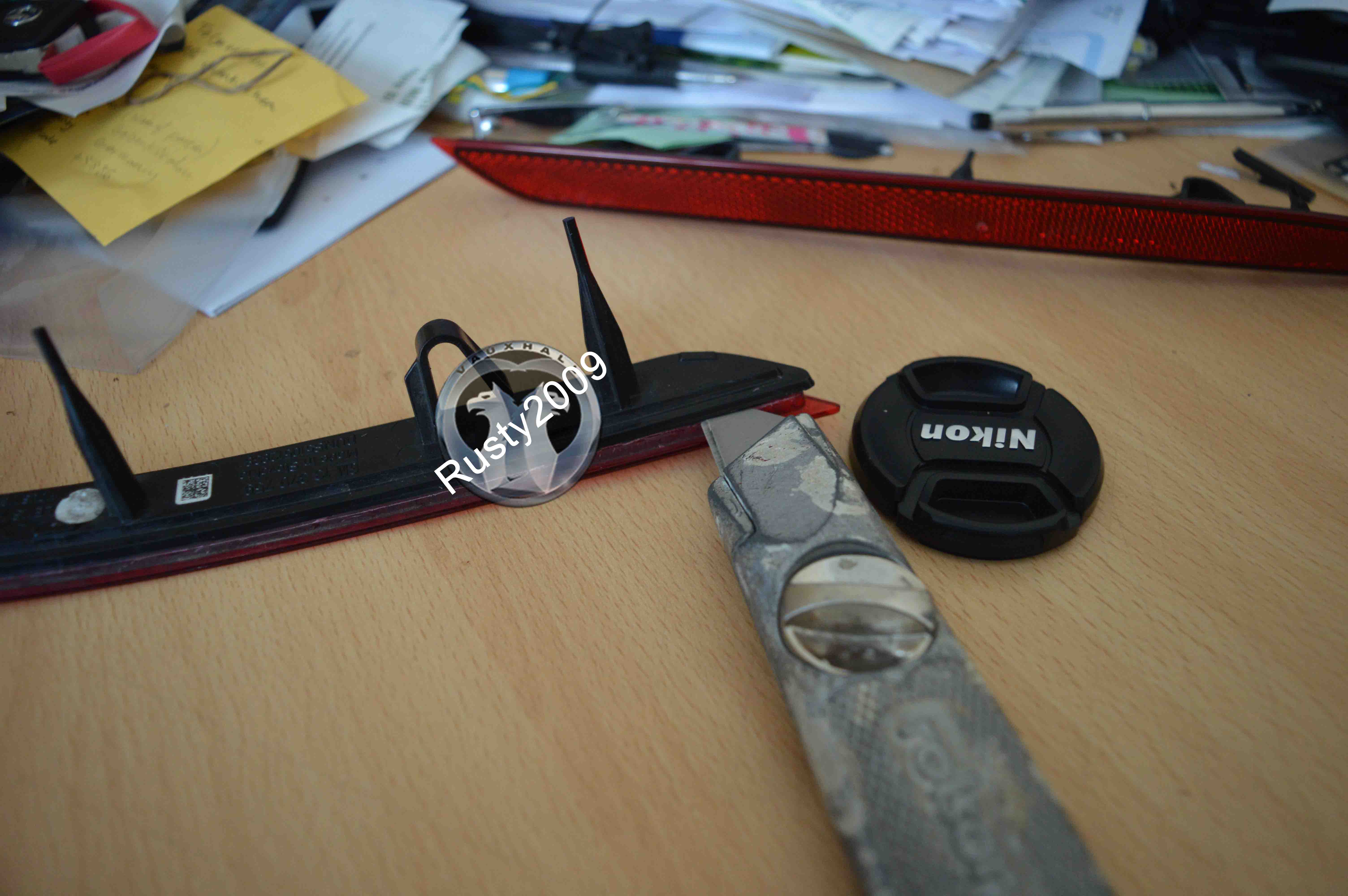

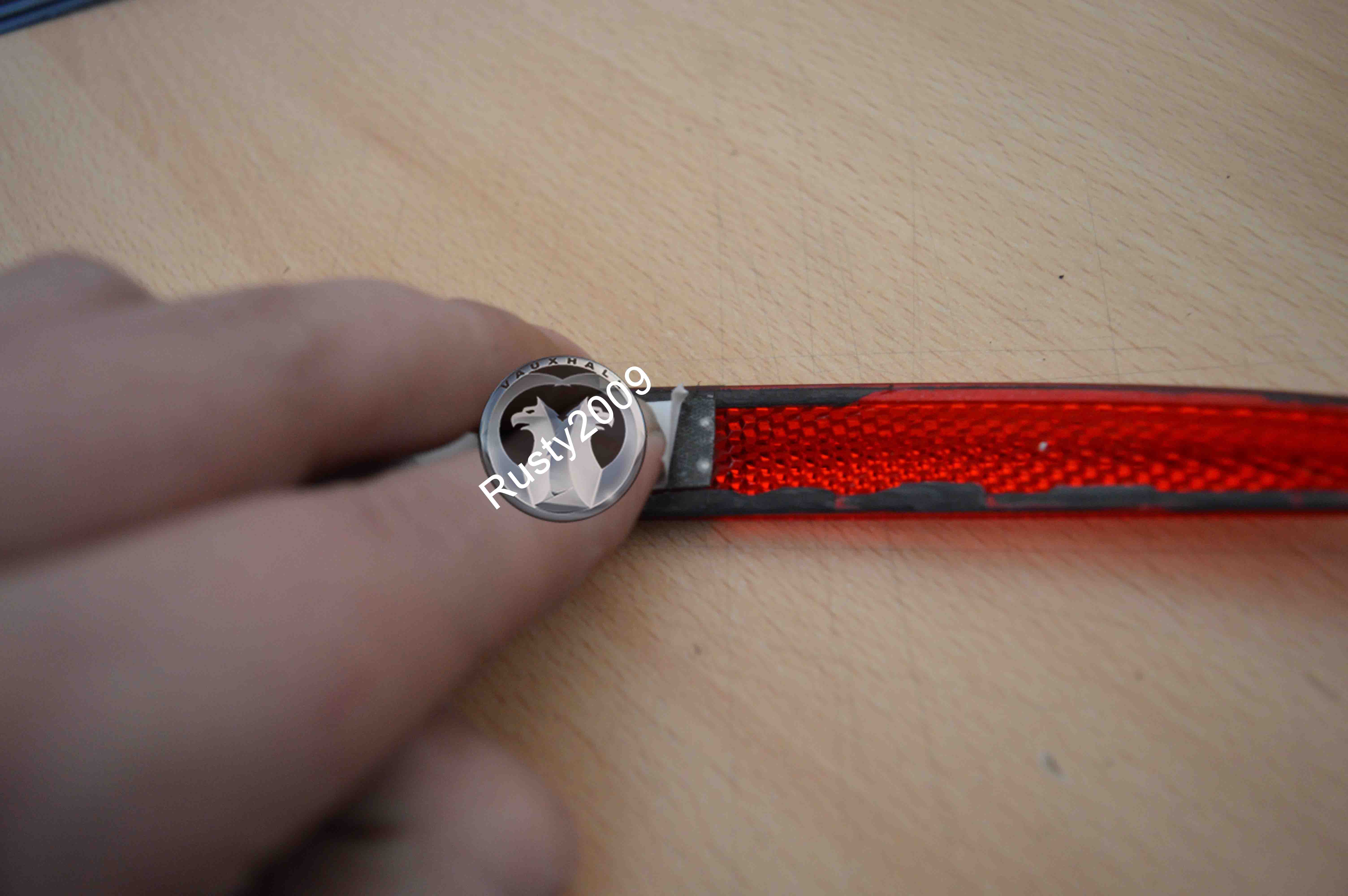

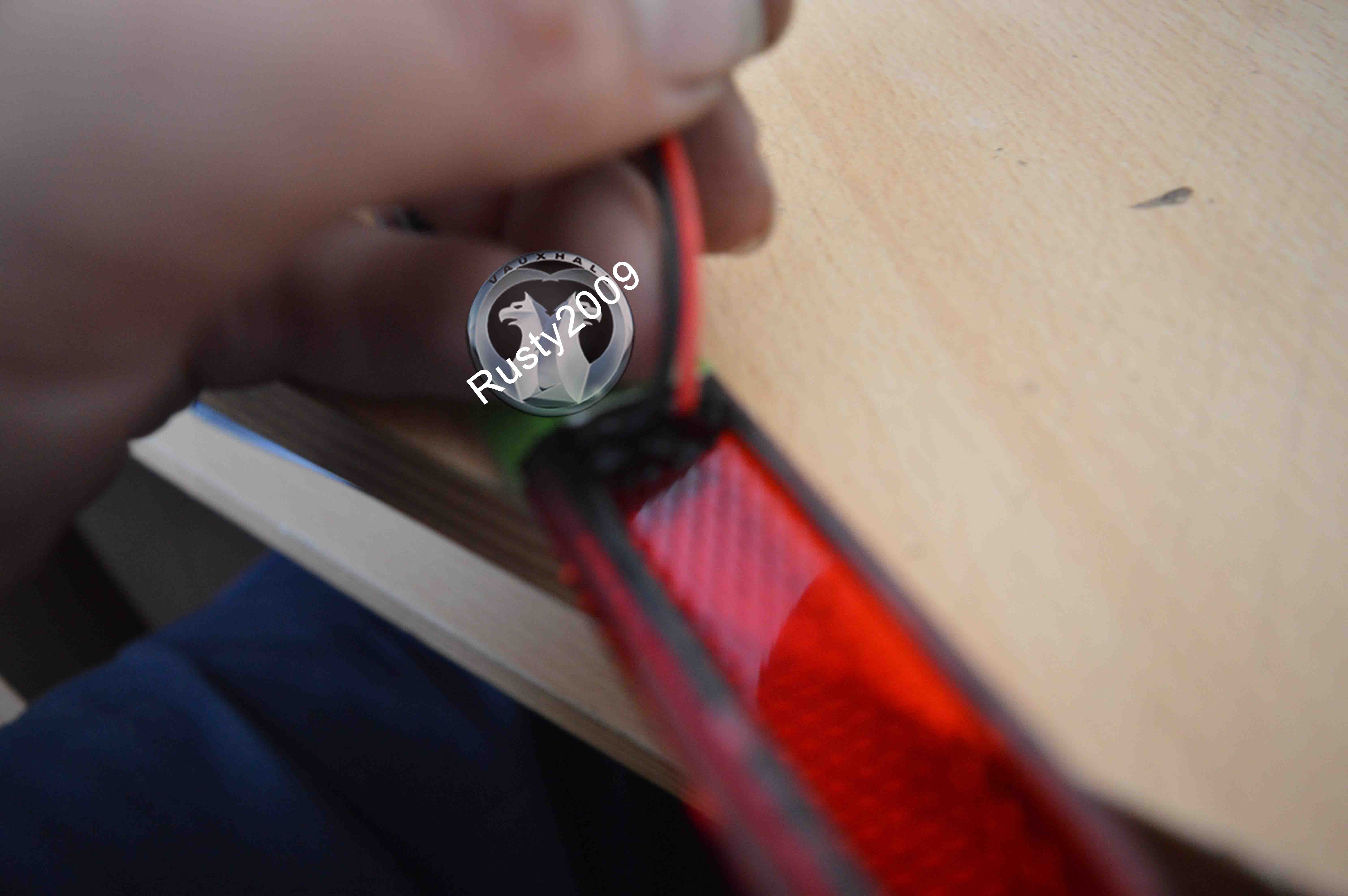

The best way I found was start at the biggest end of the reflector and get the end started
Then you can run the knife along in-between the two parts

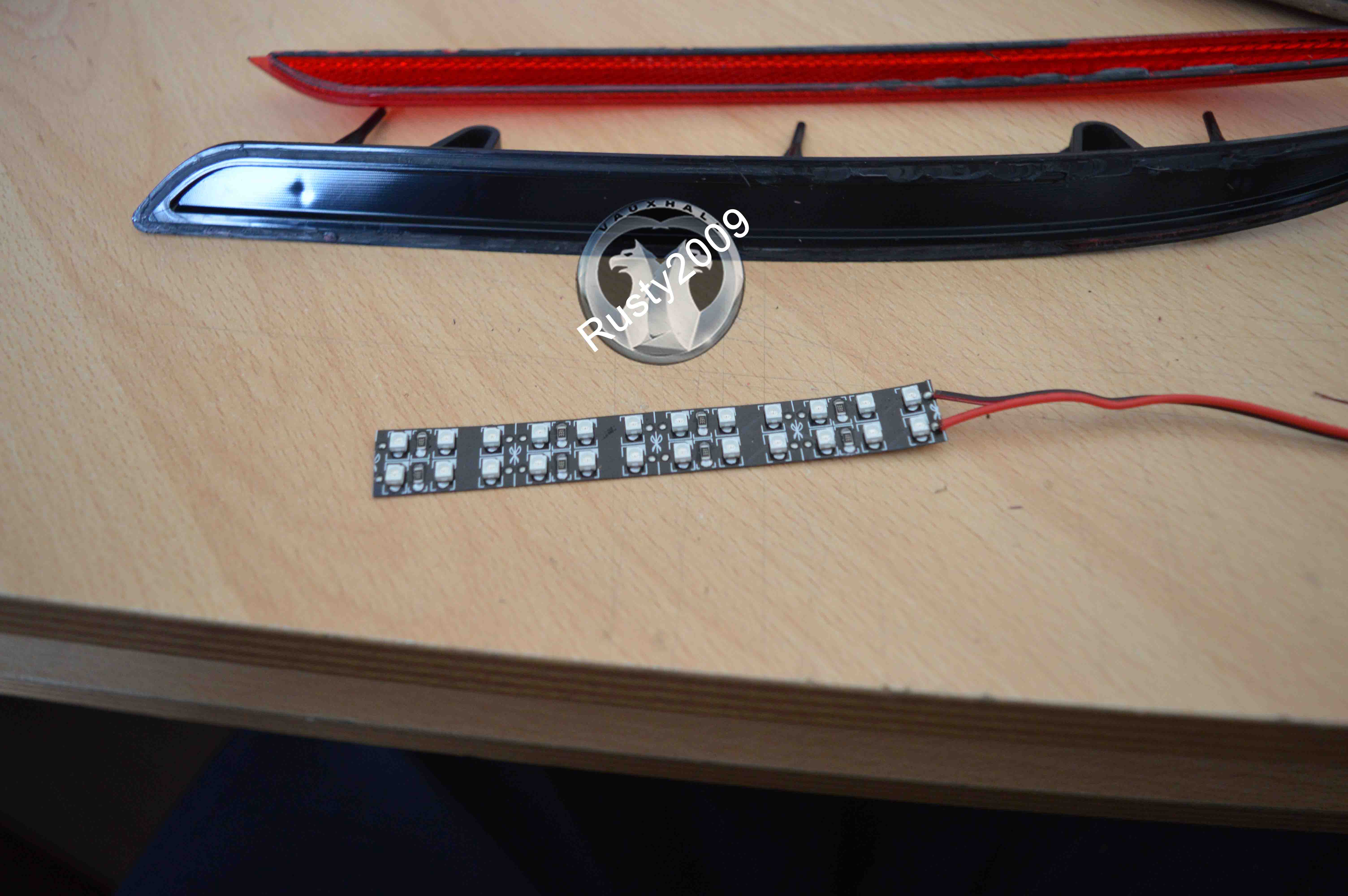

Get one of the LED strips ready

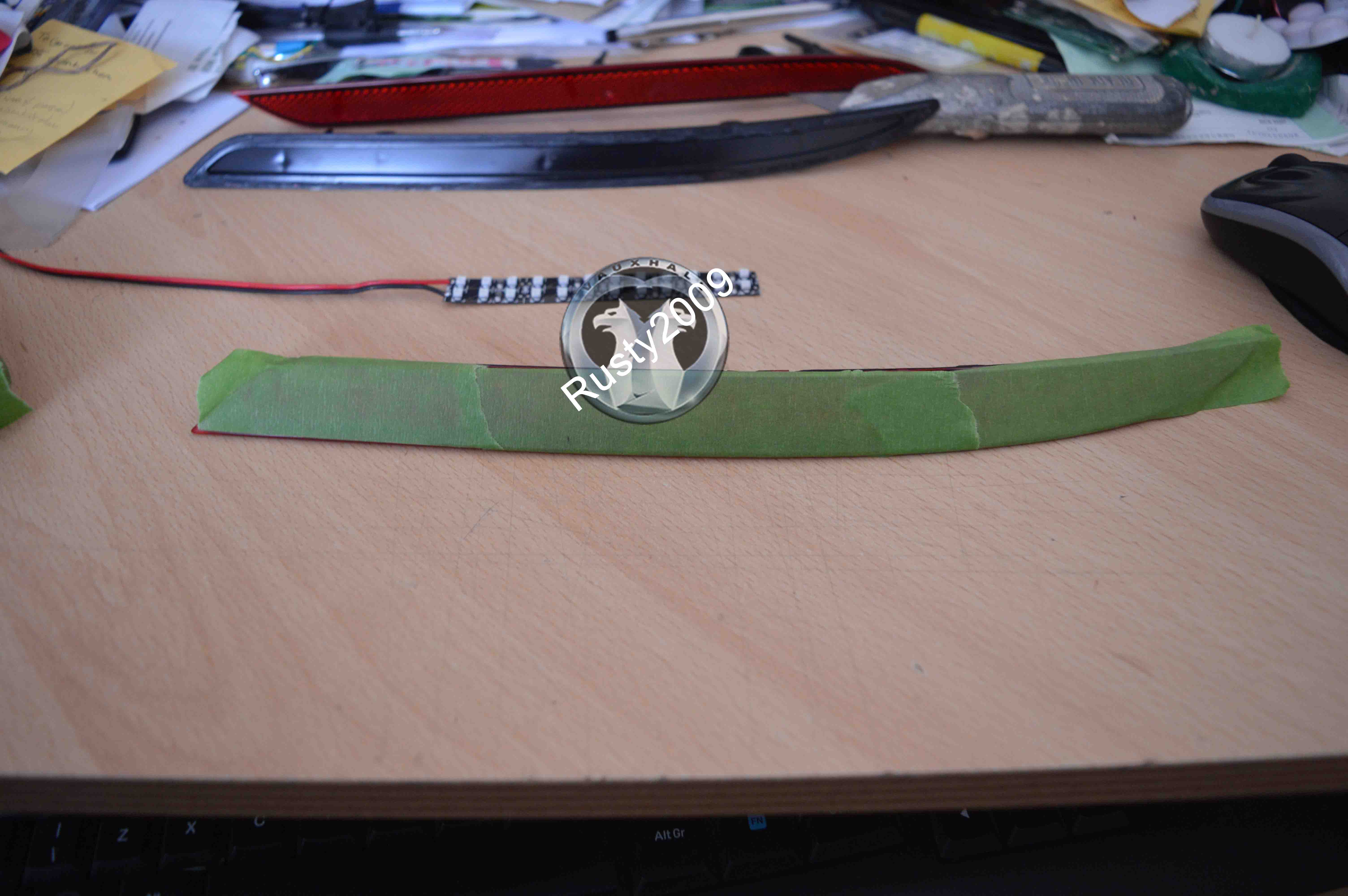

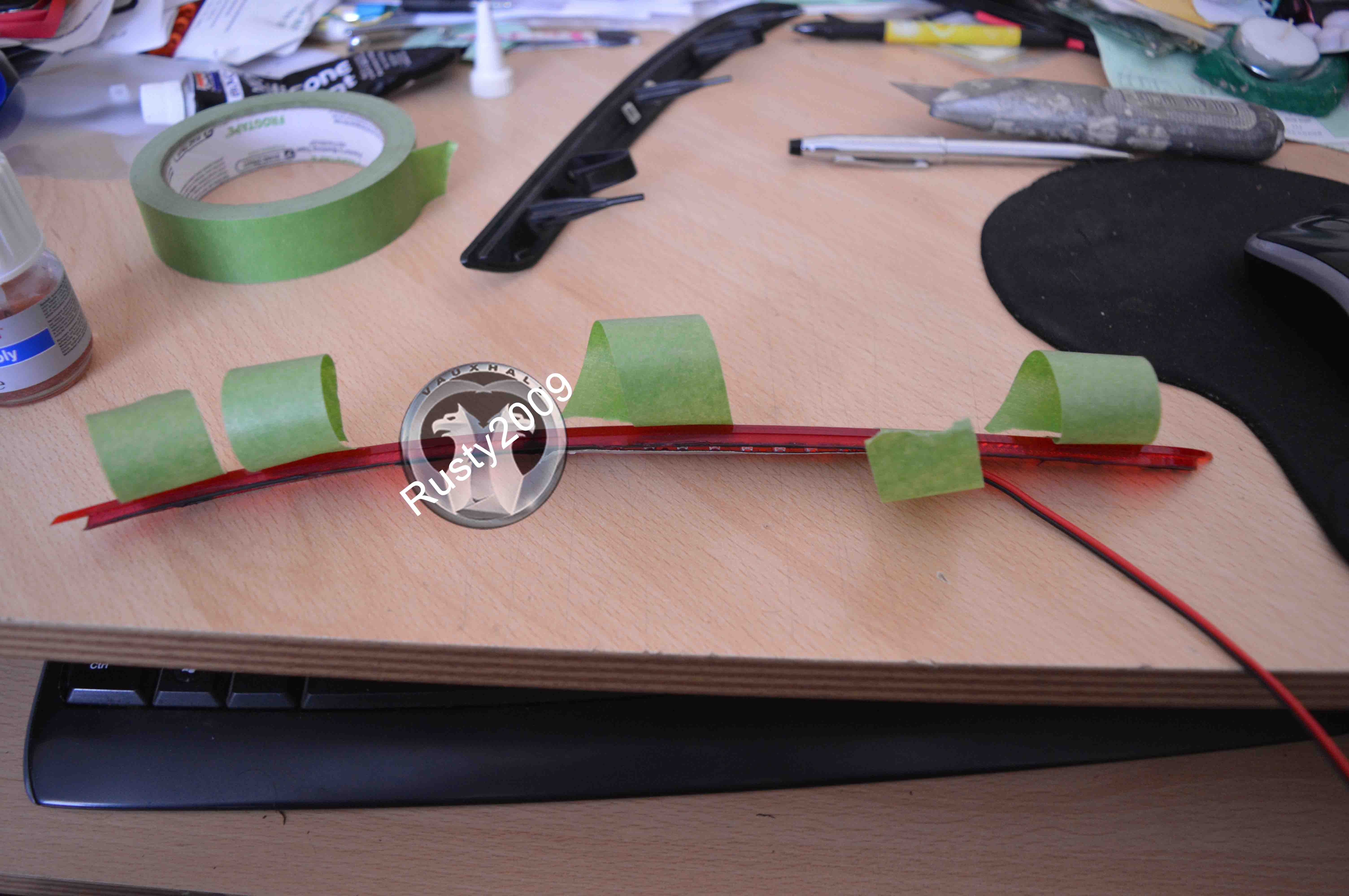

Then mask up the front of the reflector

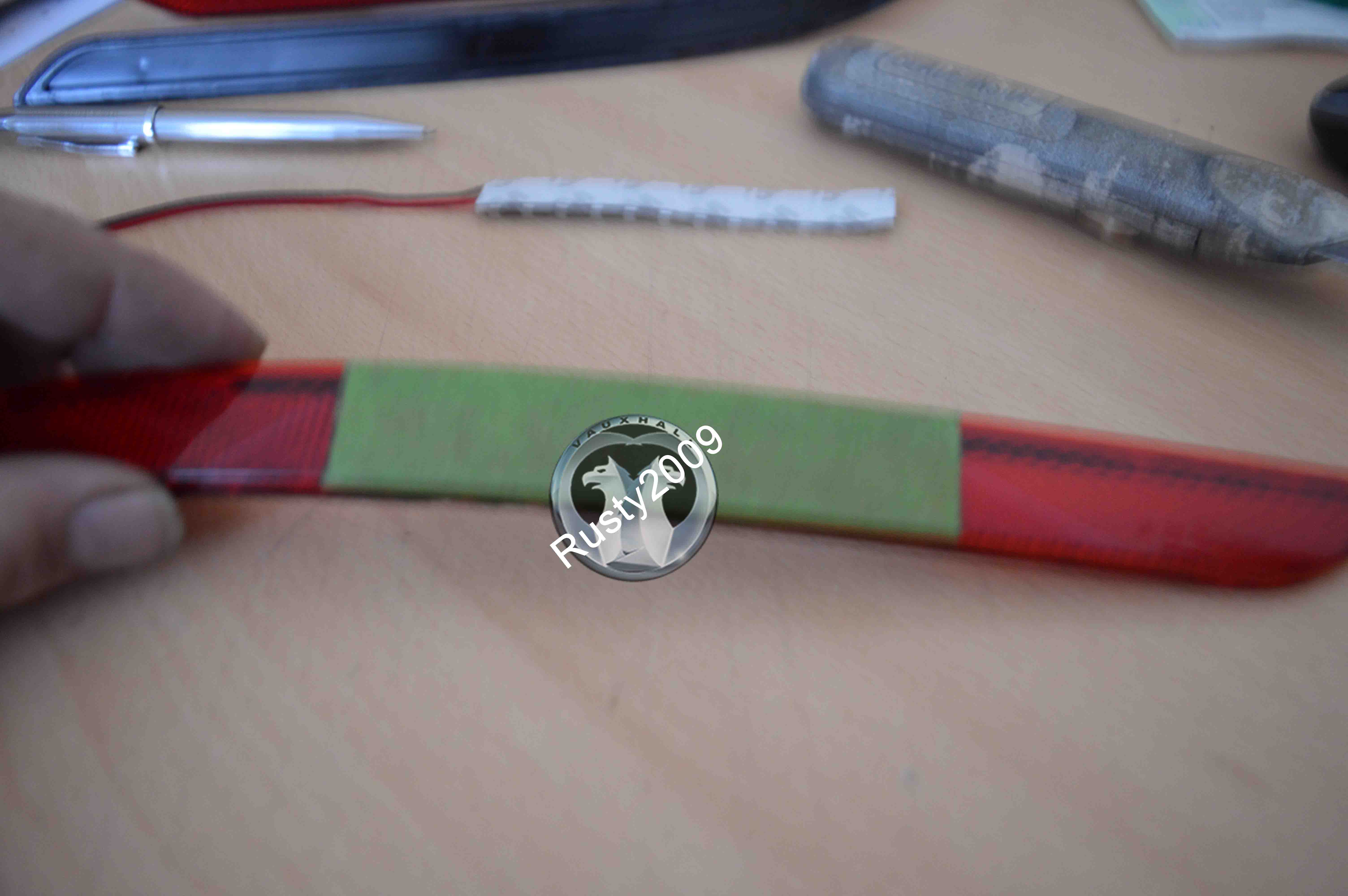

Now place the LED strip into the reflector and into a place you are happy with
Then you need to mark the masking tape at each end, and then carefully score the tape so can remove the ends that are not needed
lay the reflector face down

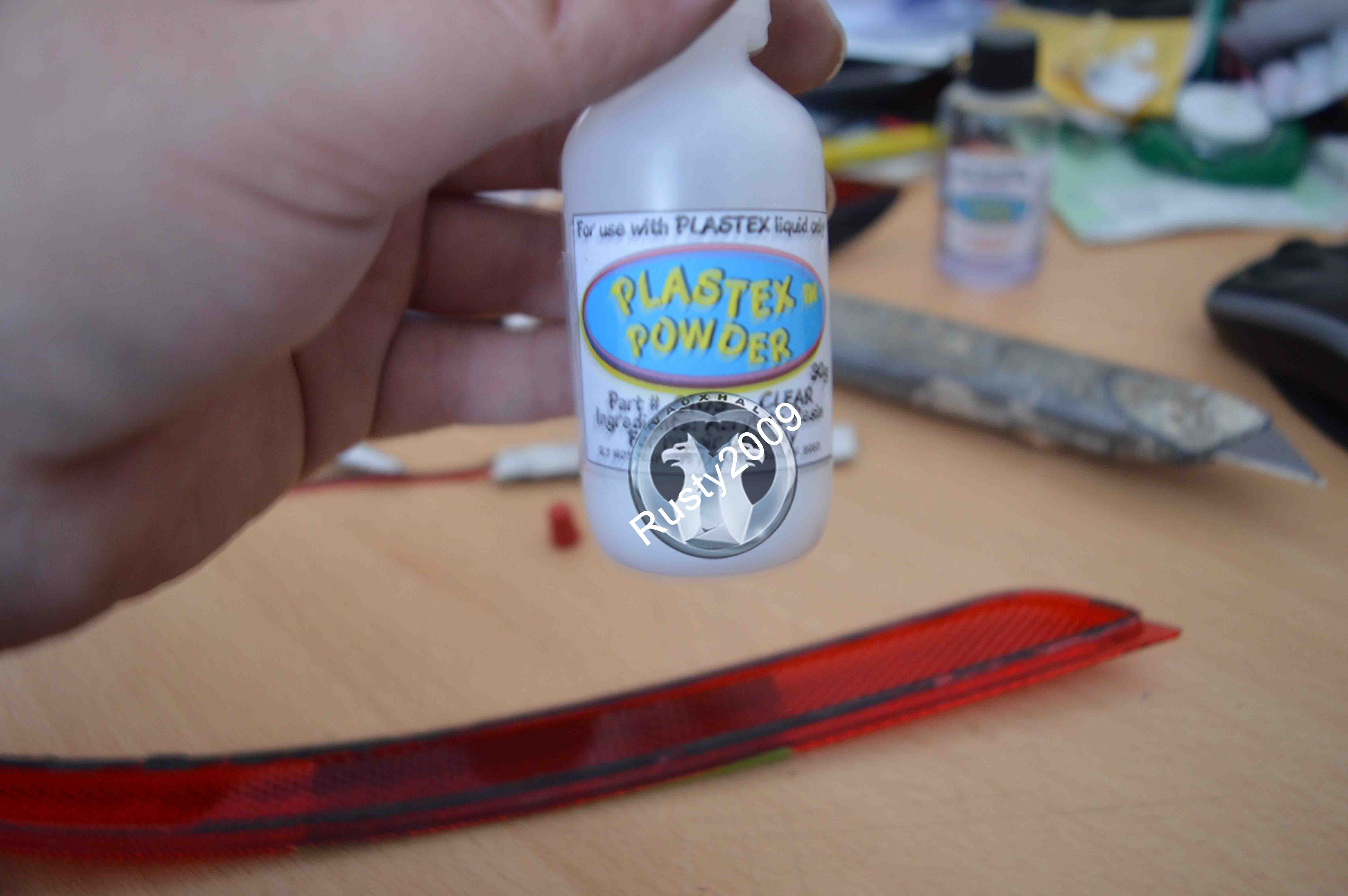

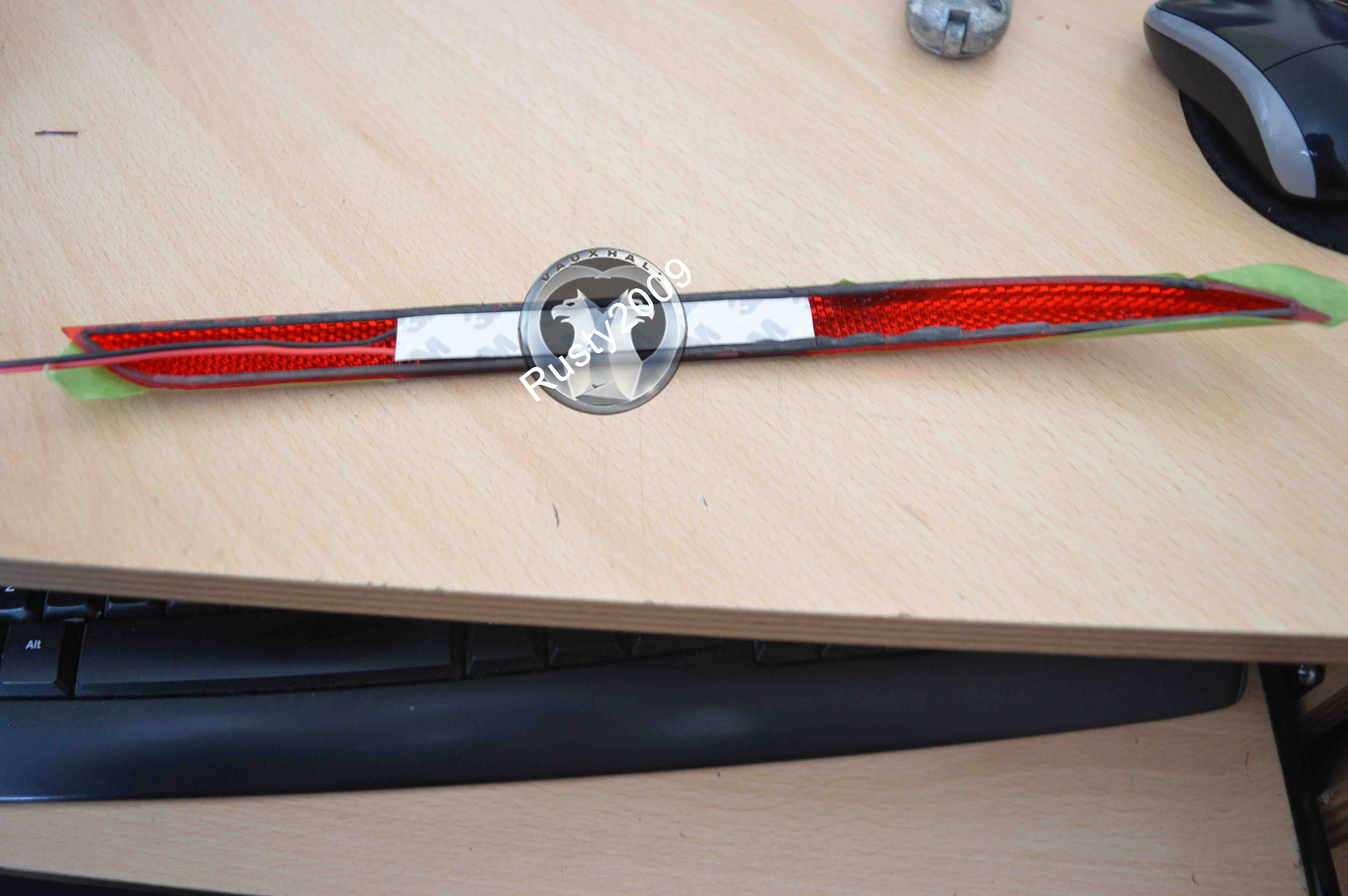

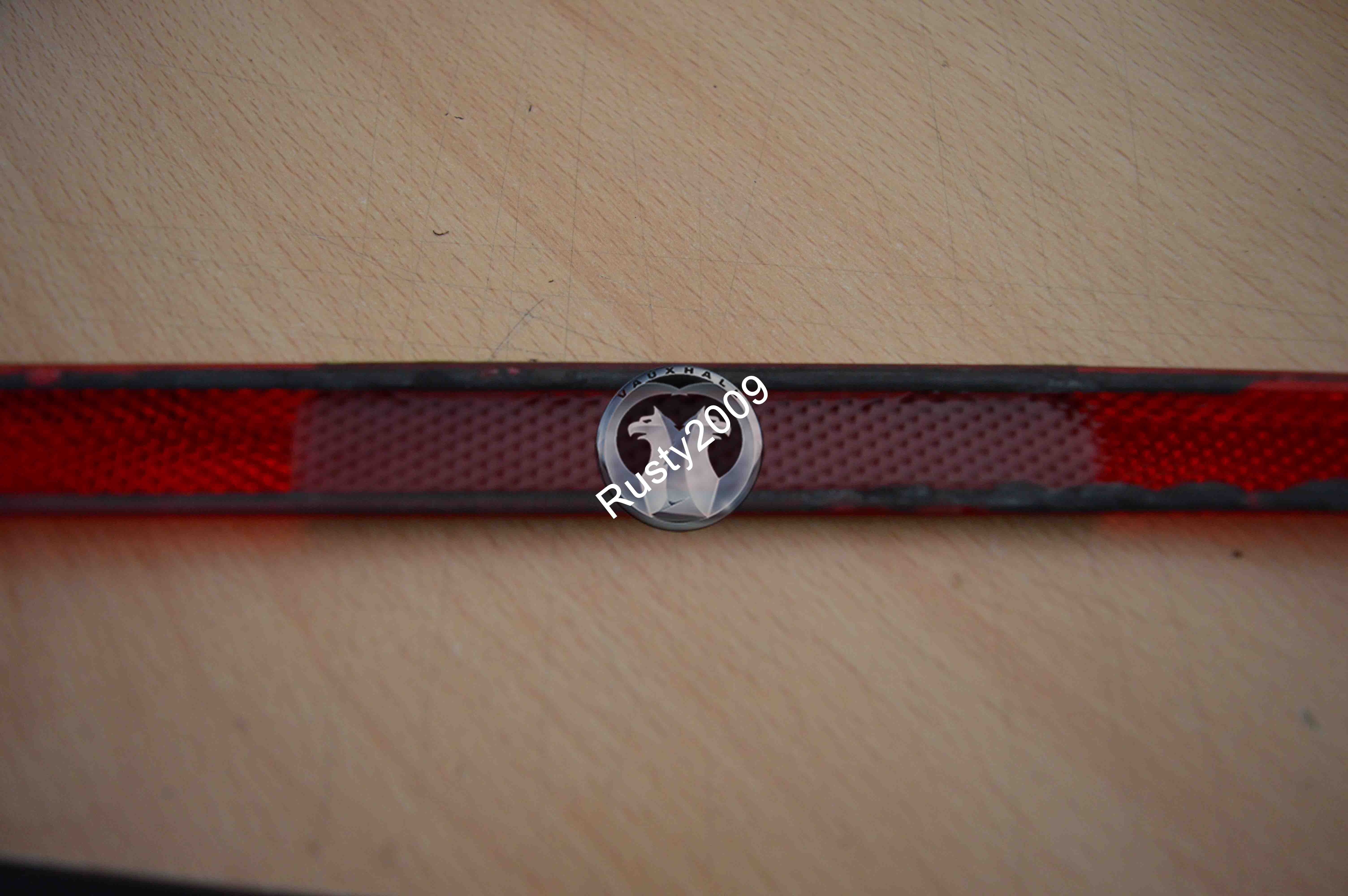

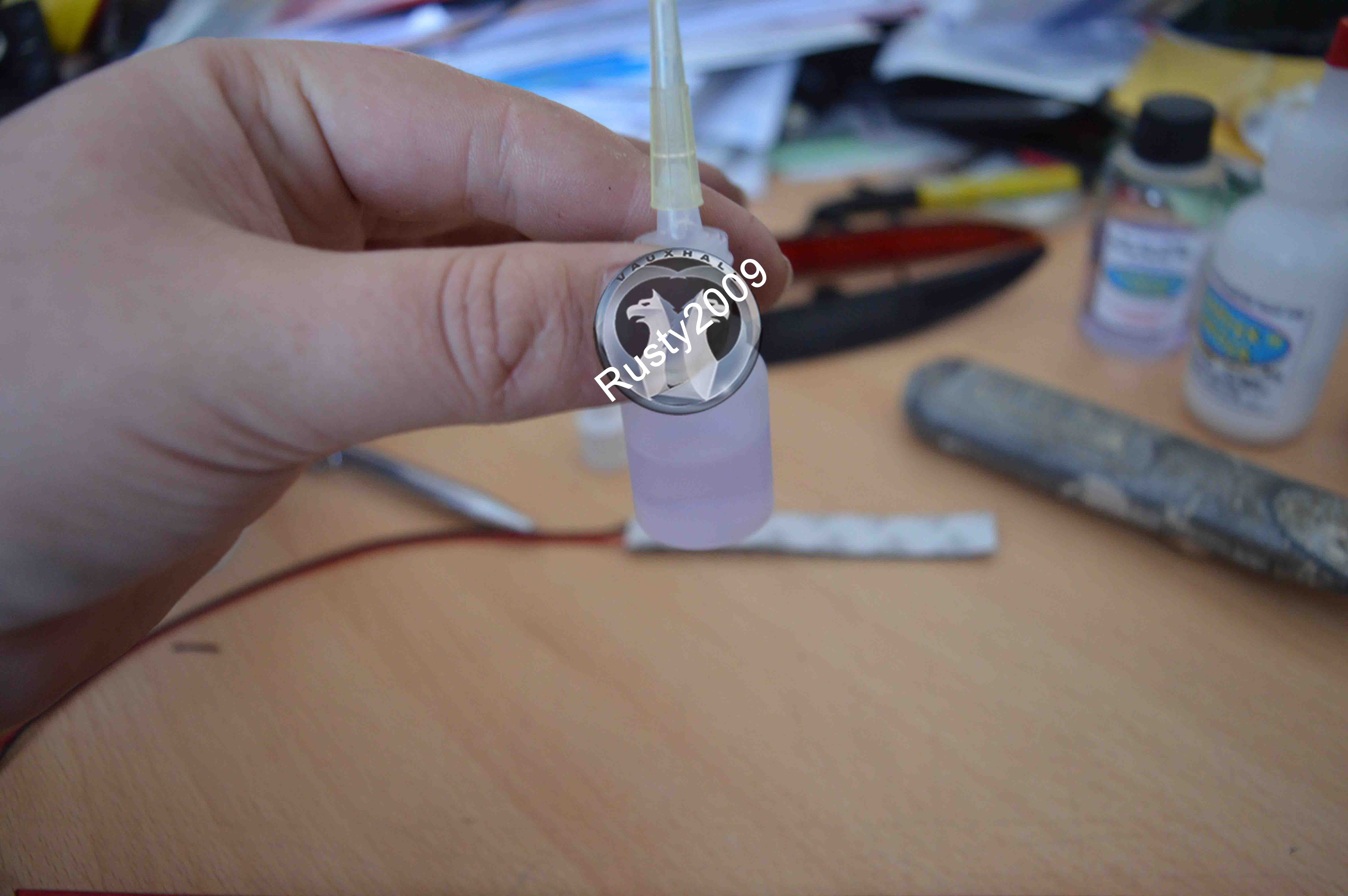

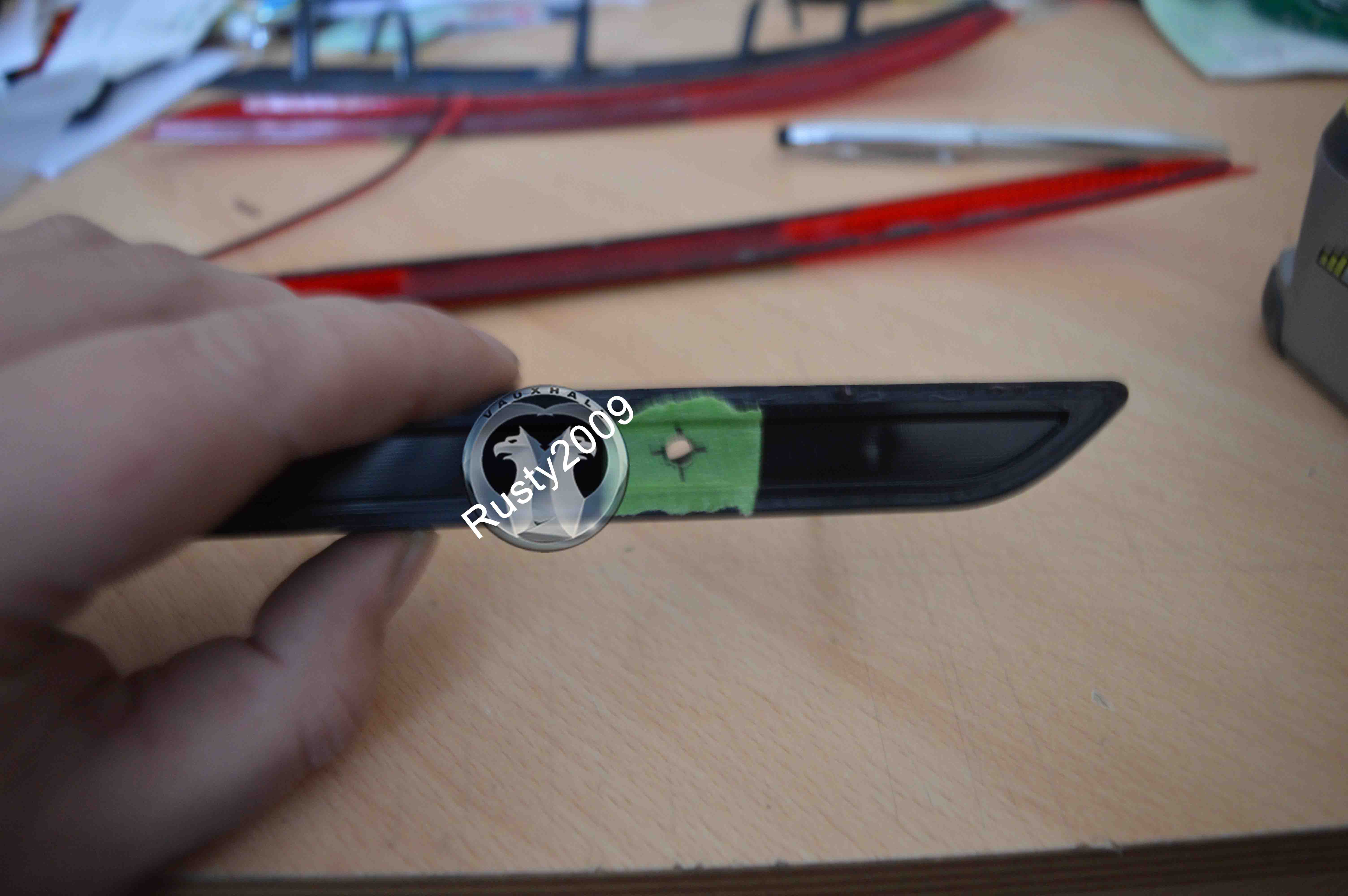

Now you need the Plastex kit.

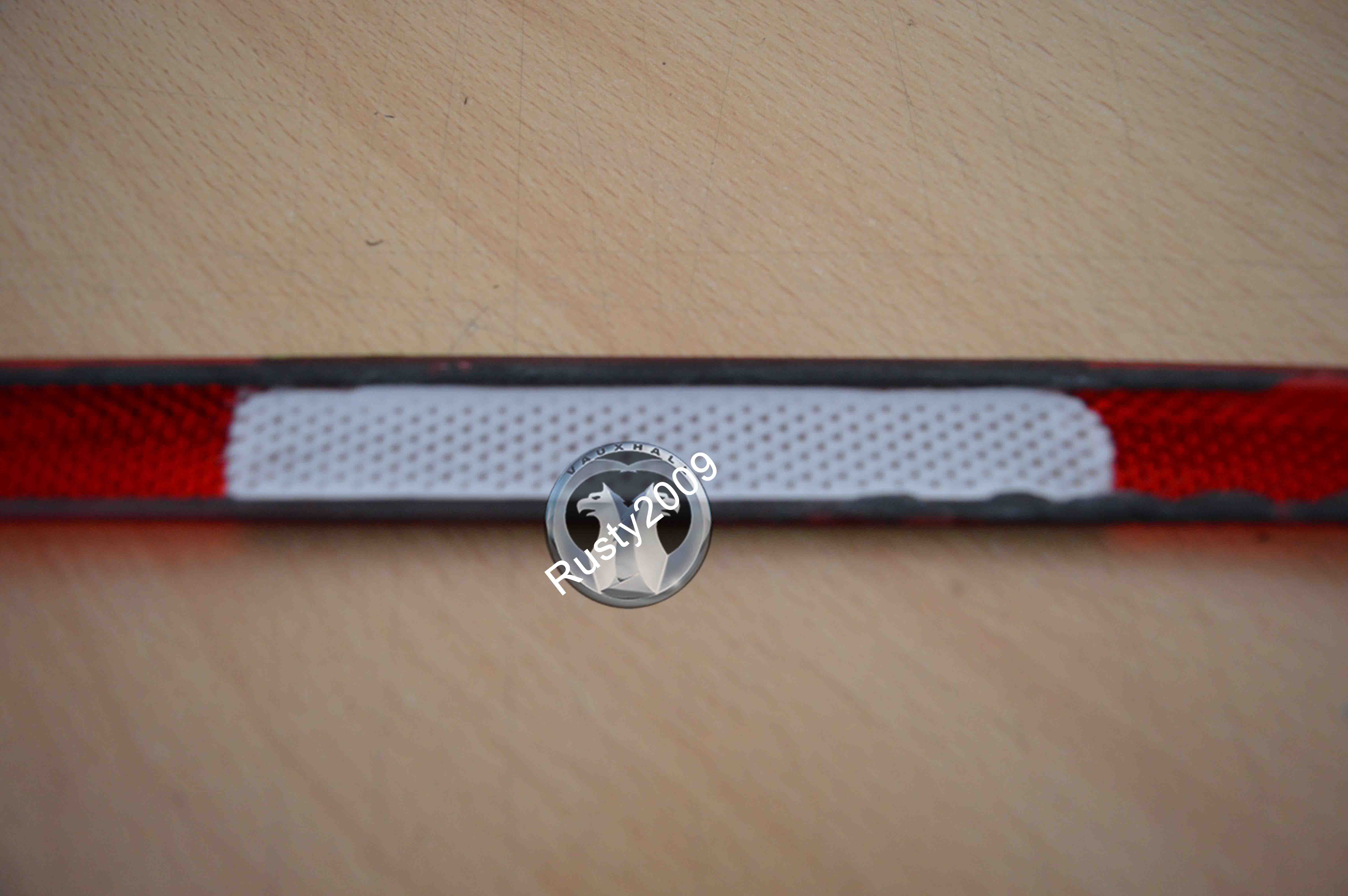

Get the Powder bottle

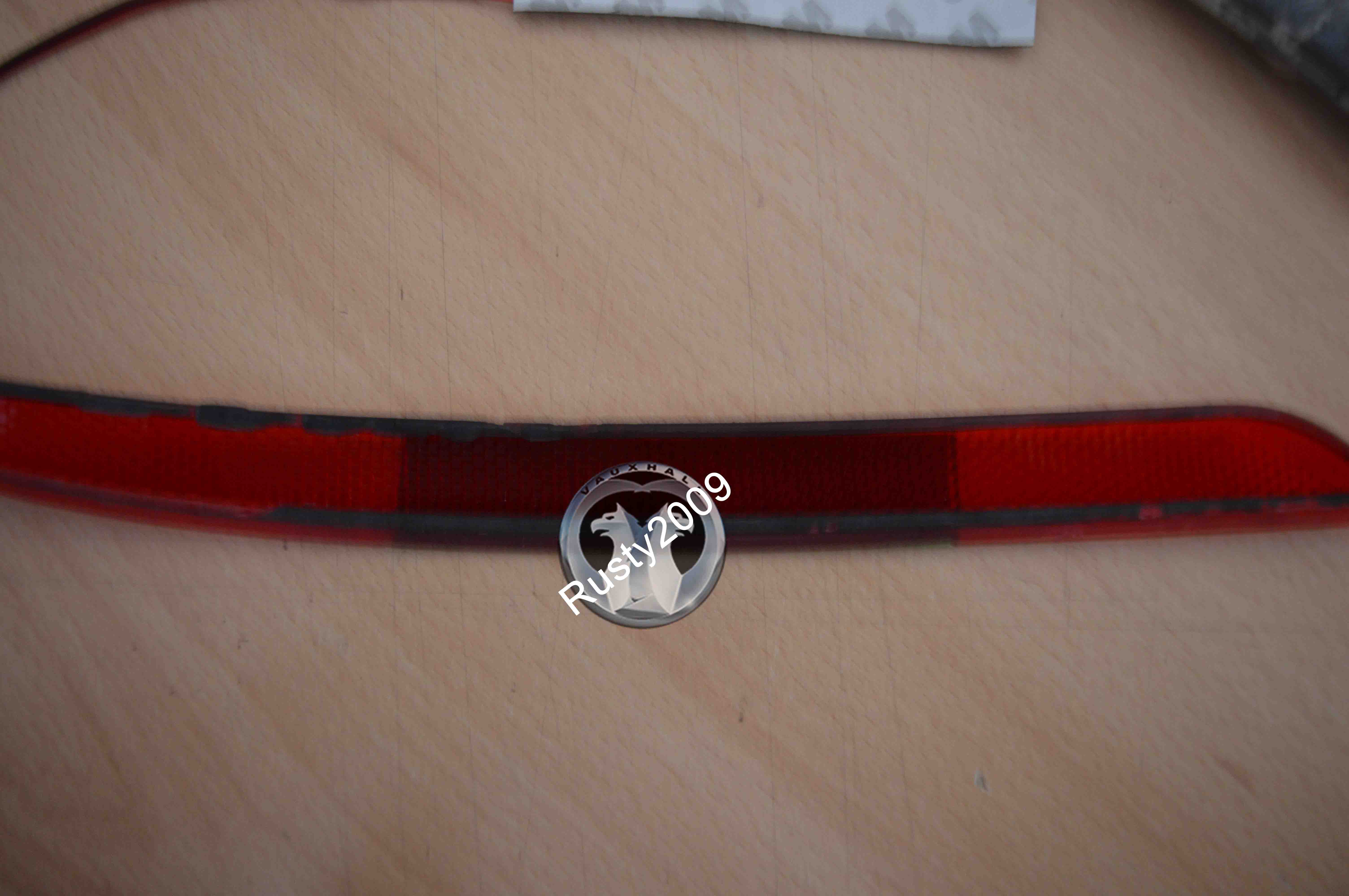

You are going to fill the area where the tape is with the powder you need to make sure it's level.
Then get the bottle of fluid
You need to apply drops of the liquid to the powder
Now set that one side and allow to dry for at least 20 minutes, while it's drying repeat the above steps for your other reflector.

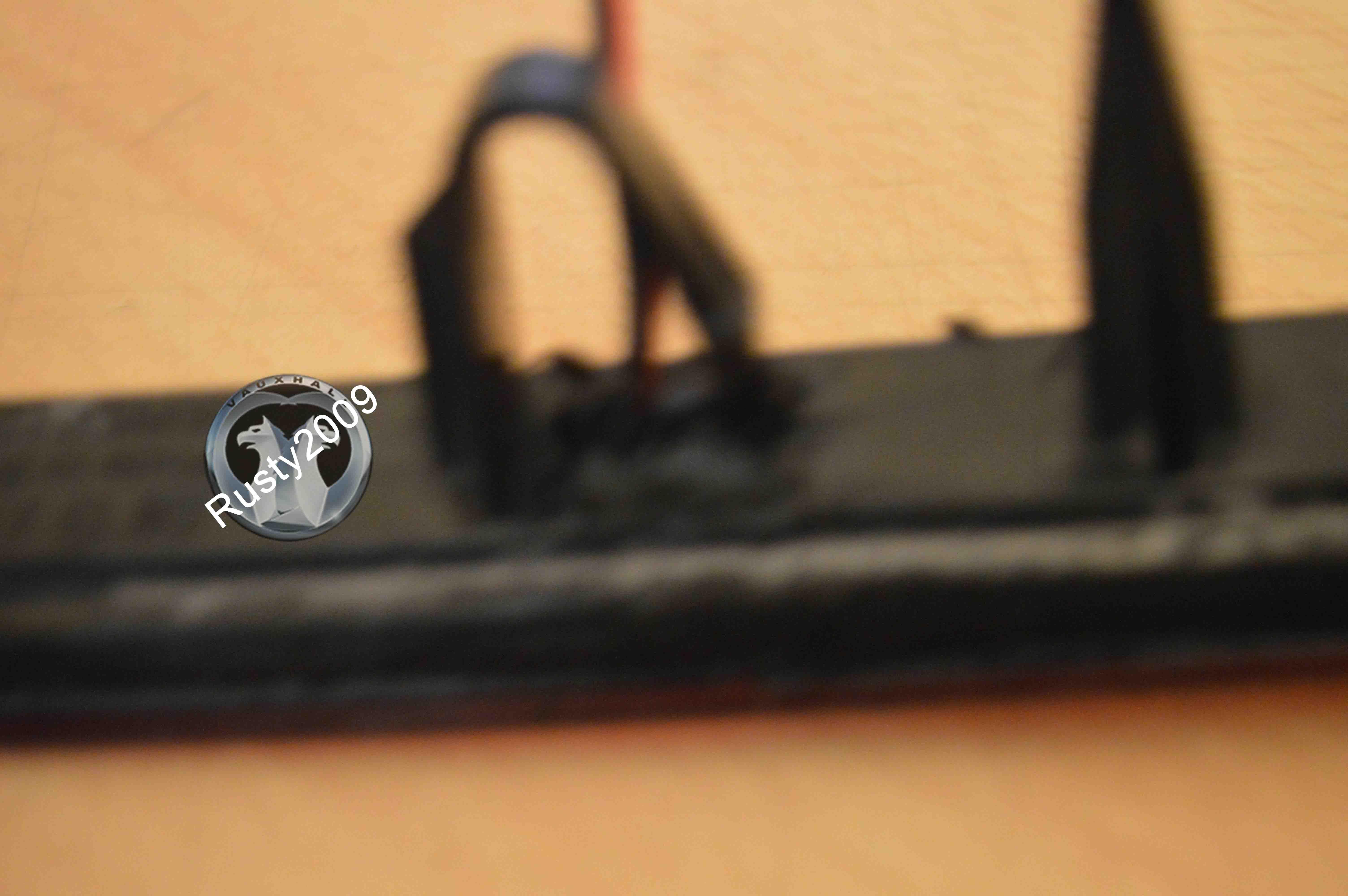

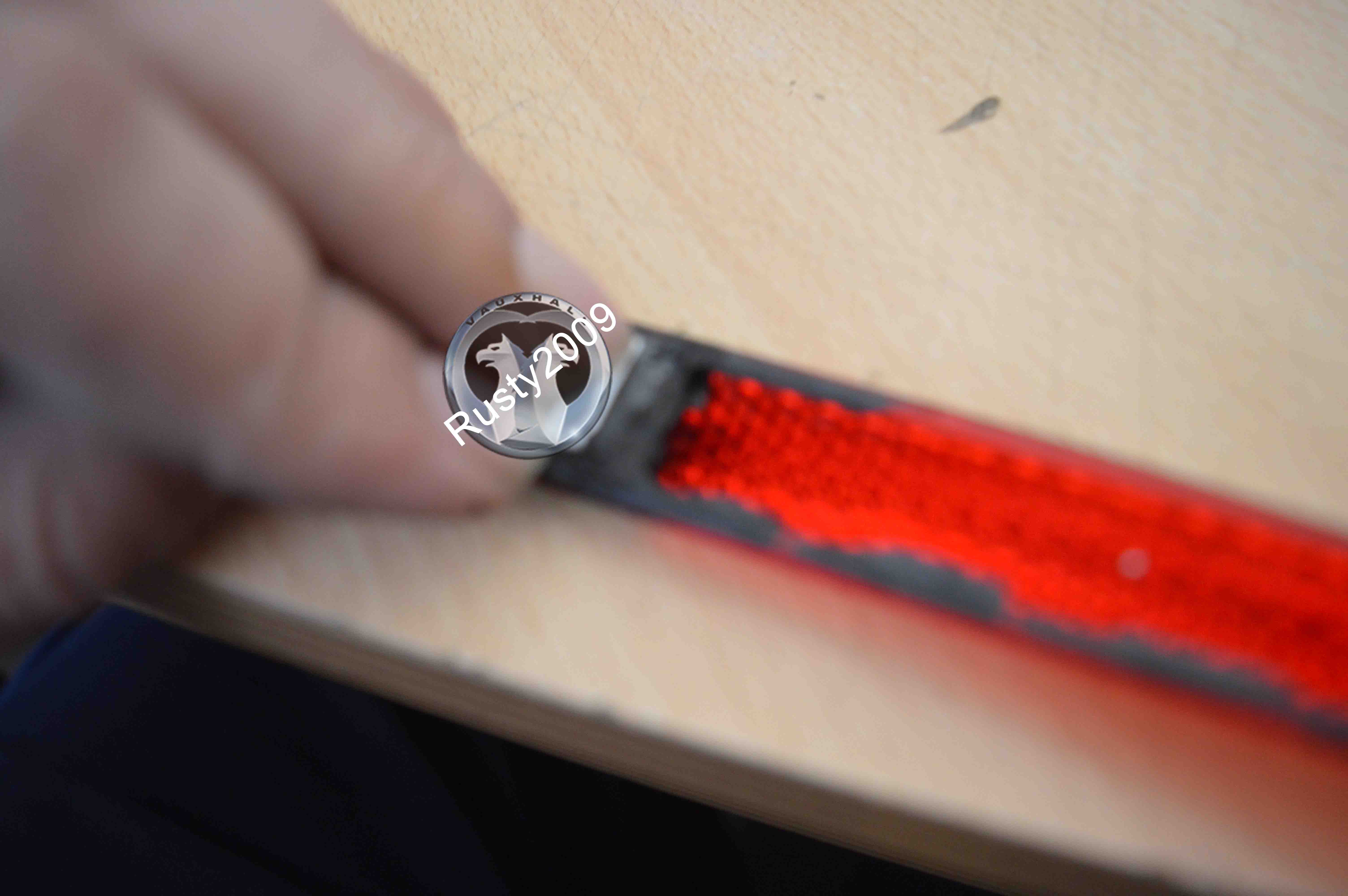

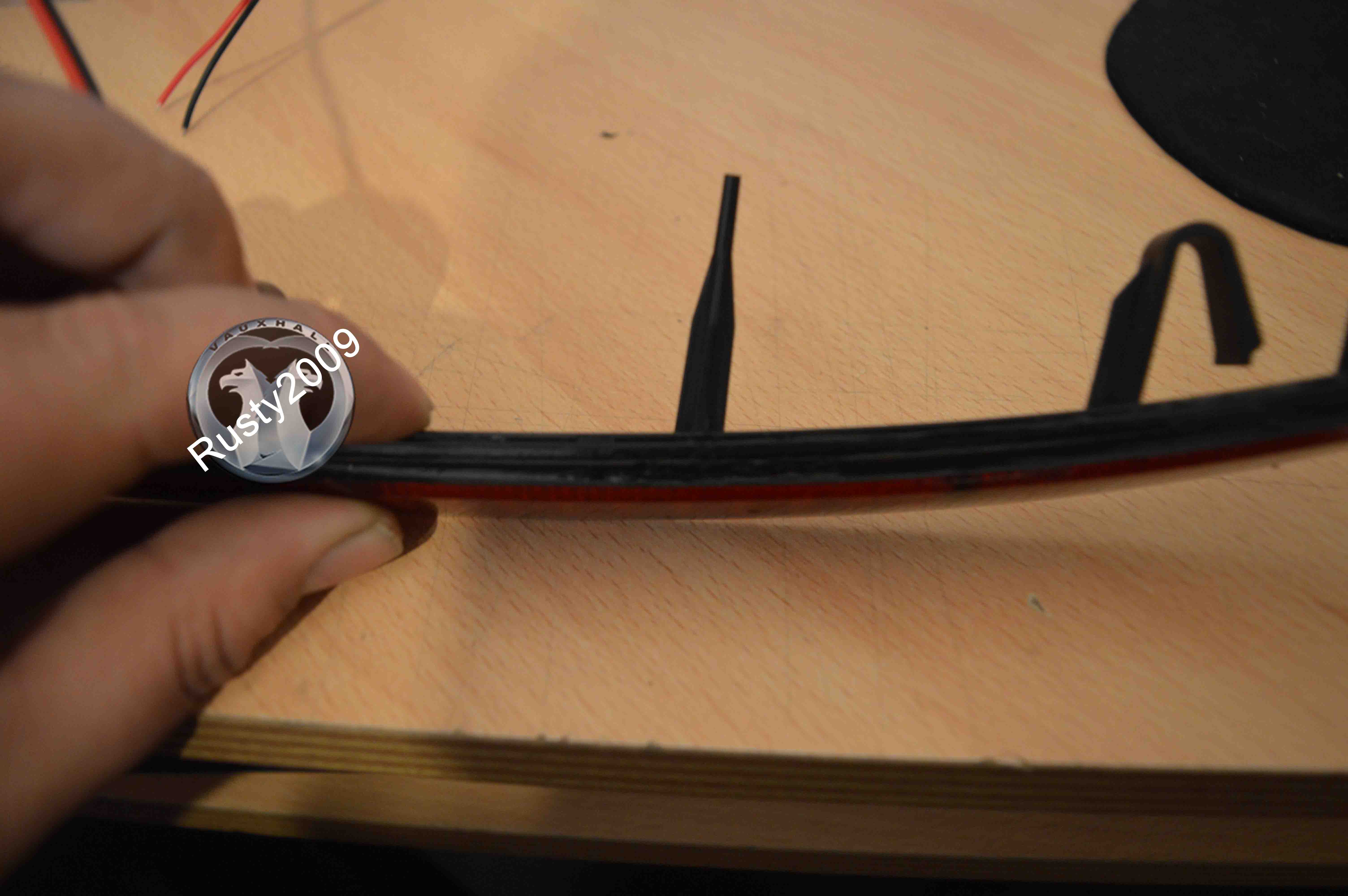

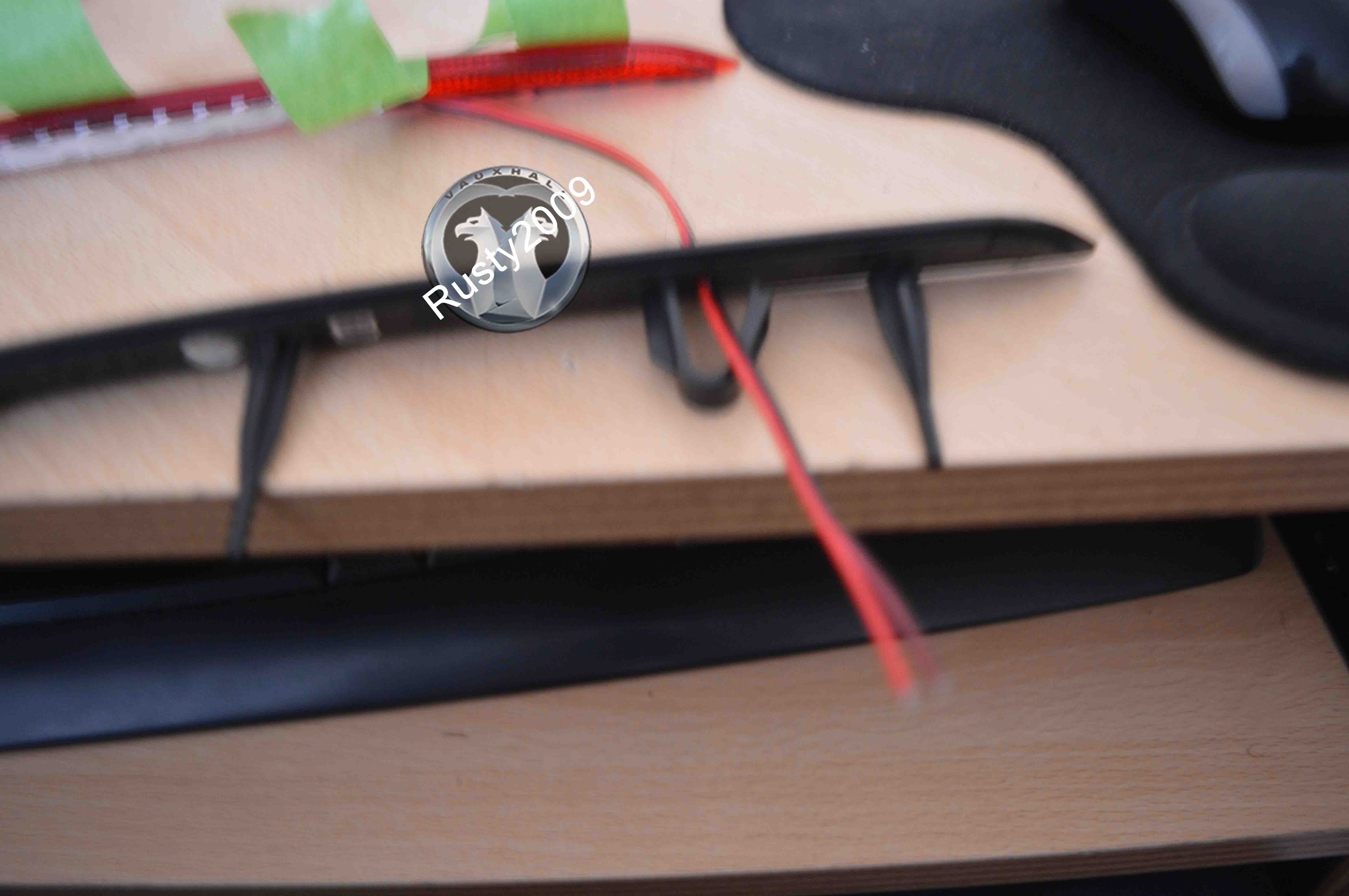

Once you've done that drill a 4mm hole in the back of the reflector housing

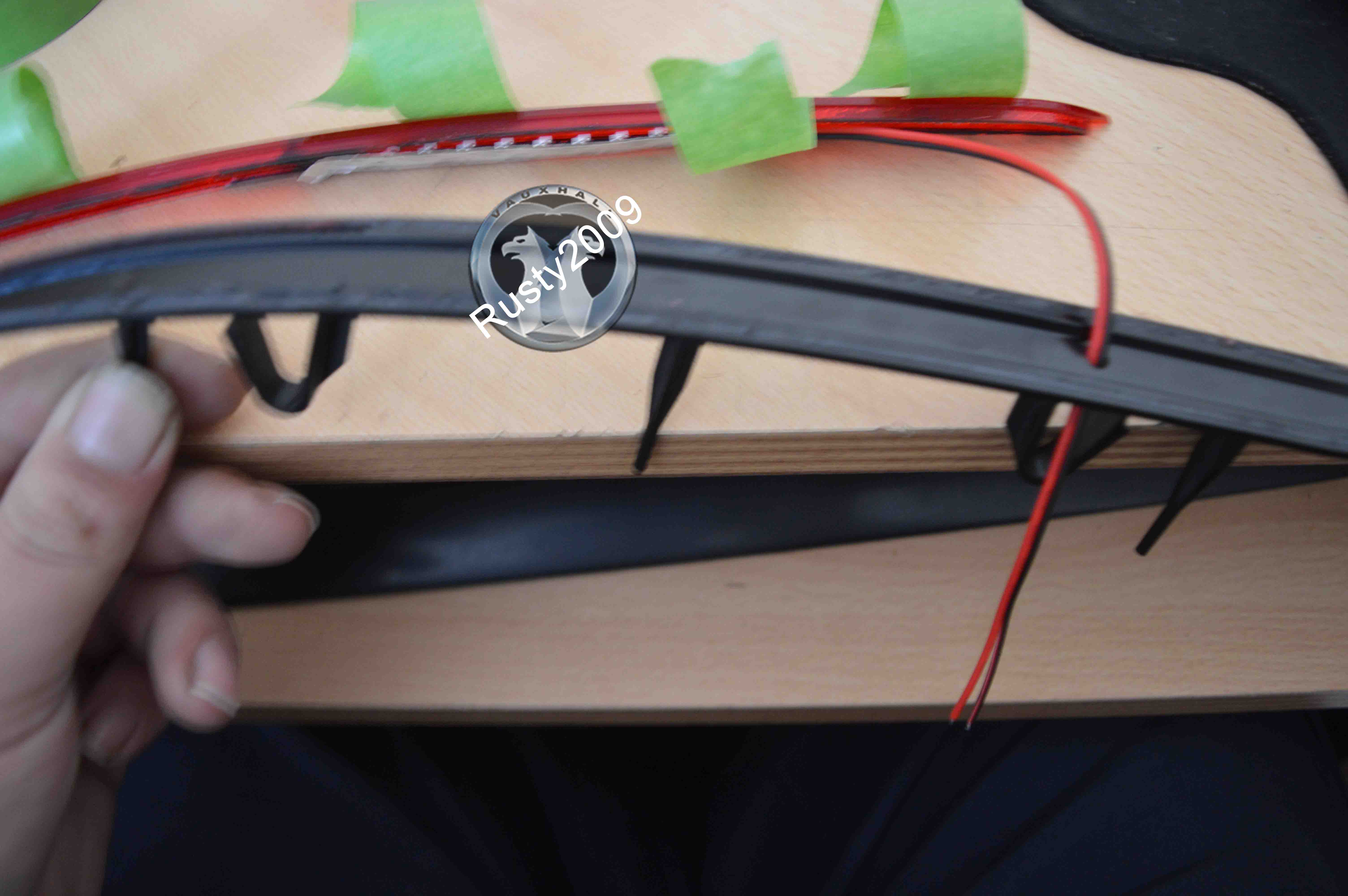

Next job is get the reflector and lay it face down and start to install the LED strip, just pull a little of the backing up at each end.
once you have the LED strip in the right position use a small amount of black sealant to stop the light spreading through the rest of the reflector.
Set aside and allow to dry (It might pay wrap a bit of masking tape around each end of the LED strip so it doesn't move).
Once dry stick some bits of tape on the face and then feed the wire though the hole in the backing.

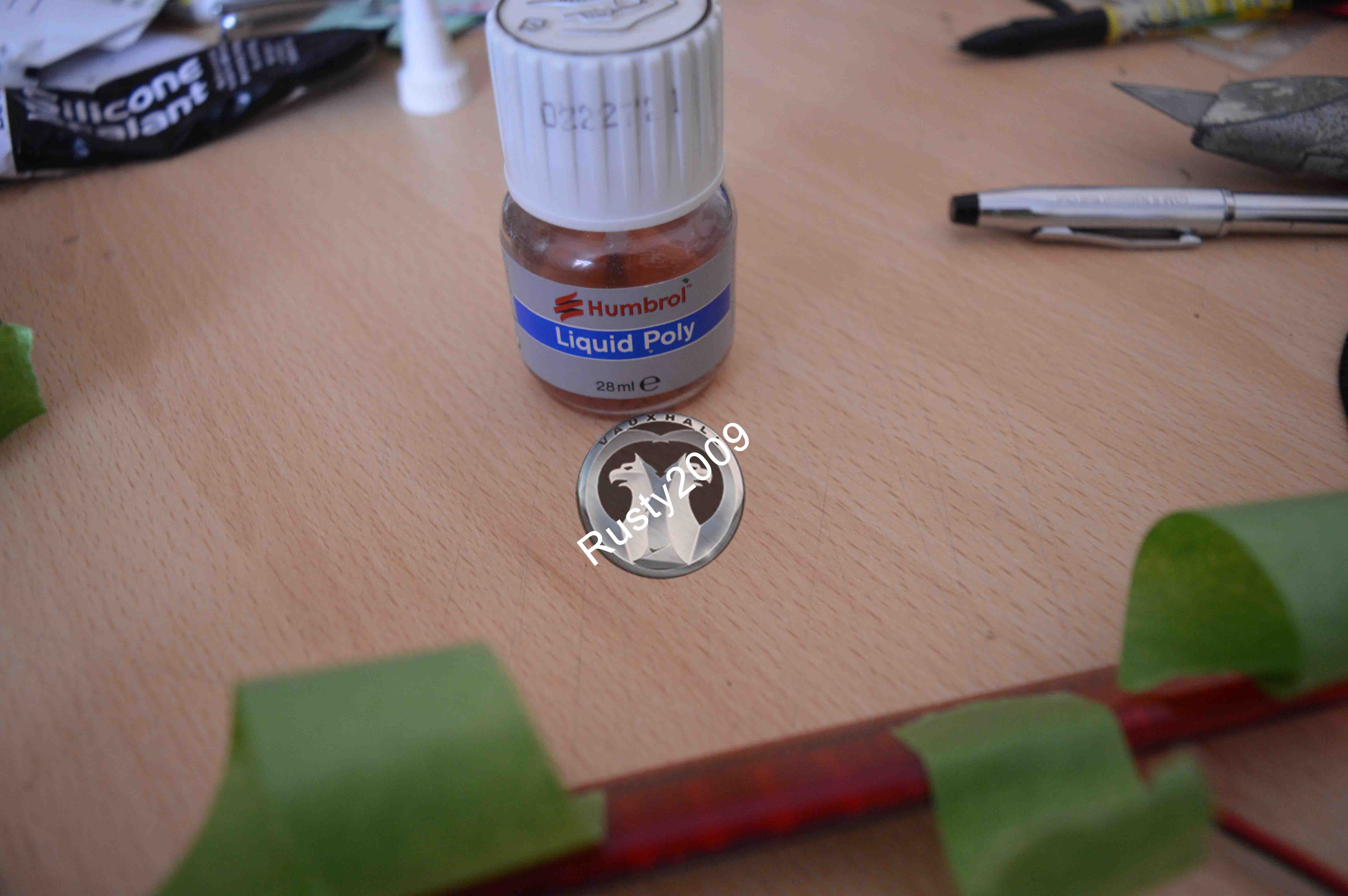

Then using the liquid ploy brush it around both the backing and face (where it joins) you do have to work quickly, then stick them together and wrap the tape around to hold it in place.
Set aside and allow to dry for 30mins or so.

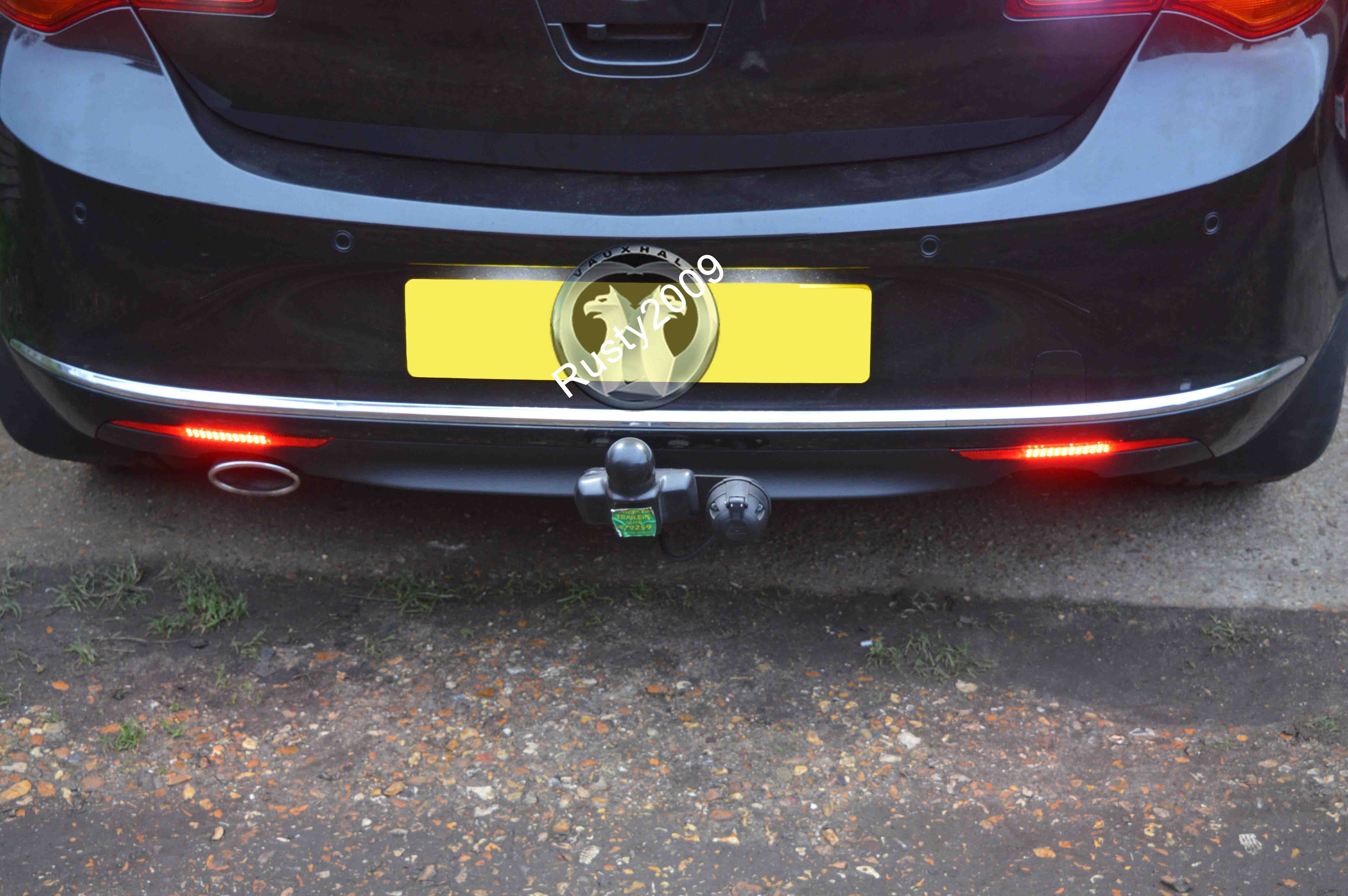

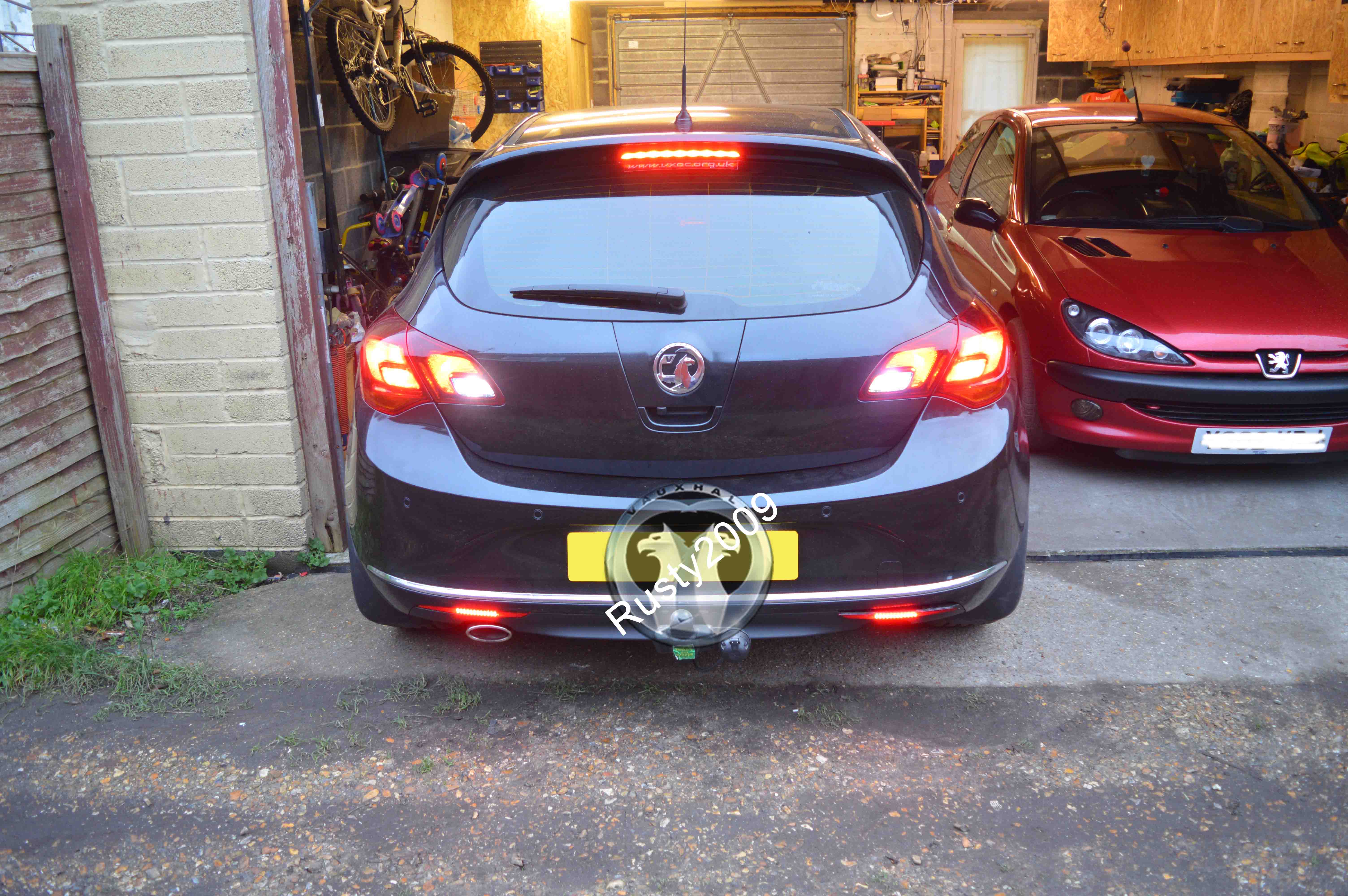

Once that's done run a bead of sealant around the rim and also where the wires are coming out of

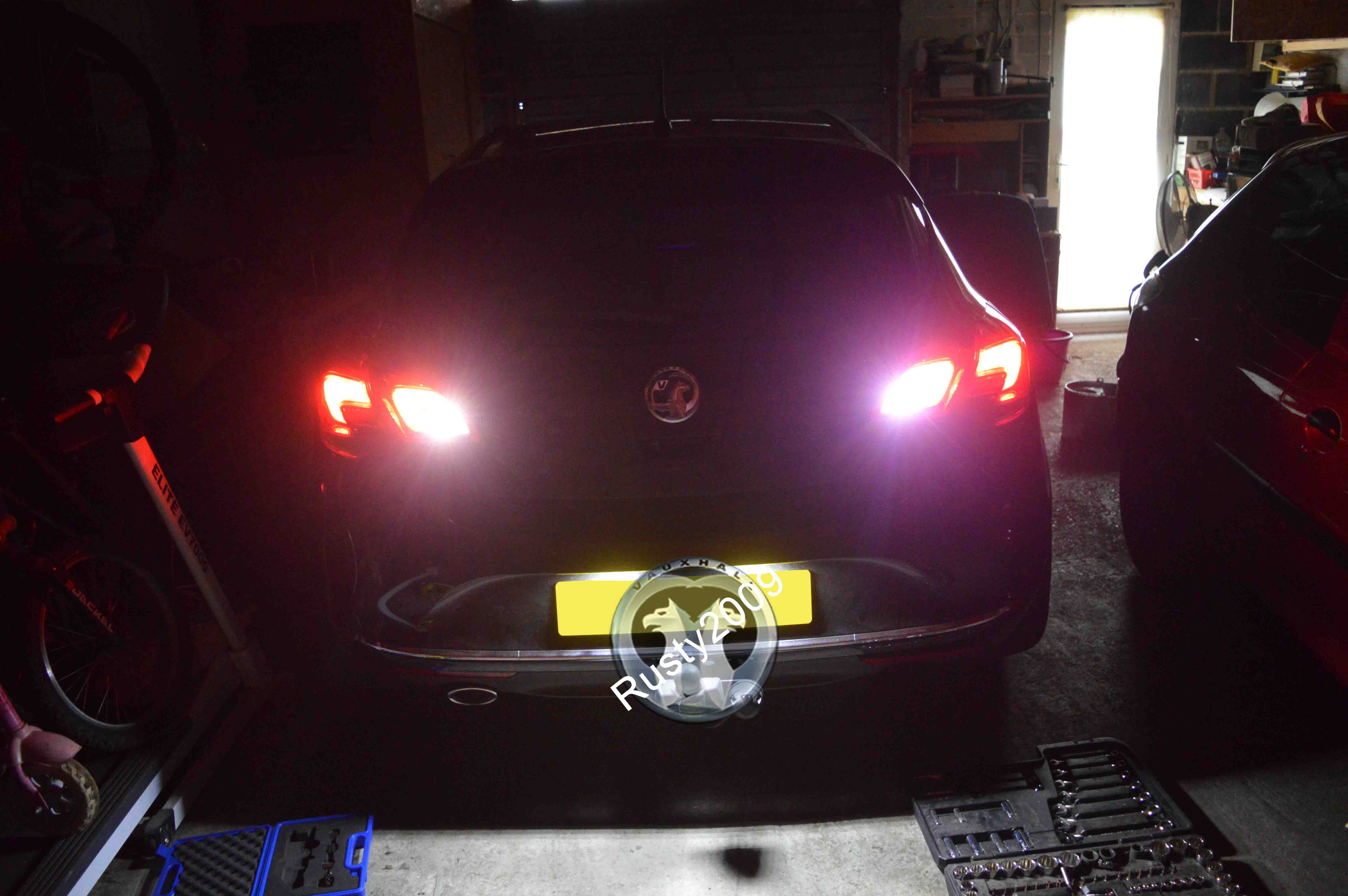

That's it it's up to you how you want to wire them up, I've decided to use these as rear fog lights and add an extra reversing light.

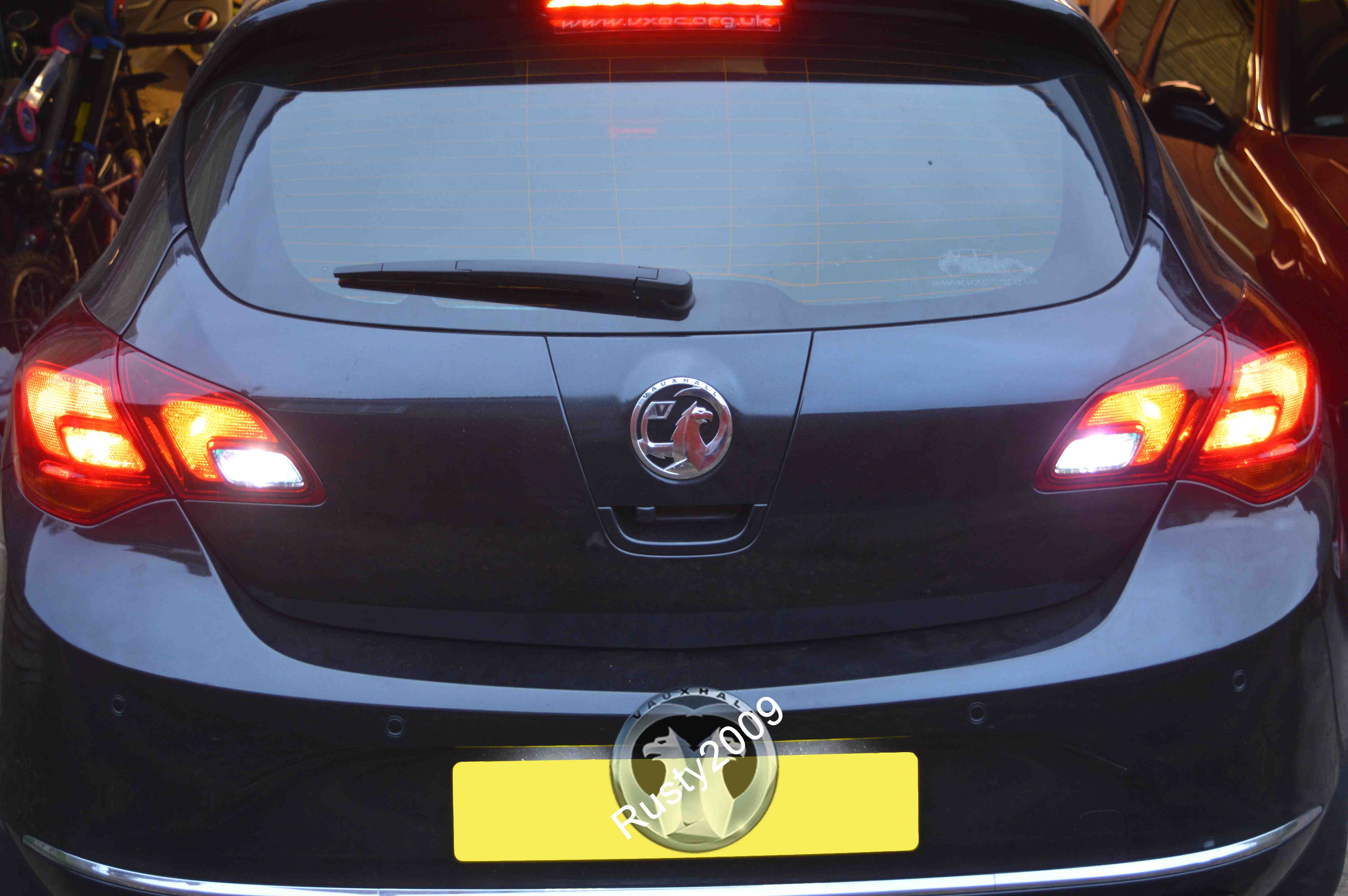

Been for a drive and had the wife follow me, she said they are bright and stand out really well, still yet to test the extra reverse light out but will in alley at home where it's really dark

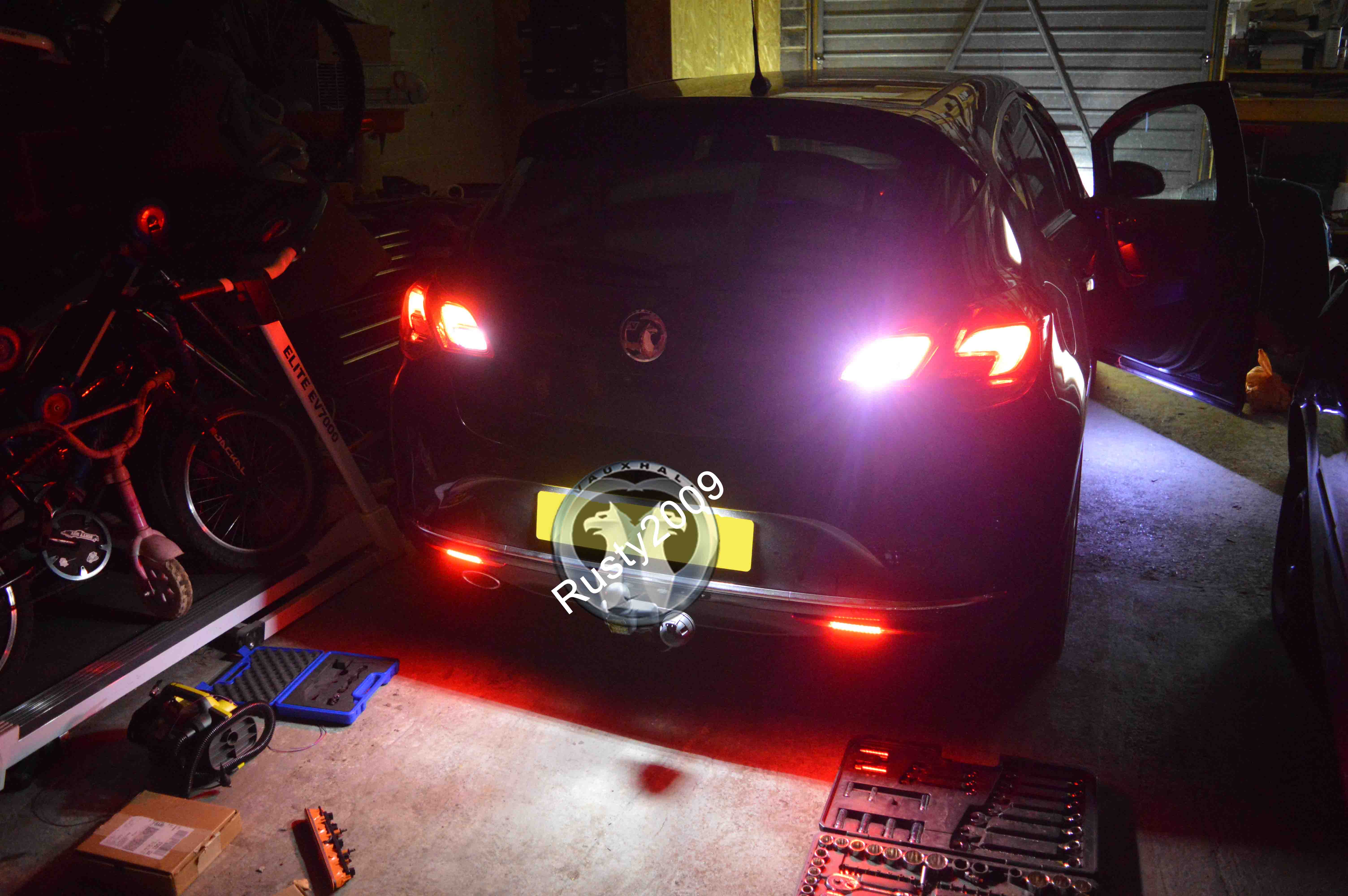

I got a LHD tail lamp so it had the reverse light.
I than tapped into the reverse light wire and ran it to RH side.
I de-pinned the fog light and joined that wire to the new wire I ran from the reflectors.

Hey! Looking good. Am I able to splice these into the number plate wiring? Only want them as running lights/ when I open the boot.
There are two wires going into the number plate. Anyone know which Is earth and positive? Cheers. (Black and yellow wire)

(14:th-Jul-2020, 15:28:30)Mark1197 Wrote: Hey! Looking good. Am I able to splice these into the number plate wiring? Only want them as running lights/ when I open the boot.
You can splice into anything you want, brake lights fog lights number-plate lights.
