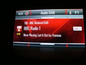

So here are my new v200 nav900 themes with the correct poi icons
and pop up speed cam image and the gray and red carbon themes
with the insignia startup animation and insignia standby logo
the night map has the starry night sky also.
Also i have installed 2015/2016 nav900 SD card
the voice recognition does work for the maps, Usb, Dab, etc
i also added two missing wires to get the nav to hear me
but as it stands the nav talks to me but i still can not talk to it
i am working on this problem still
the bluetooth mobile still works fine.

I'm currently testing new night skys on my themes, i have got the speed camera icon working on the map and also different petrol station icon.

thank you for the great guide. upgrade my navi 600 to 900 and everything went as normal.
now i woud like to put this red theme with insignia start up animation as you @tucpal done, is possible that you still have these files arround

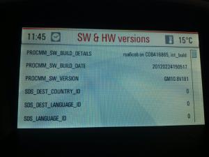

Hello, I have 2 questions about making a new theme by myself:
1. Is there a way to change the size of font in the navi?
2. Does anyone have a template to make my own theme? so I can see where particular images are placed etc.
Greetings

#76
Can someone tell me which  theme I can use for my car ? (you can give me a link )
 (somewhere I read that exist v181 ,v200, v208 and you should not mix )
I am not sure which  version is  mine ( I think it's v181 ) and which one I can use now
I don't want to damage something .Do I need to change FW or something else ?
This is photo from my car..
( I would like some theme like this...
#77
You would be best going with V208 when they say don't mix them they mean you can't take files from V181 and add them into V208.
#78
(13:th-Nov-2019, 09:44:27)Rusty2009 Wrote: You would be best going with V208 when they say don't mix them they mean you can't take files from V181 and add them into V208.
oh, I see   .Thank you very much !
Just one more question...what i need to do now to update from v181  in v208 or v200? (some links or something ,please.. )
#79

#80
Before doing anything stupid and bricking navi in process I think it is best I ask here.
I have stock navi900 with v181, can I take any theme and transfer it to USB and it will work?
(eg any v208 theme will work on my fw as long as I don't mix files?)
I really like how everything works atm but that blue "night" theme is killing me during night driving and I would like to do a change to carbon/red on this theme.
Also, POI/camera notifications work for me and I would like to keep it same as before.

It's been that long since I did any Navi theme stuff it's hard to remember exactly but it should all be in this thread.
I know on the Navi 900 you can skip the cd part and just use the USB.
#83
They can be just popped in v208 update files, swapping .uli from any other theme should work. It has been working for me.
Left day default and added carbon/red night
