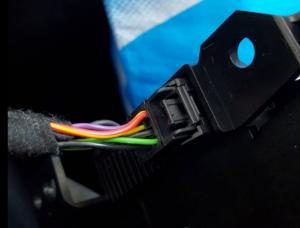

13:th-May-2016, 11:01:31
(22:nd-Mar-2014, 20:44:10)tucpal Wrote: Hi Tucpal, I saw that you replaced the CD400 unit whit a CD500 unit. I had a question regarding the wiring and thought you might know it. I'm trying to upgrade my CD500 unit whit a Android device what is nornmally compatible whit a CD400 unit. In your pictures I saw that you replace the console of CD400 whit a CD500 console. My problem is that my Android radio wont power up the middle console so I believe that it must be wiring to that console what doesn't power up see pic. So I thought you might know the diffrence in the wiring of the console of a CD400 unit comparing whit a CD500 unit. It should be working if the correct wires are connected I believe.
ok so was the aftermarket unit your purchase for a sd 500
as yes there are differences in the wiring for the front display console and other wiring will need changing also so i would think yes the wiring may need to be turned back to the cd400 set up now a trip to rusty may be more helpful to you as pins etc are required but really you should have got an aftermarket unit specifically to replace the nav500 not the cd400 rusty is your best bet here for help
An aftermarket radio will not power the factory radio controls as they are wake up via wake up wire.
All inputs are then sent via one wire to the radio BCM etc. Sent from my iPhone using Tapatalk Astra-J 2.0 CDTI S/S

I'm guessing by you pictures you using a china unit that looks factory fitted?
They way a navi unit is wired compared to a 400 is alot of wiring changes it's not just 1 one wire. I'll dig the pin out out for you later. Astra-J 2.0 CDTI S/S

Here's the cd400/navi control pinout. the CD400 is (UAG).
23:rd-Jul-2016, 22:28:26
(23:rd-Jul-2016, 07:14:30)Rusty2009 Wrote: Here's the cd400/navi control pinout. the CD400 is (UAG). Thank you Rusty now I have to see were the pin connector 2 goes to the ISO connector. I believe that on a CD500 model the ISO pin number is also different. Now I know that nr 2 needs to go to my CANBUS and need to find out were it goes on my ISO. You might have that info for me also and really thank you so far almost getting there :-).

there are a fair few wires that will need changing over and there is no guarantee that will work
as vci mdi is also needed to make them work if it is not compatible with the cd500 then you would be best to send it back
15:th-Jan-2017, 23:24:14
Tucpal it is a case of swapping the wires over and getting a cd400 radio panel.
I am thinking of making a looms up and selling them for those that want to use a and aftermarket unit. Sent from my iPhone using Tapatalk Astra-J 2.0 CDTI S/S

this is the problem with the insignia if you also have the armrest controller on the nav 500 already
then you would be disabling it also by adding the cd400 controls as the cd400 in the insignia never had armrest controls it can be retro fitted though this will give you an idaea how to do it https://www.youtube.com/watch?v=60lx_Nec_yI rusty may be able to work it out by the youtube clip or you could ask on insignia es forum they may help

Your issue is you are going to a unit that is built to work from a CD400 unit set-up.
You will not be able to make the cd500 controls work with a cd400 setup the same way you wouldn't be able to make cd400 controls work with a cd500 setup. CD400 control panel only has 3 pins on it Power, Ground and Network Bus. CD500 control panel has 7 pins on it Power, Ground, Wake-up, Reset, Data High, Data Low and Data Shield. The screen is also wired different cd400 screen has 8 wires Power, Ground, Network Bus, Wake-up, Reset, Data High, Data Low & Data Shield. Cd500 screen only has 4 Power, Ground, Dimming & Remote Enable. Astra-J 2.0 CDTI S/S

That's correct CD500 panel will not work with any aftermarket unit.
Yes once the wiring changes have been made, no it will not be possible to make the armrest control panel work with a cd400 panel. No its not possible to run both systems, the aftermarket unit would run FM anyway. Astra-J 2.0 CDTI S/S
