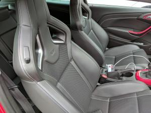

Well we did it!
Well Baz expertly did 95% of it whilst I removed a couple of screws and passed him the tools. Was quite cool to see the relative ease and speed at which you can remove so much of the interior.
Well chuffed with the result! So thanks again!
Holy hell that looks good!!
Sent from my Nexus 6P using Tapatalk
Have to say they look excellent mate!
Liking the red interior trim as well.
Very nice
they look fantastic
