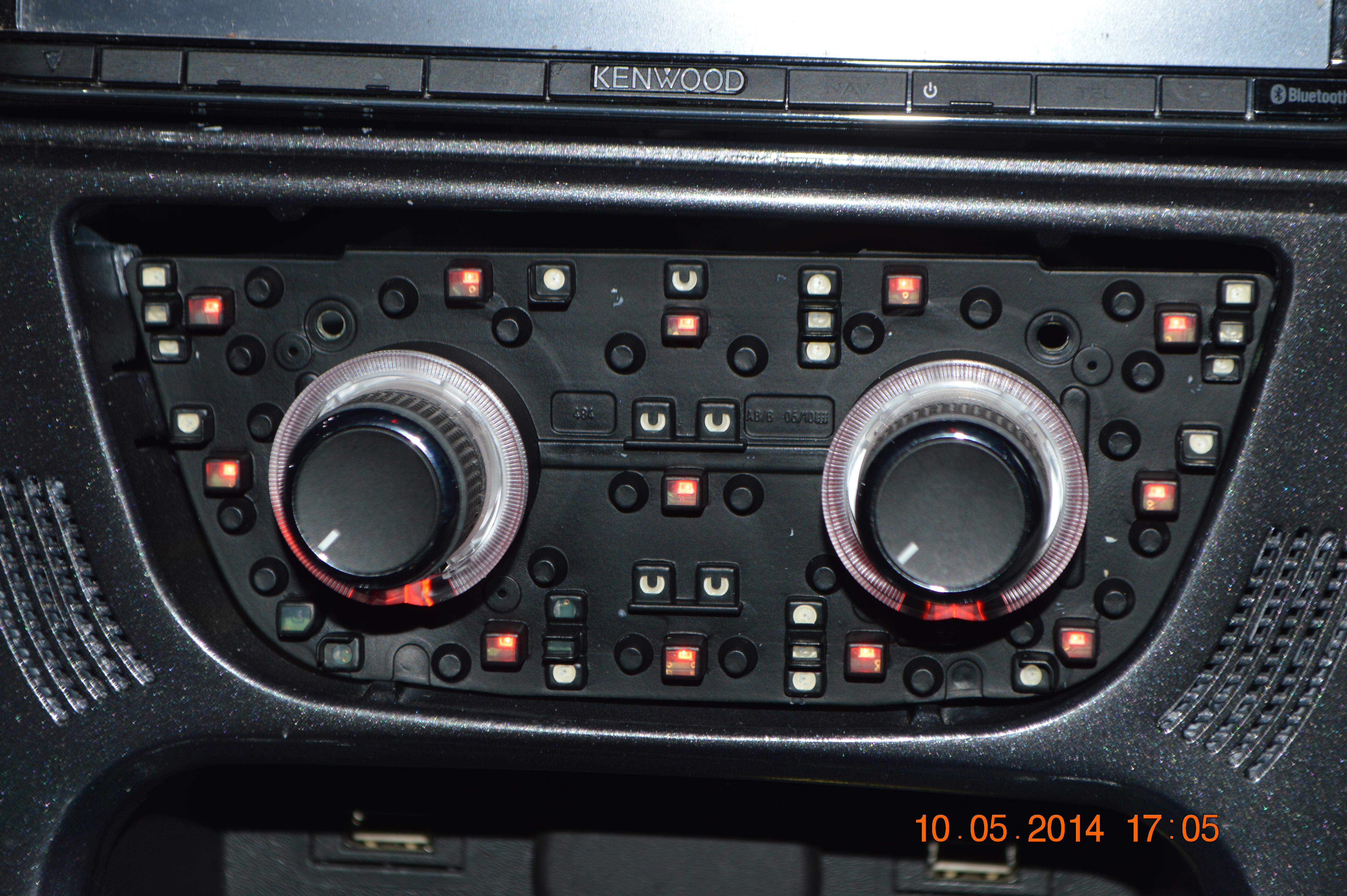

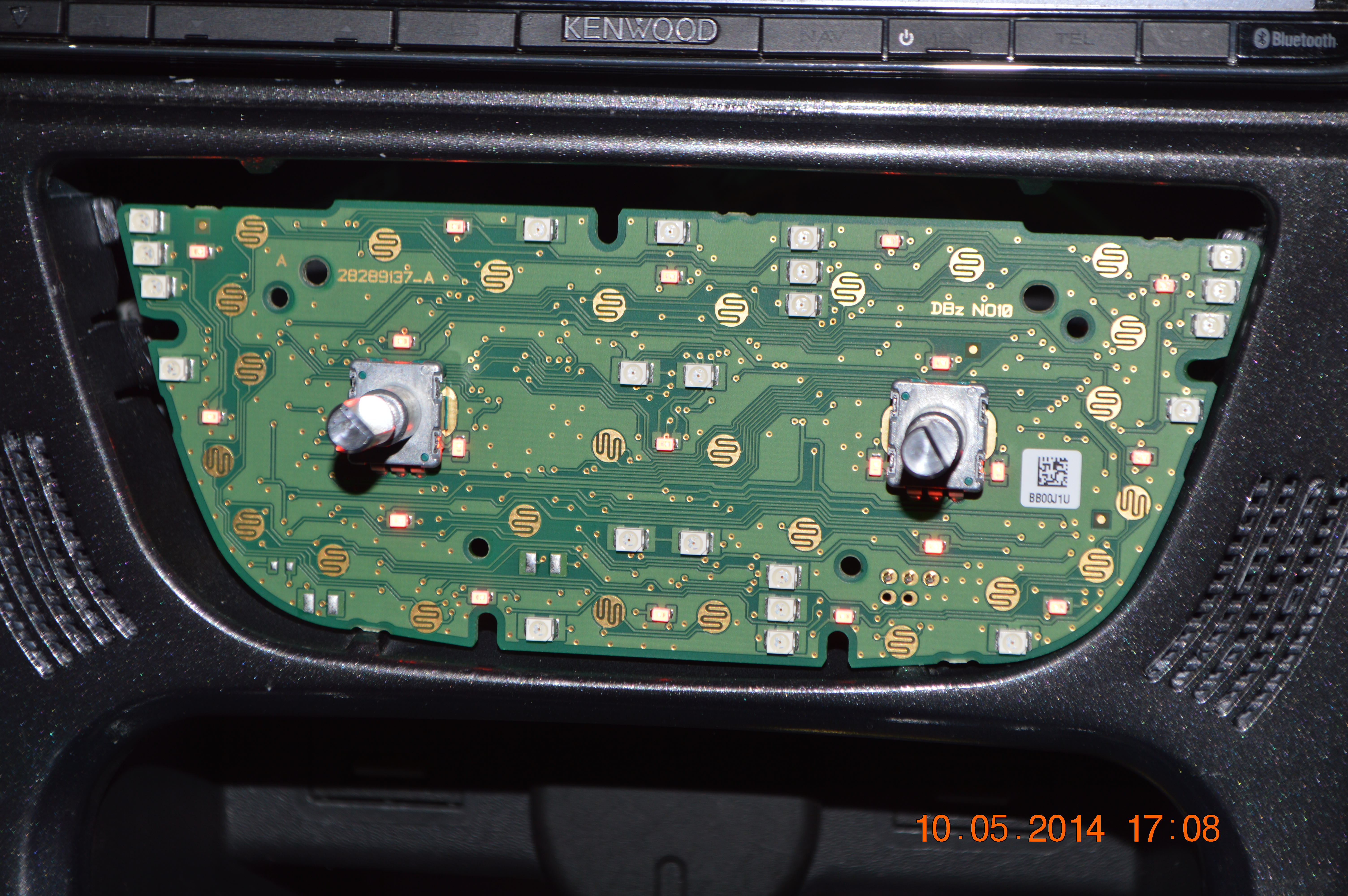

Remove PCB and then remove control knobs( don't mix them up), remove rubber protector

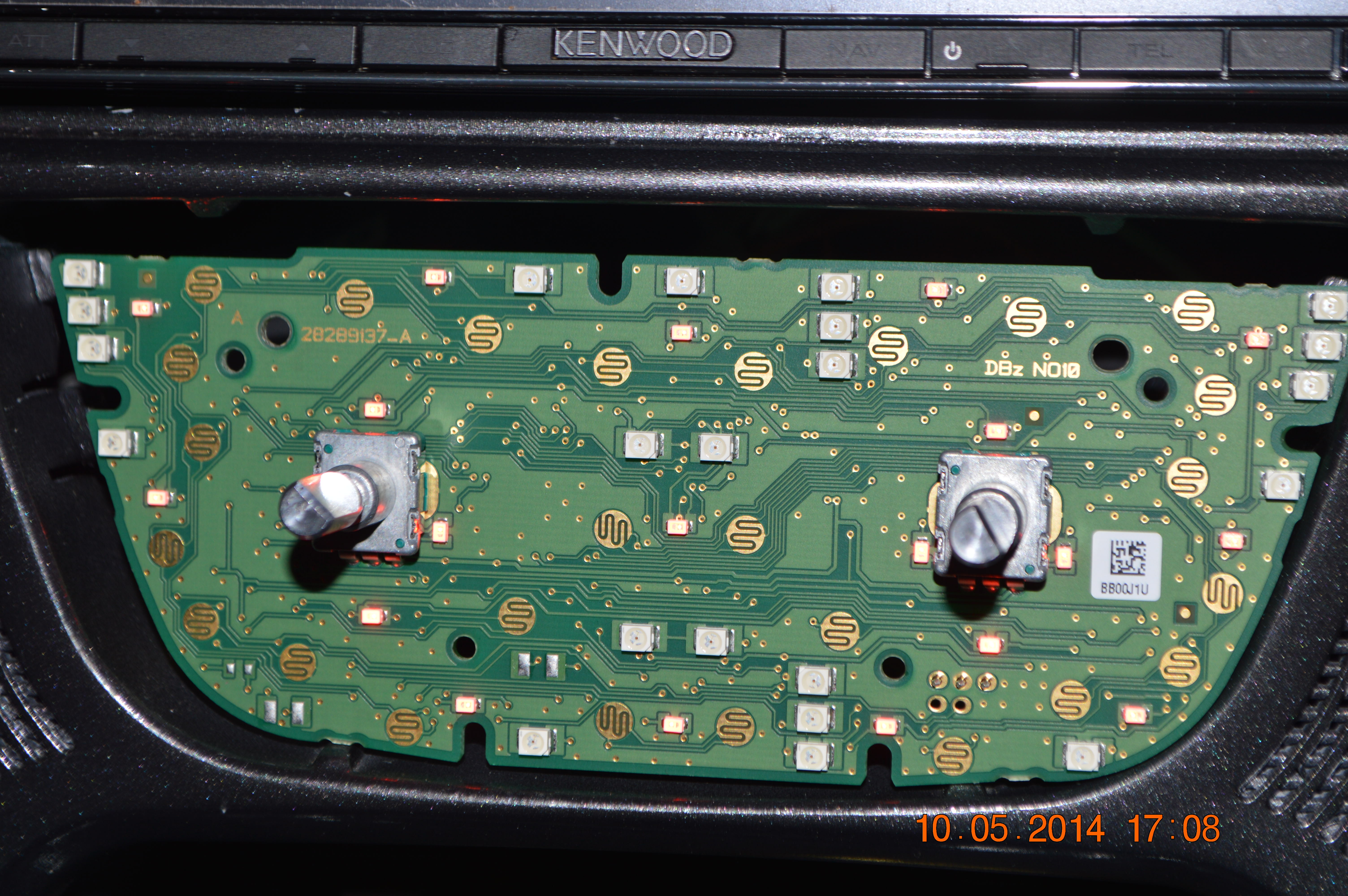

This shows the location of the heater panel leds the yellow circles are 805's, red circle 1206 and black 805 for heated seats
This is dual zone climate yellow circles being back lit and black circles heated seat back lit

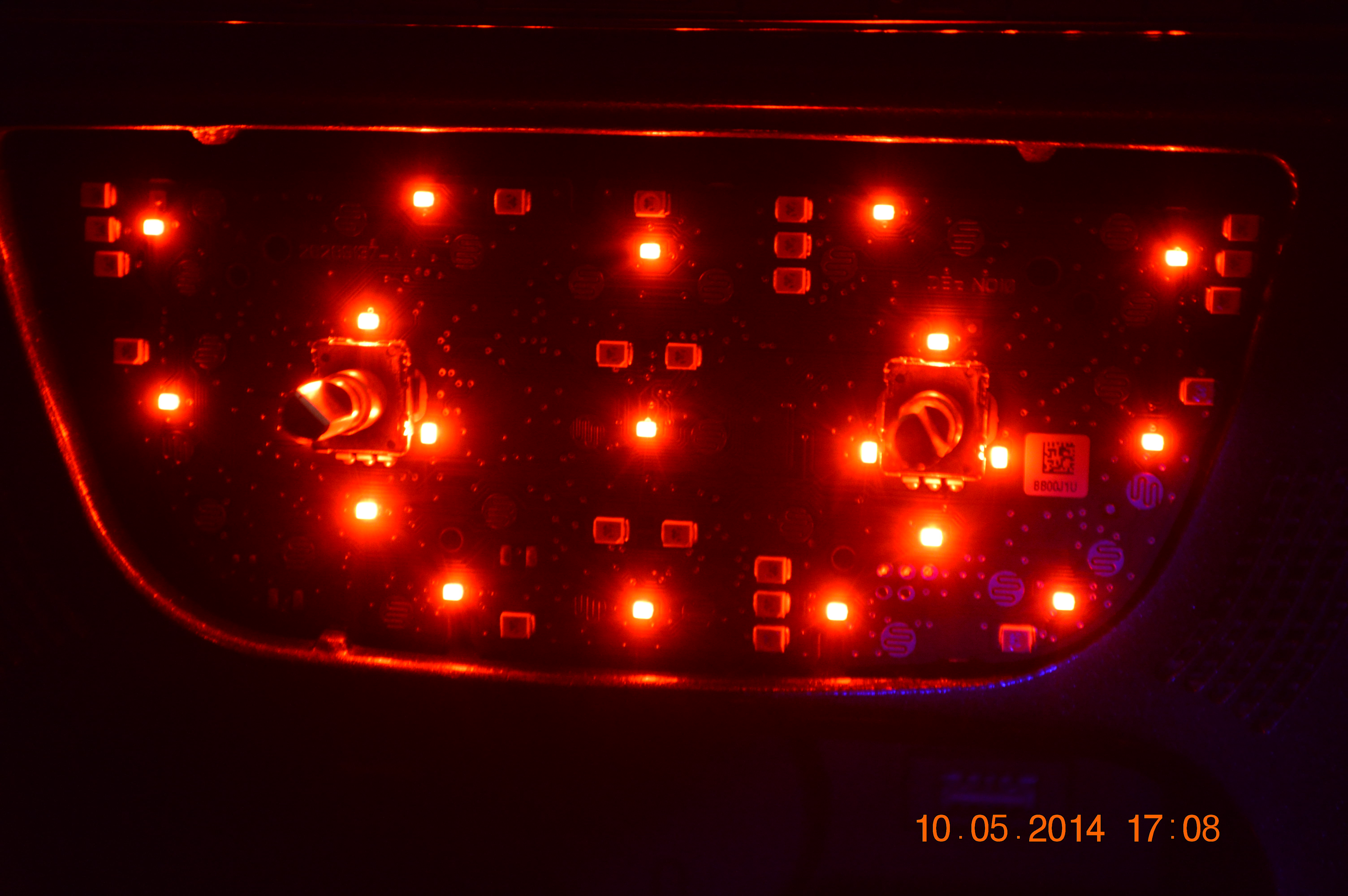

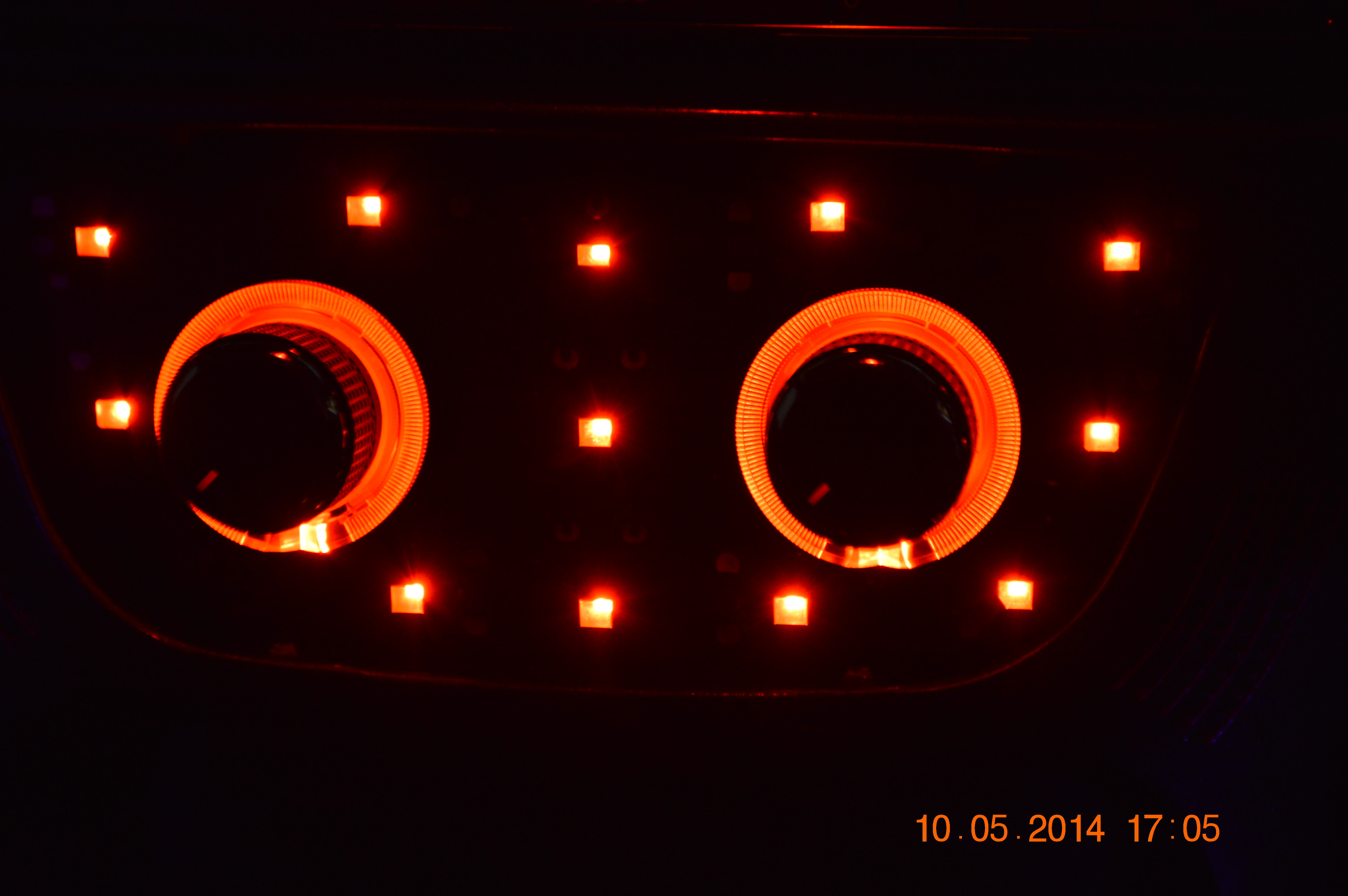

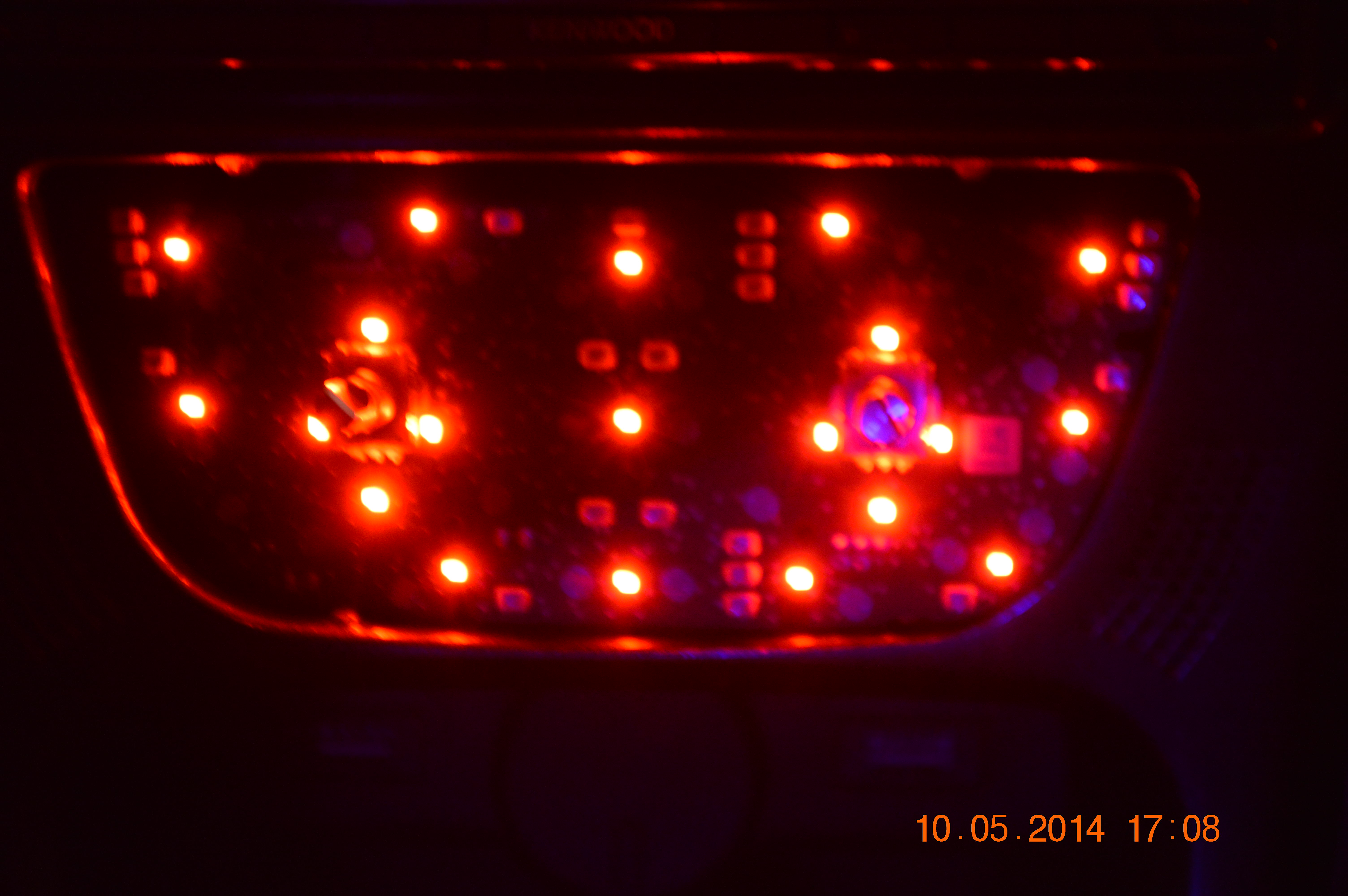

This shows the original red leds
