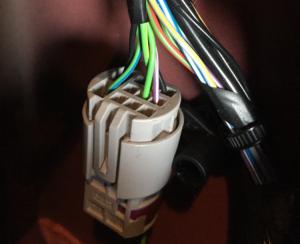

You will also need to check you have the following wires on the grey round plug.
The wires you need to check for TPMS are 1 Black & 1 Green/Blue
There should also be other Black and a Green/Yellow (I believe these are for the rear number plate light)
There is a couple of other wires on this plug but I'm not 100% sure what they are for.
[Image: 02.JPG]

[Image: sfa4ns.jpg]
Going to start preparing for my TPMS Retrofit aswell.
