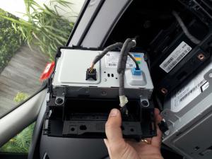

You need to disconnect the light blue GVIF connector on the back of the screen and insert the light blue GVIF connector from the interface box into the screen. The cable that was going to the screen now goes to the interface box. So the interface box is now intercepting the signal going to the screen.
[ATTACH=CONFIG]73[/ATTACH]
You will be routing the cables around the back of the dash, I used an old bicycle tube to provide a bit more protection for these cables so they don’t rub against anything and damage.

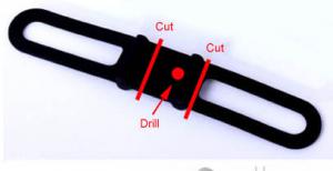

When fitting the camera to the hatch handle I found that the camera needed a wedge under it to push the camera into the optimal position so that the car body panel didn’t show up on the image. I cut a rubber wedge from a rubber bike light mount that I happened to have at hand – drilled a hole in the rubber so it slid over the screw on the back of the camera.

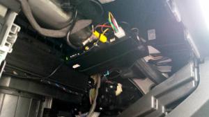

Once you have routed the video cable up to the front of the car, under the dash, connect it to the interface box. The camera video cable will also have a wire for sending power from the camera to the interface box. Connect this wire as the trigger wire on the interface box (so power from the reverse light powers the camera which triggers the interface box to switch the video signal to camera). Heat shrink or tape over all soldering points.
I cable-tied the interface box to the large round steel bar traversing under the dash. You will need to position the box at just the optimal angle (not quite level – tilted forward) to squeeze in under the glove box.
