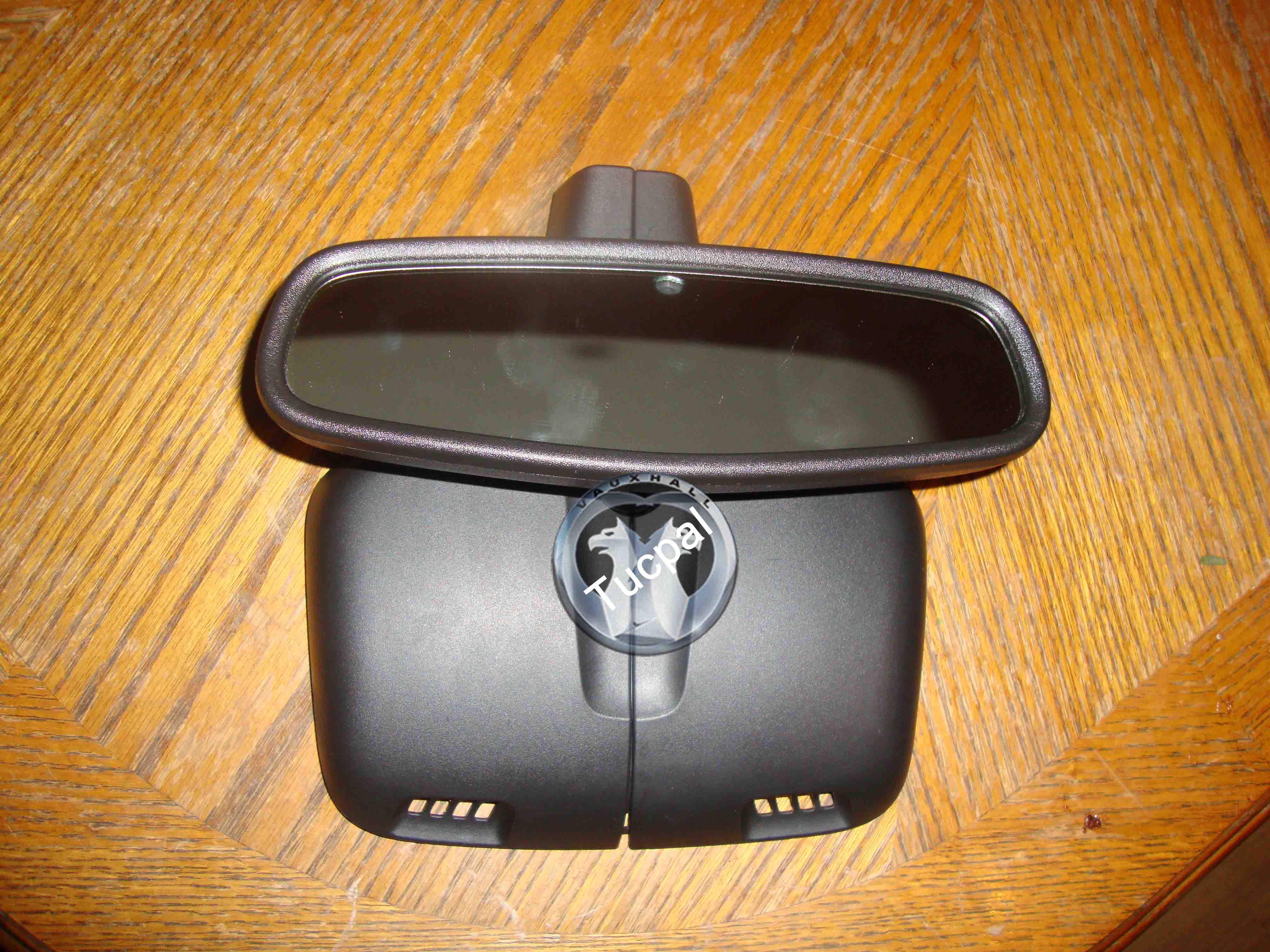

HOW TO FIT AN ANTI DAZZLE REAR VIEW MIRROR.
You will Have to find a Second Hand Auto Dim Mirror on eBay
If you can get the Small Loom that Goes too the Mirror
and the Console in the Headliner with it Also as it is needed.
If not go to your Local Dealer and Order one as you do Need it
you wont Need the Surround as this Can not be Fitted to the Glass
Unless you Replace the Front Windscreen.

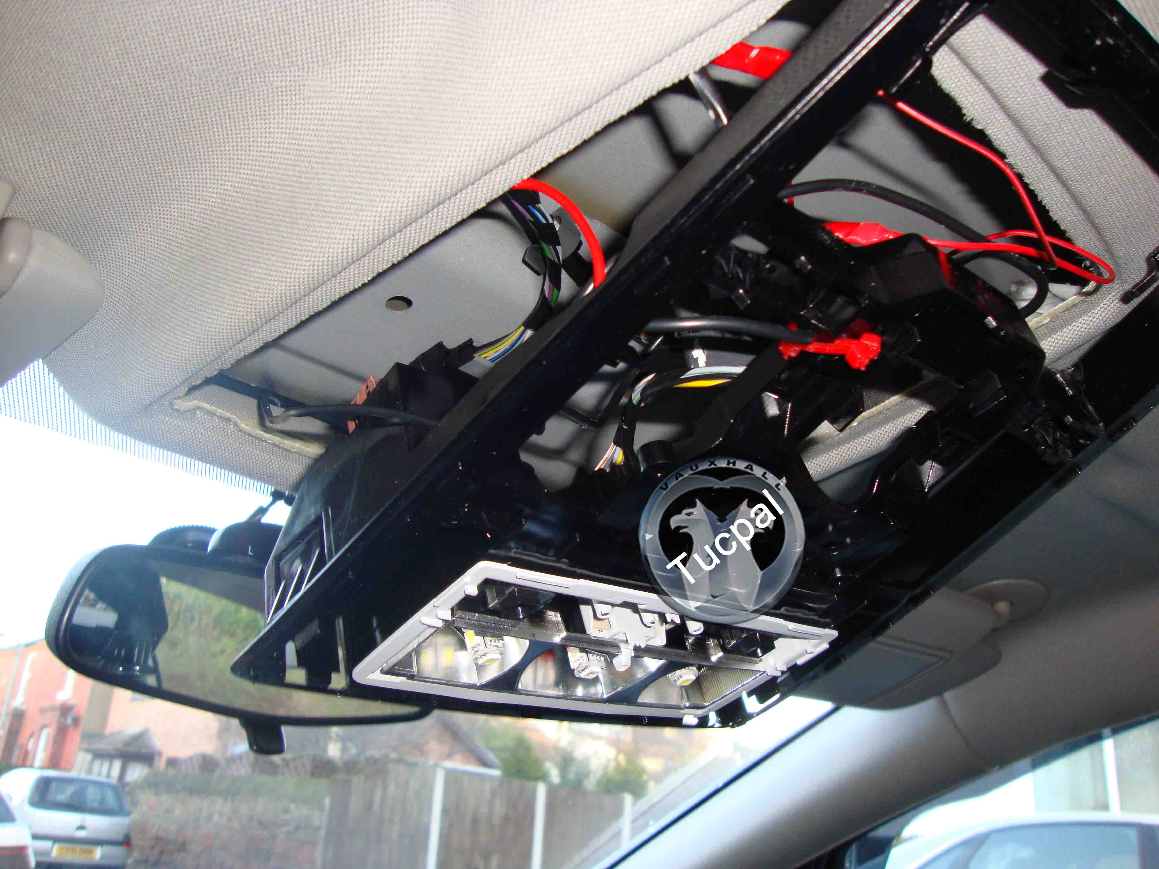

Remove the Console from the Headliner
There are Three Panels to Take off
Then pull the Light Unit out.

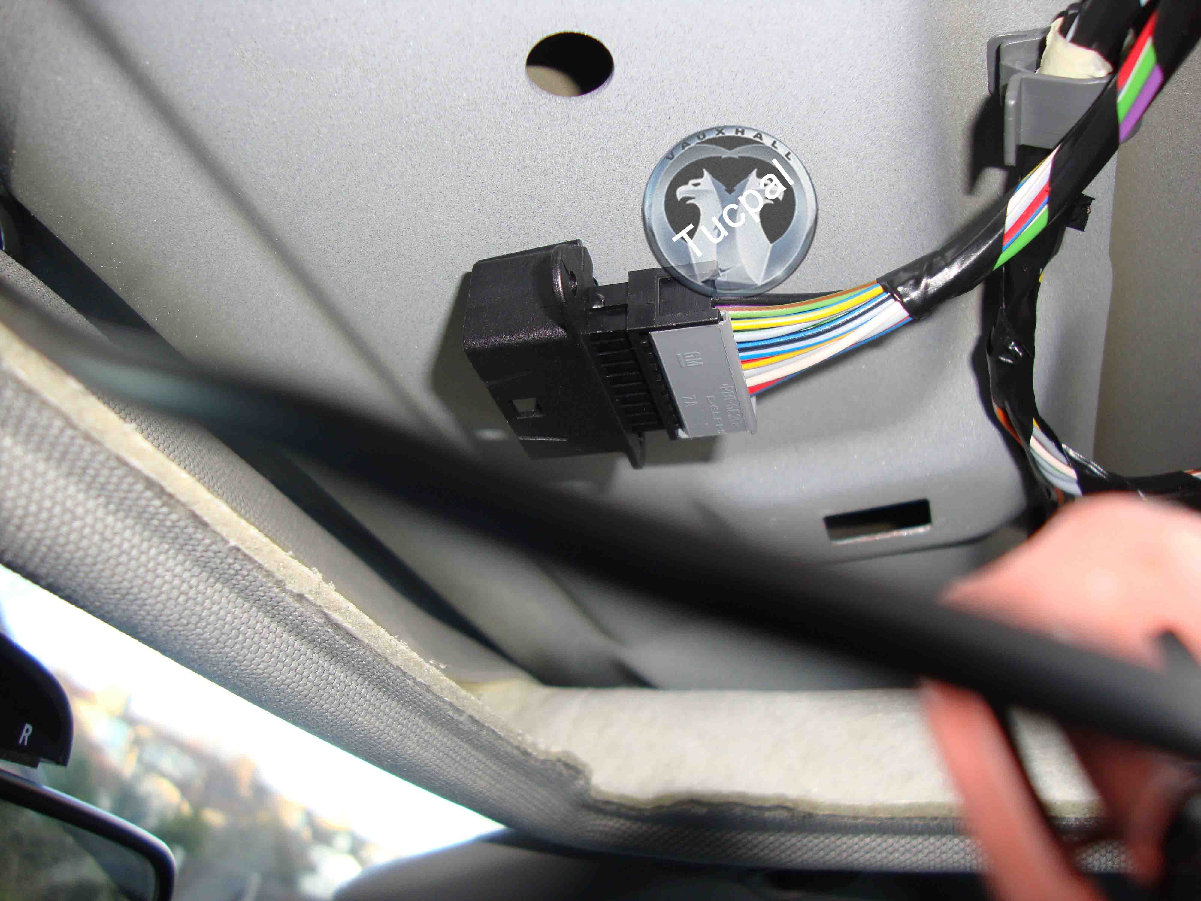

[Image: 2.JPG]
[Image: 3.JPG]

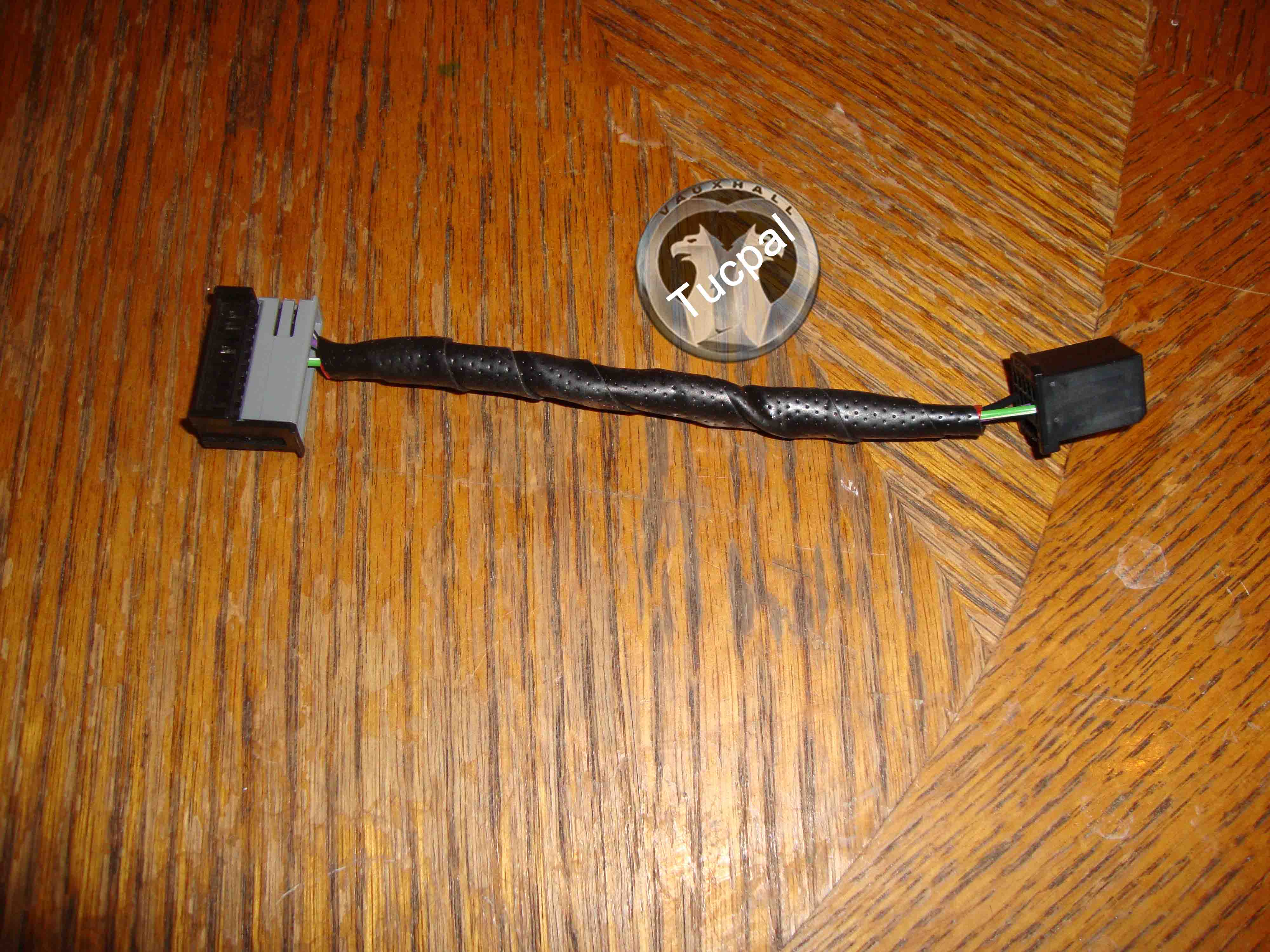

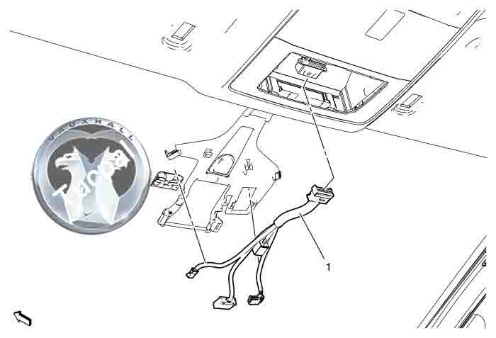

You will Then see a Connector Attached to the Roof
This is the One you will Need.

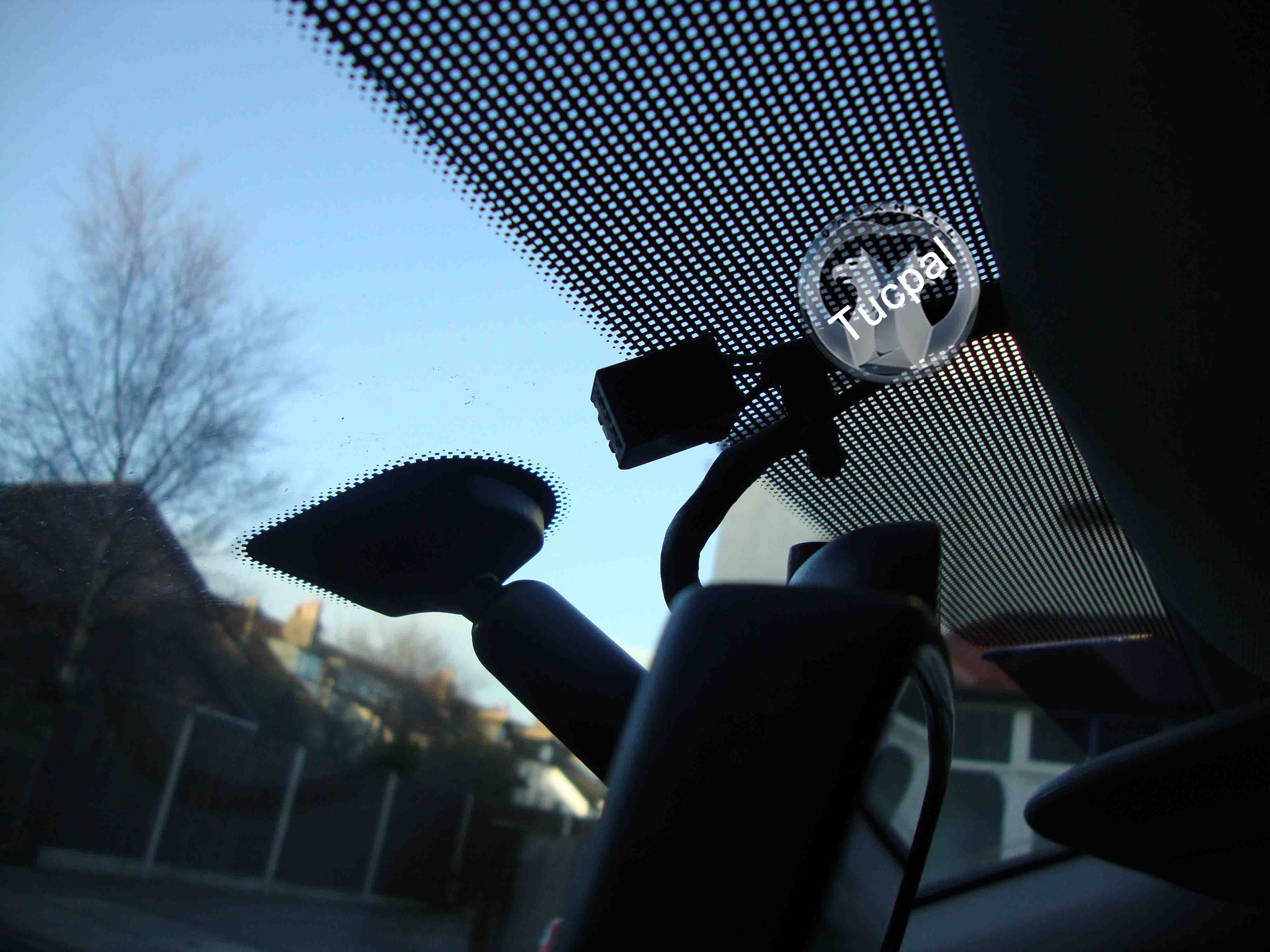

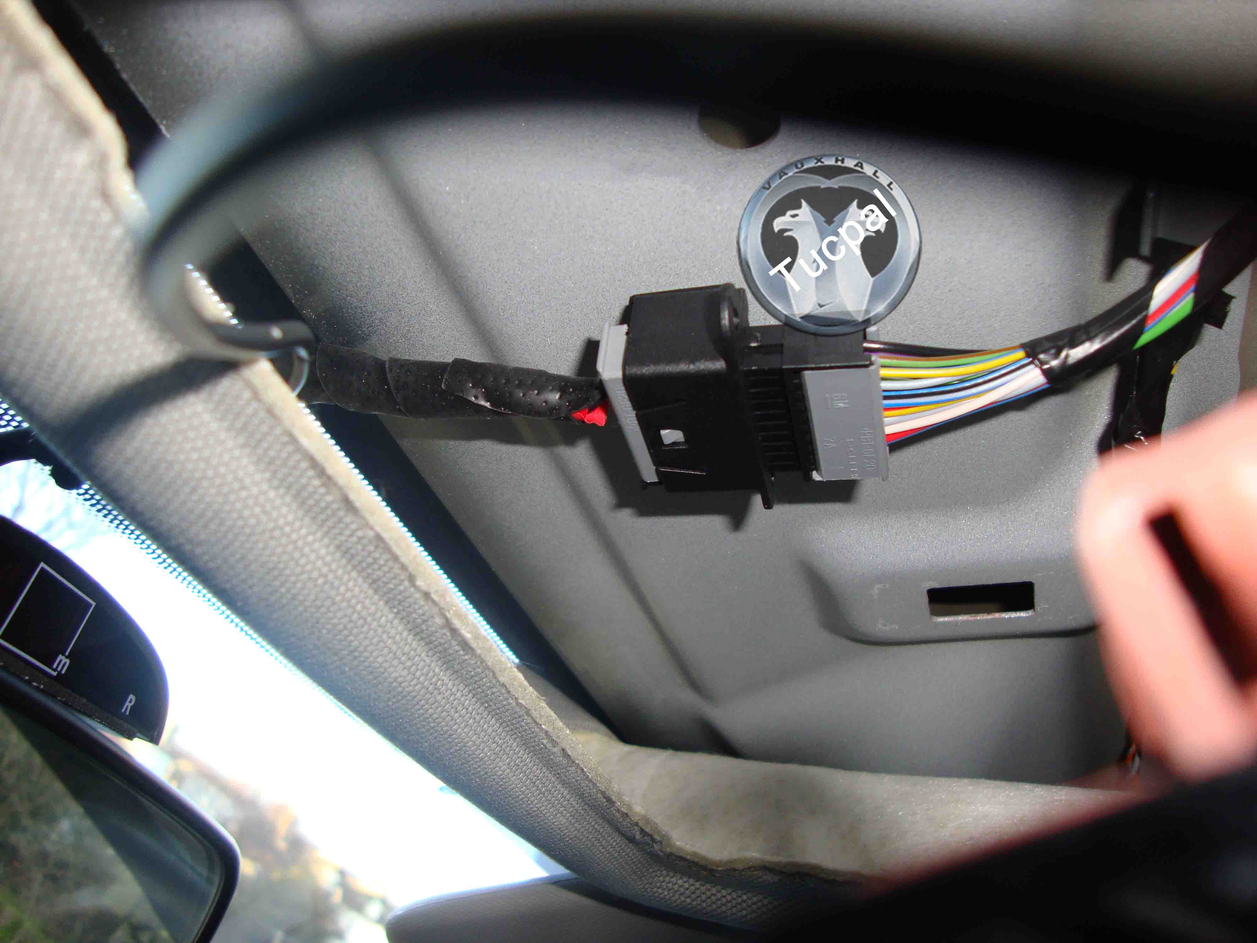

[Image: 4.JPG]
Connect the new Loom to this Connector
Pull the Other end of the Loom
Through the Front of the Headliner Toward the Mirror
The Picture of the Loom Below is the One you Need
It will Have Three other Connectors on it
For the Rain and Light Sensors
That go to the Mirror Surround
As these were Not Needed i Cut them off
but you Don't have too if you Don't want to.

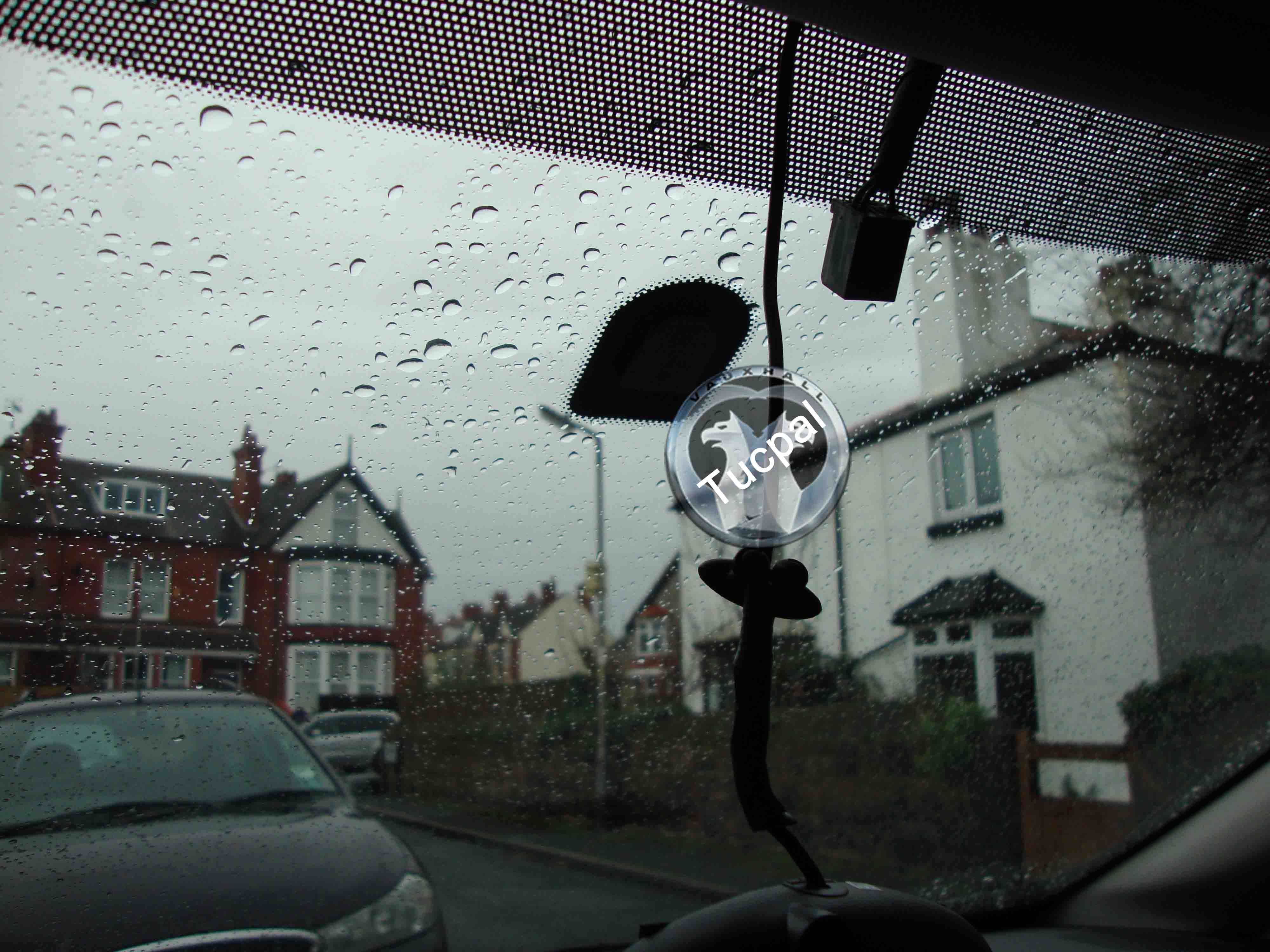

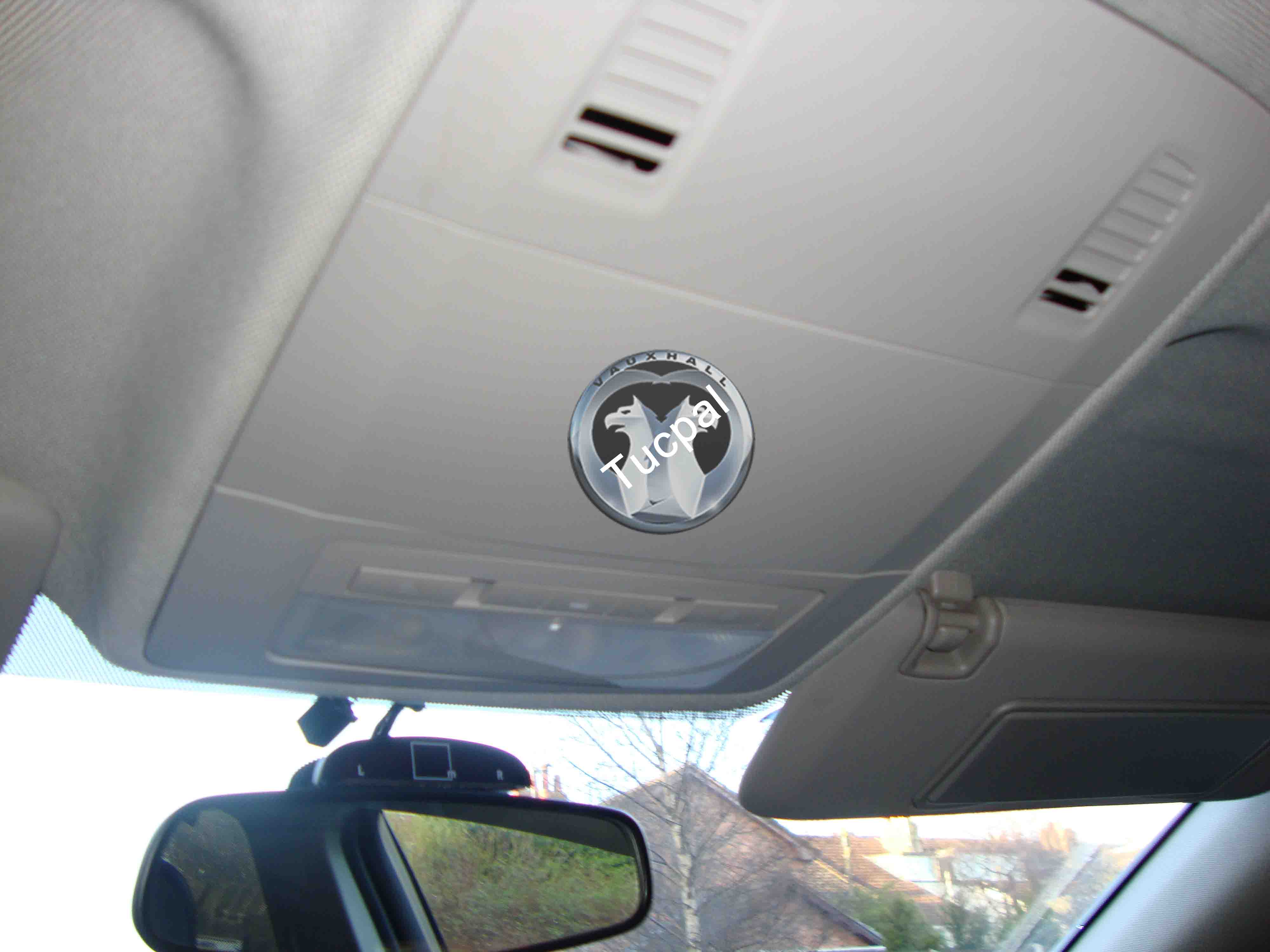

Remove the Plastic Cap that Covers the Mirror Screw
that hold the Mirror onto the Windscreen
Take the Screw out and Remove the Old Mirror
A Toque (T20) is Needed.

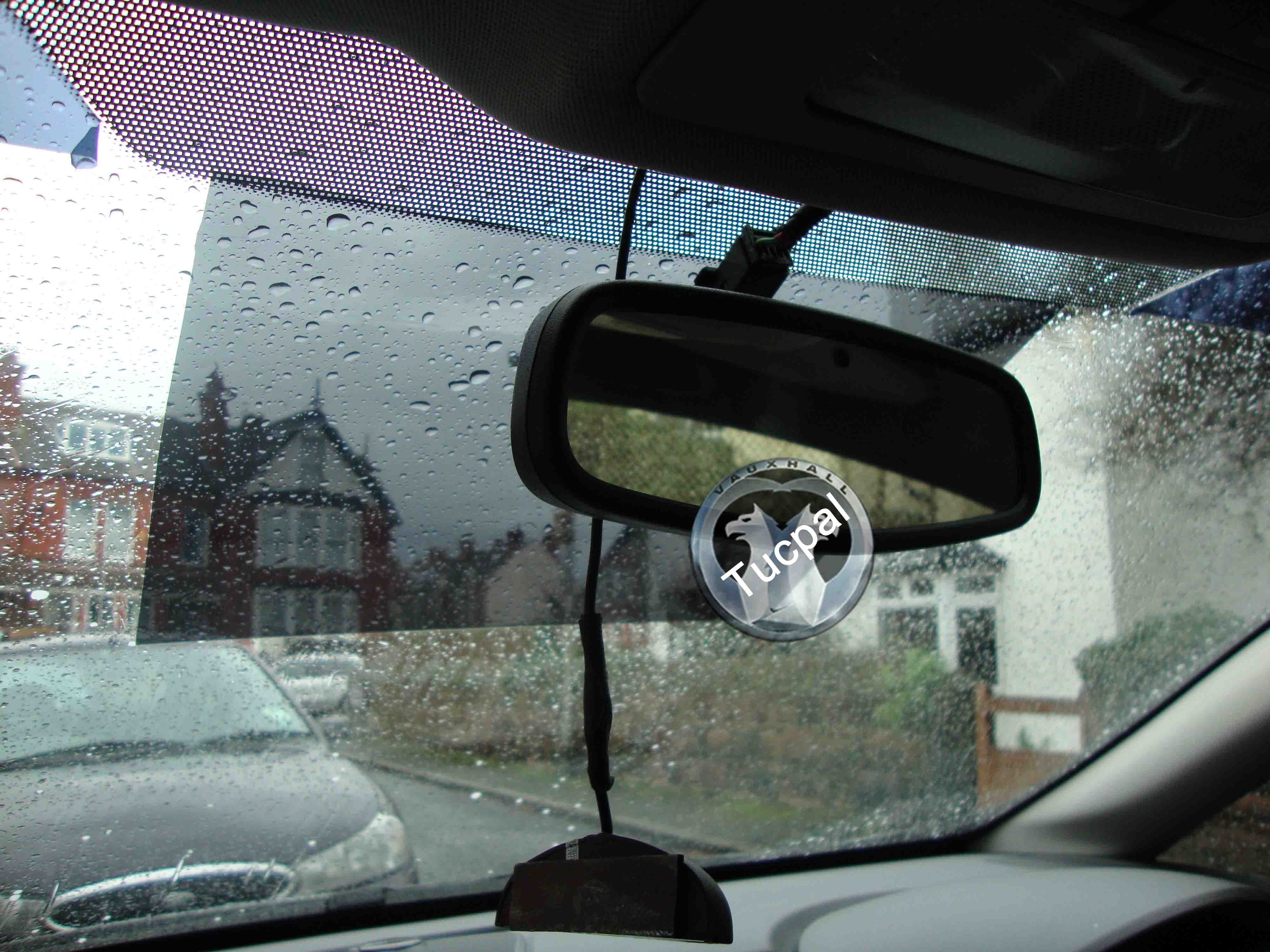

Then Refit the New Auto Dim Mirror
And Plug the Connector in Place.
[Image: 10.JPG]
You now have a Working Auto Dim Anti Dazzle rear view Mirror

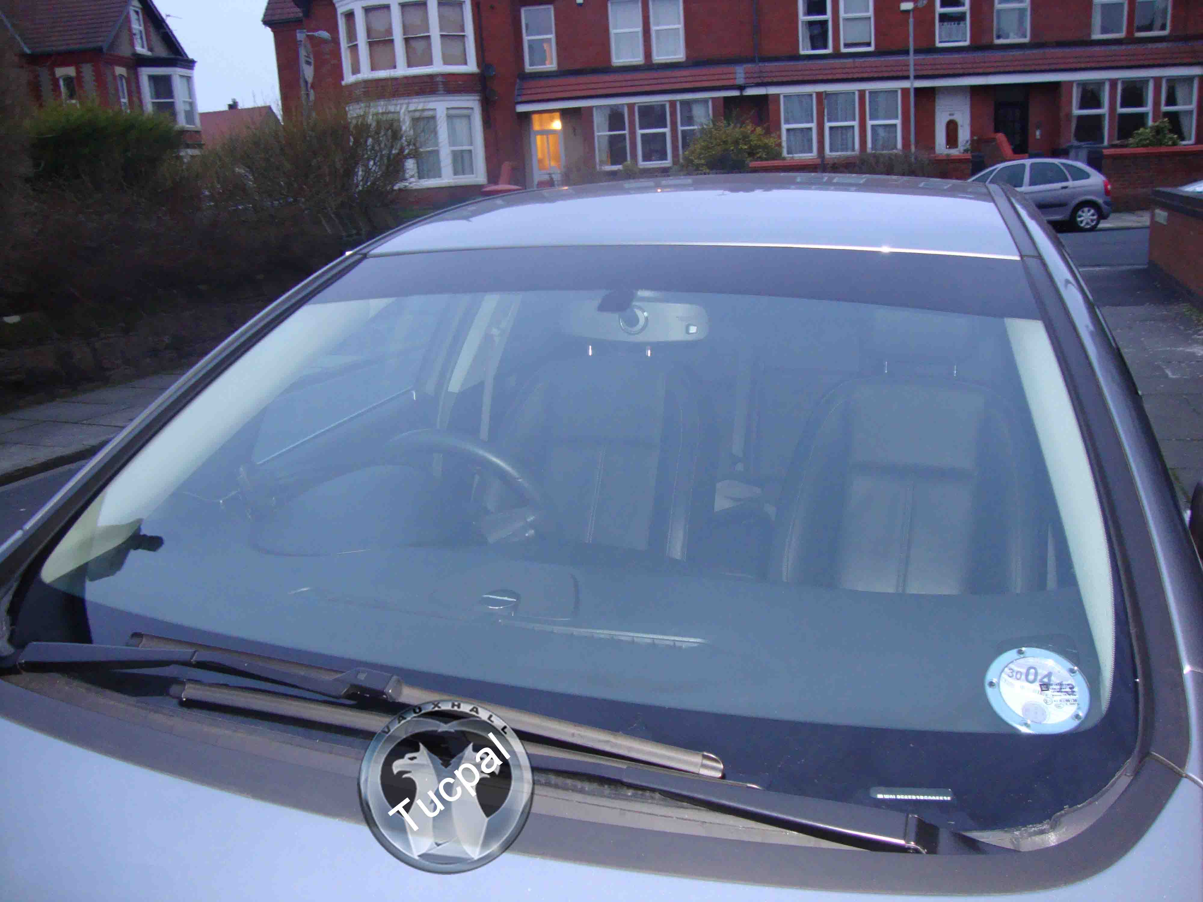

You can Add a sun Strip to the Front Windscreen
to Hide the Small Wire that will be on Show.

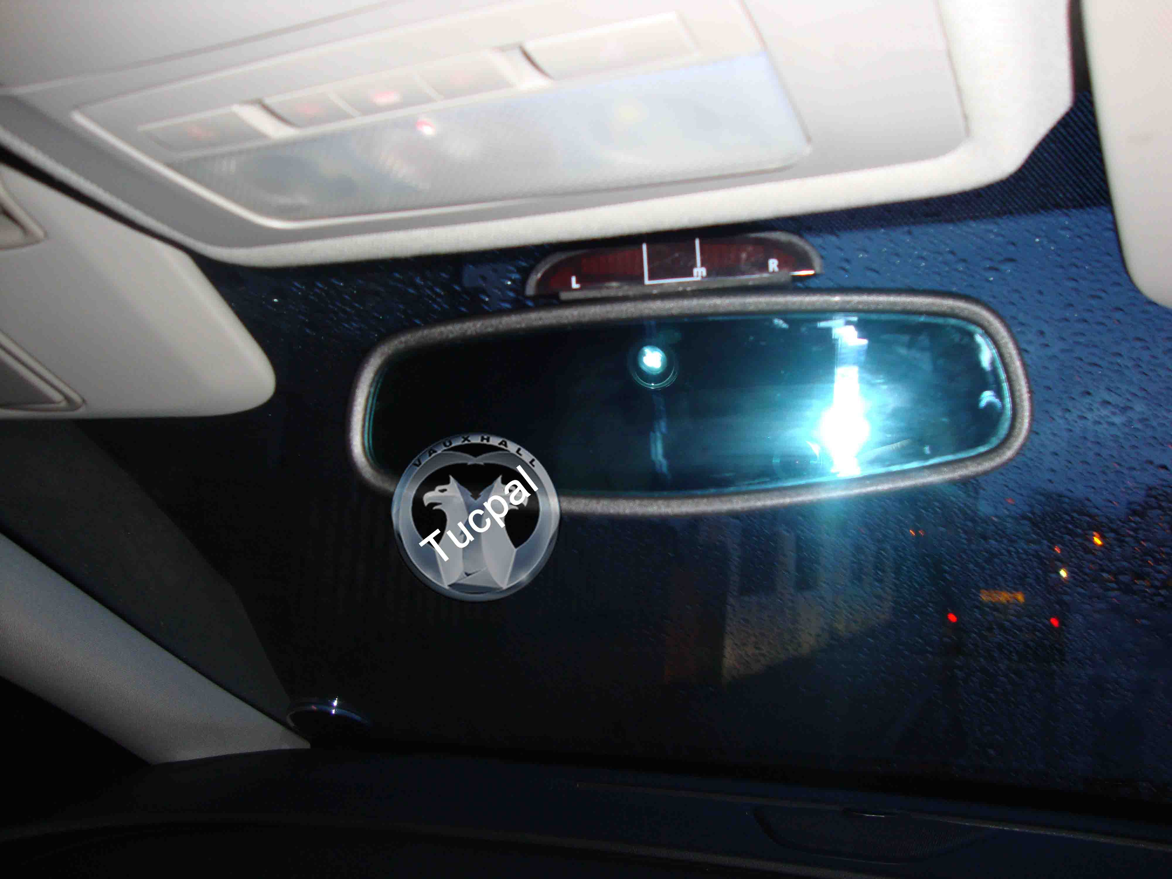

[Image: vx.o.c.jpeg]
Whats that above your mirror?
Aftermarket parking sensors.
correct Thumbs

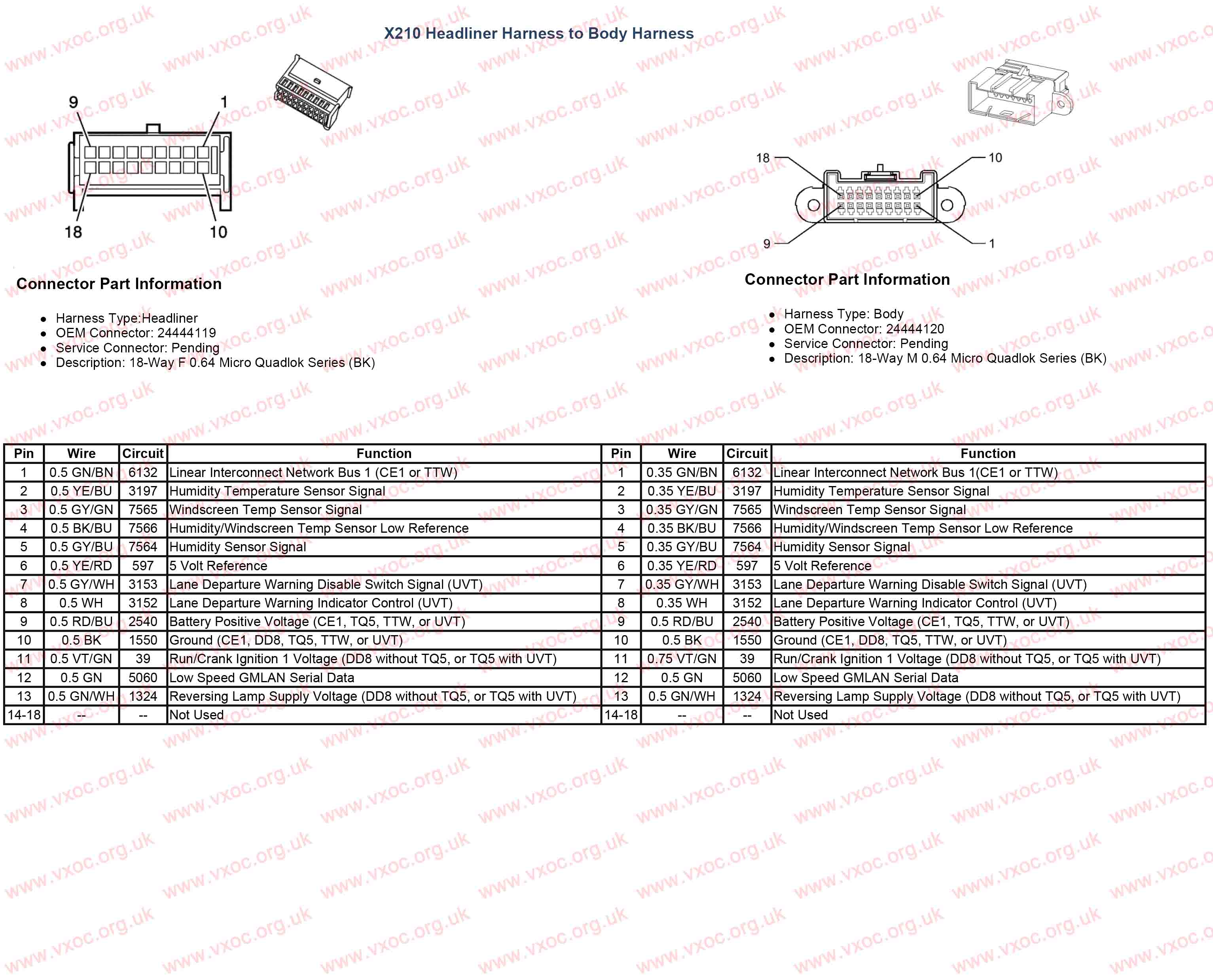

[MENTION=339]Alienbv[/MENTION] thanks for waiting mate, I'm now back up on-line and as promised here is the pin-out.
I was correct in my earlier post Pin 9 for power and 10 for ground.
[Image: X210%20Headliner%20Harness%20to%20Body%20Harness.jpg]
[MENTION=1]Rusty2009[/MENTION] Welcome back dear Rust Wink Thank you for the diagram. A stupid quick question, to mesure the amps on pin 9 do I have to cut that wire to put both ends of the multimeter to get the reading of the Amps? What I see on YouTube is that they cut the positive & mesure on it... Im still learning how to play with electric components Big grin Oh dear I just figured it out Big grin Im so Newbie Big grin ) Just have to touch the connector then the other end to the monitor red wire Wink
Lol no need to cut it mate. as a thought do you have auto lights/wipers? If not you could get the loom extension part number 13378813 remove all the wires not needed (the two greens and 1 purple) cut the light/rain sensor plug off and then you have the power and ground wires with no modification to main head-liner loom what so ever which can also be removed if you sale the car etc.

@Daz21, sorry for my delay in getting back with the info.
Here is a pin out for the plug that you should already have in the headliner
[Image: X210%20Headliner%20Harness%20to%20Body%20Harness-1.jpg]
You need to make sure it has the following wires / pins.
Pin 12 Green
Pin 11 Violet/Green
Pin 10 Black
Pin 9 Red/Blue
