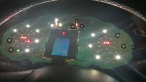

The picture below is marked up as follows
12x Red is PLCC-2 white LED'S (you may have 2 LED'S here one will be RED you need to change the ones with yellow tops) The White start at D15 and end at D26 the Red start at D81 and end at D92.
4x Blue is PLCC-2 Red needle LED'S
4x Green is PLCC-2 Side load Up-level display
[Image: 18.JPG]

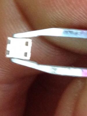

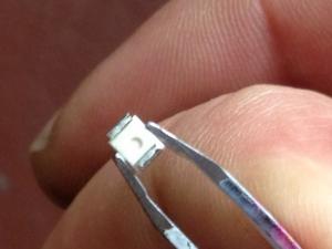

So it is ok to use plcc-2 led's instead of plcc-4 like originals are?
I ordered PLCC-4 as we thought it was but when I took it off it was a PLCC-2
Orig LED
[ATTACH]438[/ATTACH]
PLCC-4 LED
[ATTACH]439[/ATTACH]

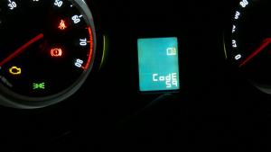

I did change the LED by the red line to RED the issue was there was too much light spread and the LED is located in the wrong position.
[ATTACH]453[/ATTACH]
Would of looked ace tho if it worked.

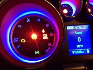

This is my conversion done a few months back
Normal
[Image: 20150301_110201_zpsoybetat4.jpg]
VXR
[Image: 20140521_061901_zps7k3bsa8y_edit_1426266...7cznjx.jpg]
i like that baz looks real good Doublethumbs
