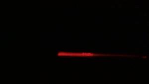

Guys little help regarding ambient light.
I have astra j sport tourer, year 2013. The ambient light is there by default but it doesn't give that strong light. Connector is the big one.
I replaced the old one with new but its the same.
This is how it looks form close by night.
Any idea how to fix this?
I wll check with instrument the electricity, to check voltage
#91
Hmmm that's odd! All I can suggest is extending the wire and splicing straight into the ambient light circuit or the headlight power cable behind the headlight switch... That's what I did and it works great
#92
Maybe needs new LEDs??
#93
Could be either! Could even be a faulty/loose wire
#94
(29:th-Jan-2016, 20:11:49)sheppy1 Wrote: Hmmm that's odd! All I can suggest is extending the wire and splicing straight into the ambient light circuit or the headlight power cable behind the headlight switch... That's what I did and it works great
The problem is that the car is still under warranty. I don't know if the warranty is lost if i do that...
(29:th-Jan-2016, 20:30:36)Tonto Wrote: Maybe needs new LEDs??
I bought new one. it's the same
(29:th-Jan-2016, 20:36:09)Nemo Wrote: Could be either! Could even be a faulty/loose wire
I will measure tomorrow voltage. Should me 12v as well?

Mines got the 100k miles warranty too mate, bought the car new aswell and the only warranty you void by doing any mod is on the thing you've directly modded ... Like I've changed almost every part of my car so those aren't covered any more but the parts I haven't touched still are
#96
to be honest they won't even bat an eyelid to that or even notice as it is standard on most models a genuine part
#97
Silly question but have you turned the brightness down on the headlight switch. Other issue is have you tapped into a 5v supply instead.
You can check the led tube out by connecting to a known 12v supply
#98
I tried with that first.
Here is the update:
At the main connector which comes to the led is black (-) and white(+) wire. I have there 12V. At the connector of the led i get 3.5V
I'll try these days to check if will be ok if i connect to the switch of the lights.
#99
When you say led connector do you have a picture where your getting 3.5v
I didn't take the picture. I get 3.5V in the big connector of led. Where is red and white wire.
I was reading on croatian opel forum that sport toruer didn't go with ambient light around gear gator.
I dont know if is this only for croatian market, or for all... But could be that in this part is the problem.
But anyway i will take 12v from light switch. Hope that will be okay....
