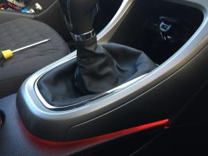

This is a how to for the ambient LED light
that goes around the Gear Gator using the Factory LED.

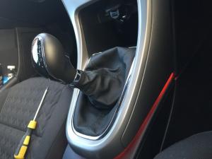

When you have the Trim off
the next Step is to Remove the Gear knob and Gator
pull back the Gator and you will see a Blue Clip.
[Image: 2.JPG]
Push the Black Plastic Clips together
and Pull the Blue Clip up to Remove the Gear Gator.
[Image: 3.JPG]

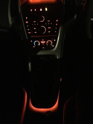

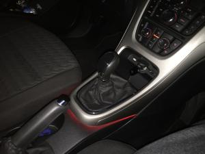

RESULTS..........
You now have the LED Working on the Ambient Light Circuit.
The LED will now Light up when you Open the Door and then Fade out
Then come back on when you Turn the Headlight Switch on
and go off when you Turn the Headlight Switch off
and come on again when you Open the Door and Fade out when the car is Locked.

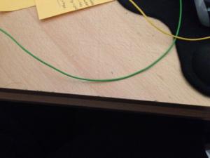

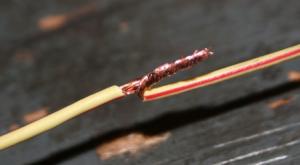

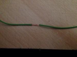

Don't cut the orig wires on the headlight just remove the sheaving from them, also stagger the them.
Like so.
[ATTACH]311[/ATTACH]
[ATTACH]312[/ATTACH]
you dont cut the wires on the headlight you ether splice in to the wires
solder and shrink wrap them together
or use snap connectors like this.

No you do that if your soldering.
For a connector you don't remove the sheaving just put the wire from the switch in the fully open side and the wire your adding on in the end that is capped off then click the connector together.
Rusty2009 Wrote:No you do that if your soldering.
I know what you mean now, was just having a hard time visualising it! Ha. Thanks for all your help!

Hi guys! I got the light working!!! Ha. Turns out it was the splice connectors that weren't cutting into the cables properly! As soon as I took those off and spliced the cables together by hand, it all started to work! Big grin
Now my question is that was splicing them together by hand (twisted them and folded them down flat against the plastic casing of the wire itself) and then wrapping each splice in electrical tape, a safe way of doing it? I know soldering would ensure they definitely don't come loose but is the way I've done it going to be safe enough?
Well glad you got it all working and don't forget to add a picture lol as long as they are well connected and taped with electrical tape you will be ok but as said a bit of solder will make it better
tucpal Wrote:Well glad you got it all working and don't forget to add a picture lol as long as they are well connected and taped with electrical tape you will be ok but as said a bit of solder will make it better
That's a relief then! Was worried that wasn't a safe way of doing it...I spliced them like so:
[ATTACH=CONFIG]316[/ATTACH]
And then wrapped the tape around them tightly and ensured no wires poked out. I'll ask the garage to stick a dab of solder on I think when they are doing my seats (if they turn up in time!)
Below are some quick photos after I did the lights while it was still light outside:
[ATTACH=CONFIG]317[/ATTACH]
[ATTACH=CONFIG]318[/ATTACH]
[ATTACH=CONFIG]319[/ATTACH]
[ATTACH=CONFIG]320[/ATTACH]
And a couple more:
[ATTACH=CONFIG]321[/ATTACH]
[ATTACH=CONFIG]322[/ATTACH]
I noticed that they come on when unlocking the car door (love this) and stay on after the car door is locked again...I stood and watched them for about a minute but they never went off...How long does it take for them to go off again?
Looking good mate, do you know I've never paid attention to how long they stay on for after locking the car.
are there still on now ??
@rusty Glad you like them! Thinking of doing the door lights next Wink may do it at the same time as the door cards if i decide to keep the elite ones i've bought.
[MENTION=2]tucpal[/MENTION] I got bored of standing in the cold and came back in the house, when i next went down about half an hour later they weren't on...
Ok that's fine but they should go off after a minute.
tucpal Wrote:Ok that's fine but they should go off after a minute.
Hmmmm very odd then! I even unlocked the car again, turned the lights to off and then re-locked the car and stood there again and they still remained on...When i get chance this weekend I'll time how long they take to go off and report back Smile
Thanks for all your help too guys!
