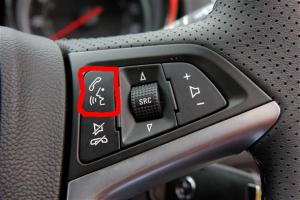

I would like connect my gate garage remote control to phone button on steering wheel. I can't find right pin on connector. I have not bluetooth, but button MUTE works. I have radio CD400. Gate garage remote control power baterry 12 V.

I'll look later but i'm pretty sure there is only one signal wire which is used to send commands from the buttons
Right I've just checked and yes there is only 1 wire used to send the signals, you maybe able to tap into this but it might lead to problems. I hope the below will help.

Thank you Rusty! I will try to do some sensor for detection correct button. Where is hidden BCM - Body Control Module? I will make some measurements. I do not want airbag explosion, so I hope it is different connector :-D
