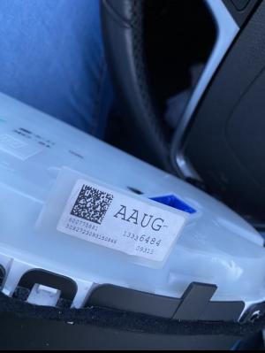

So I decide to change it and I bought a used instrument cluster with almost the same number of kilometres and the same part number (13336484) and it works great and I reprogrammed it using I’m-com and now it shows all the menus I wanted to see.

The pic with the yellow screws is the used instrument cluster I bought and the other one is the original.

Your IPC needs programming to your car. I'm pretty sure you can't do that with opcom. It needs your vin programming into the IPC.
This is quite a specialist field for reprogramming clusters, have a word with @rusty . You'll probably find you'll have to ship it over to be sorted as a lot of people do.
Ok thank you for your advice guys. I will contact him. I hope it’s gonna work.
Yes the need de-programming from the original car and then reprogramming to your car with an MDI and SPS.
There could be an issue in that you've now played with op-com them it may have overwritten the original cars vin.
This can be checked real easy with op-com.
Either way it's possible but if the VIN has been wiped out it'll mean opening up the unit.
I checked the vin number on Op-com and each IPC shows me it own vin number so I think there’s no problem with that.
Is it possible that I send you my IPC so you solve the problem please ?
I live in France
Yes of course I see I have a PM from you which I will reply to in a minute.
