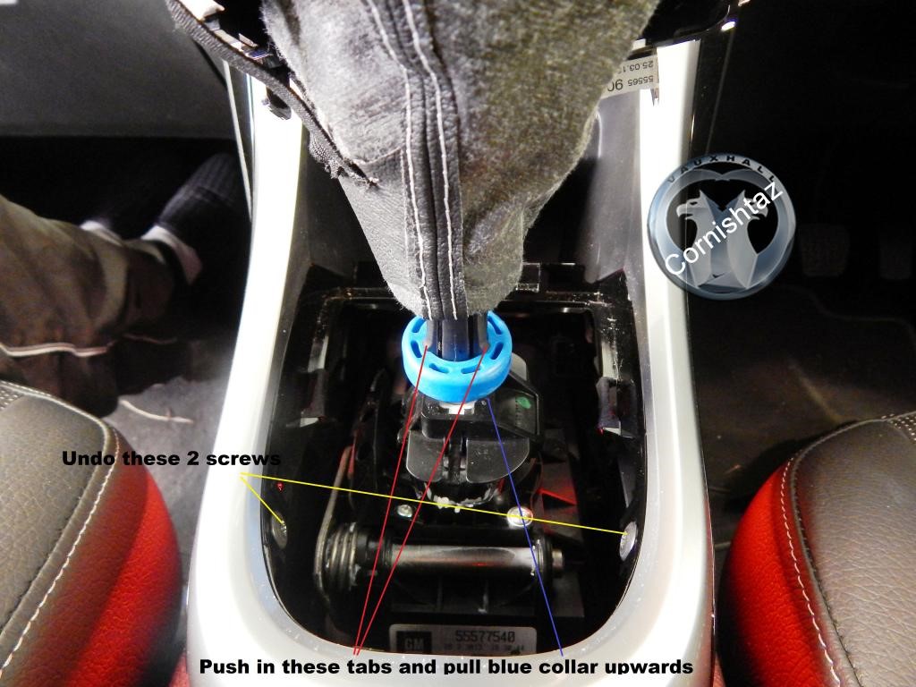

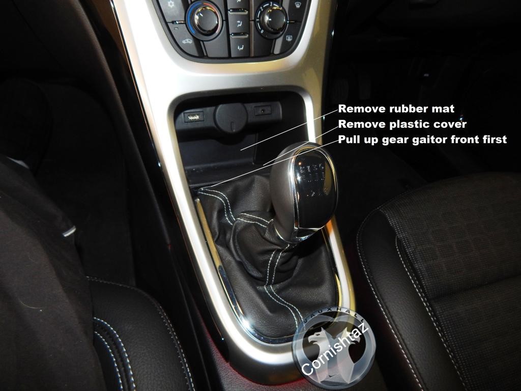

Start by removing the following parts. 1. Rubber mat 2. Plastic cover 3. Gear gaiter
[Image: 1.jpg]
I removed the gear gaiter completely by pushing in the 2 black tabs and lifting the blue collar. You can remove the 2 screws holding the centre console surround, then remove the surround completely.
[Image: 2.jpg]

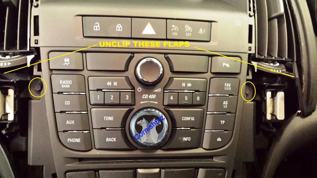

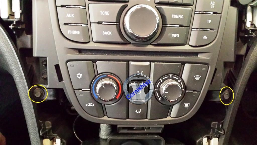

There a 4 7mm bolts to be removed
[Image: 3.jpg]
2 are located behind two flaps by the centre air vent
[Image: 4.jpg]

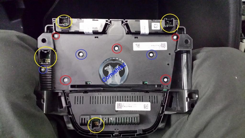

Disconnect the elec connectors circled in yellow(ignore other circles)
[Image: 5.jpg]

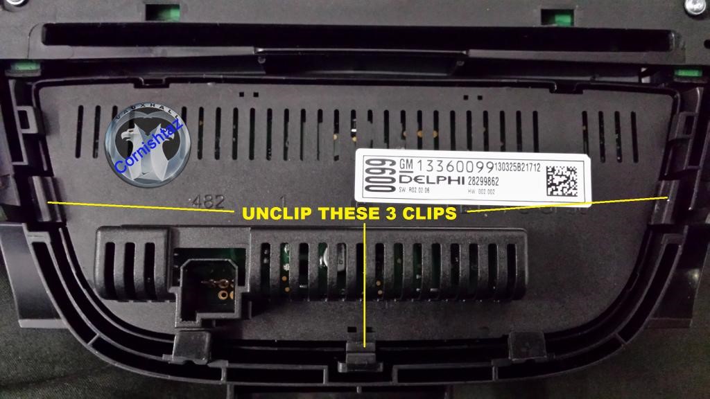

Remove heater panel with these 3 tabs
[Image: 6.jpg]

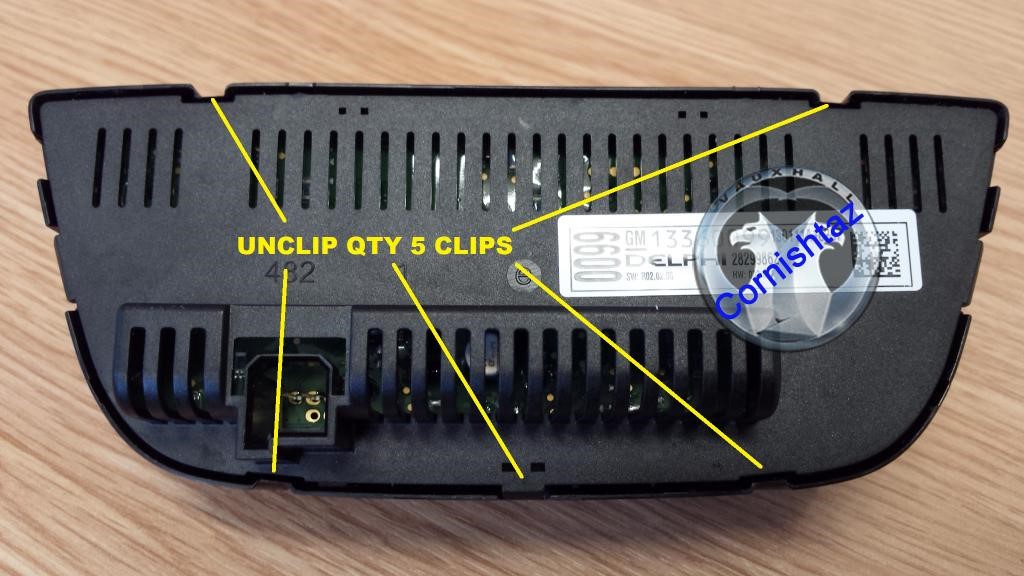

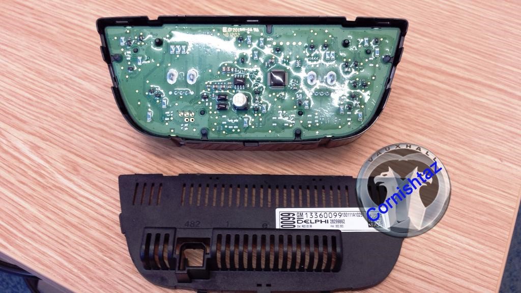

Split heater panel
[Image: 7.jpg]
Cover removed
[Image: 8.jpg]

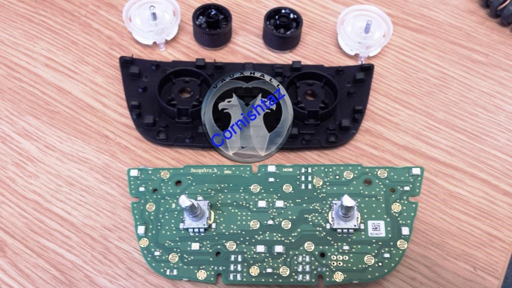

Remove PCB and then remove control knobs( don't mix them up), remove rubber protector
[Image: 9.jpg]

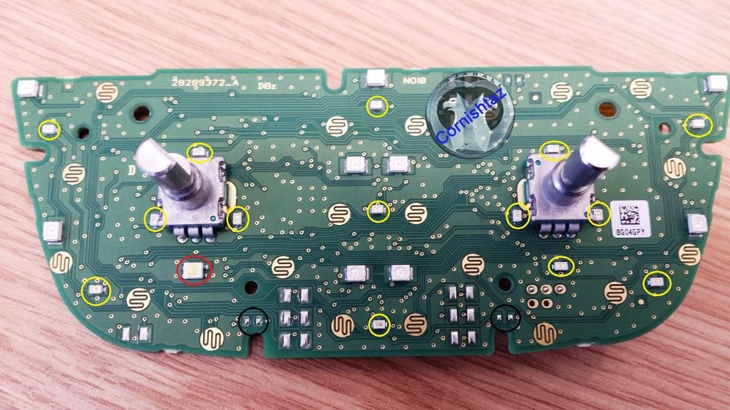

This shows the location of the heater panel leds the yellow circles are 805's, red circle 1206 and black 805 for heated seats
[Image: 10.jpg]

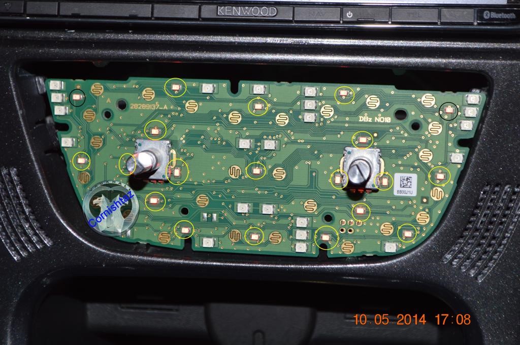

This is dual zone climate yellow circles being back lit and black circles heated seat back lit
[Image: 11.jpg]

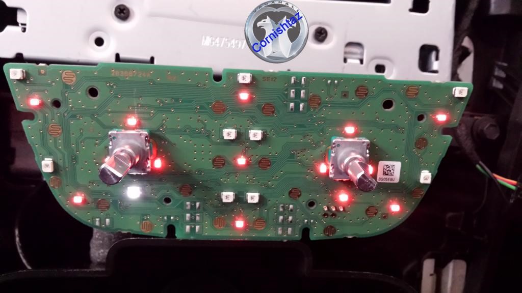

This shows the original red leds
[Image: 12.jpg]

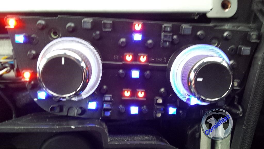

Rusty2009 Wrote:Looking good mate, I'll defo have to order some more LEDs before I send it all up to you, do you want me to look at my daul zone?
If you mate possibly with it lit up in the car as per the bottom 2 pics and add it in here

Here you are mate. If you want some pics let me know but my Cam bat has ran out so will have to wait till it's charged up.
[Image: DZ0.JPG]
[Image: DZ1.JPG]
[Image: DZ2.JPG]
[Image: DZ3.JPG]
[Image: DZ4.JPG]
[Image: DZ5.JPG]
Thats perfect mate thanks. Looks like 20 805 led. First post updated

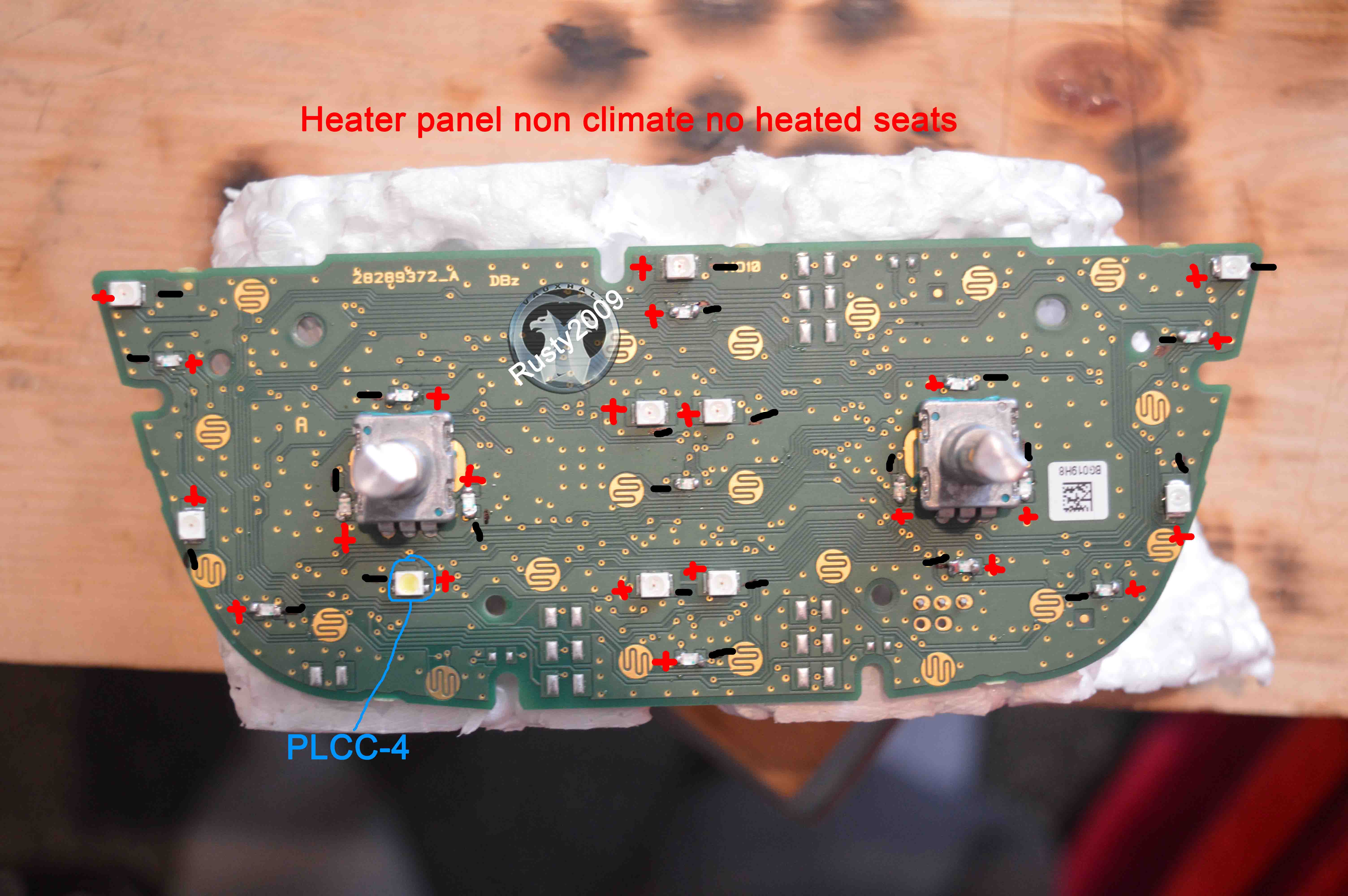

Here's a image showing the positive and negative of Heater panel non climate no heated seats
[Image: Heater%20panel%20non%20climate%20no%20he...0seats.jpg]
Hey @Rusty2009 - found that plcc4
It's the temp dial surround light and this particular led has some odd properties.
Clockwise starting top left, pin 1,2,3,4
Using continuity testing on the multimeter,
-ve pin 1, +ve pins 2 & 3 give continuity, no effect in the led.
+ve pin 4 and it glows almost whitish.
+ve pin 1, -ve pin 4 and it flows red.
Does this dial alter colour range depending on the temp selected?
Certainly, it's not behaving the standard way I would expect from a plcc4
Ah yes on the non dual climate panel. I always leave that one as it's a white LED to light the blue/red temp colour markings.
Really? Looks like it's to light up the knob, not the markings around it which have the usual 3x 0805
Certainly, having trouble finding a reverse polarity bi colour led in plcc4 that's blue & green, so it I left for now.
The 0805's light the knob.
