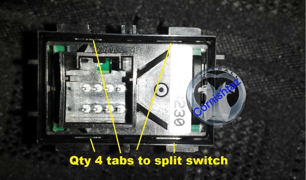

Using the info in Tucpal thread remove the Centre console and EPB switch
Once switch is removed

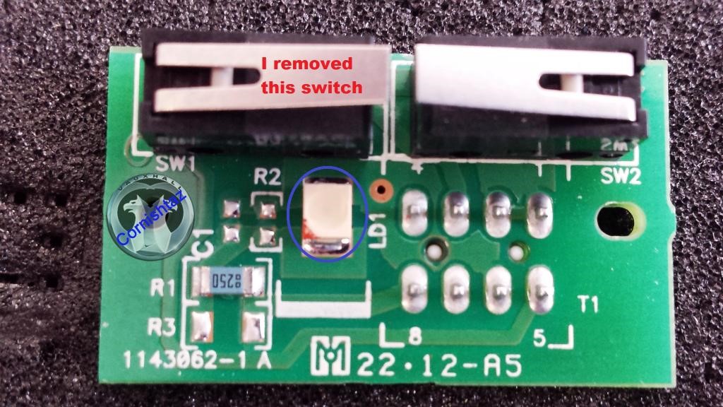

Split switch using these tabs
[Image: 1.jpg]
The LED to be changed is in blue. To make it easier I removed the lefthand switch(3 connections underneath)

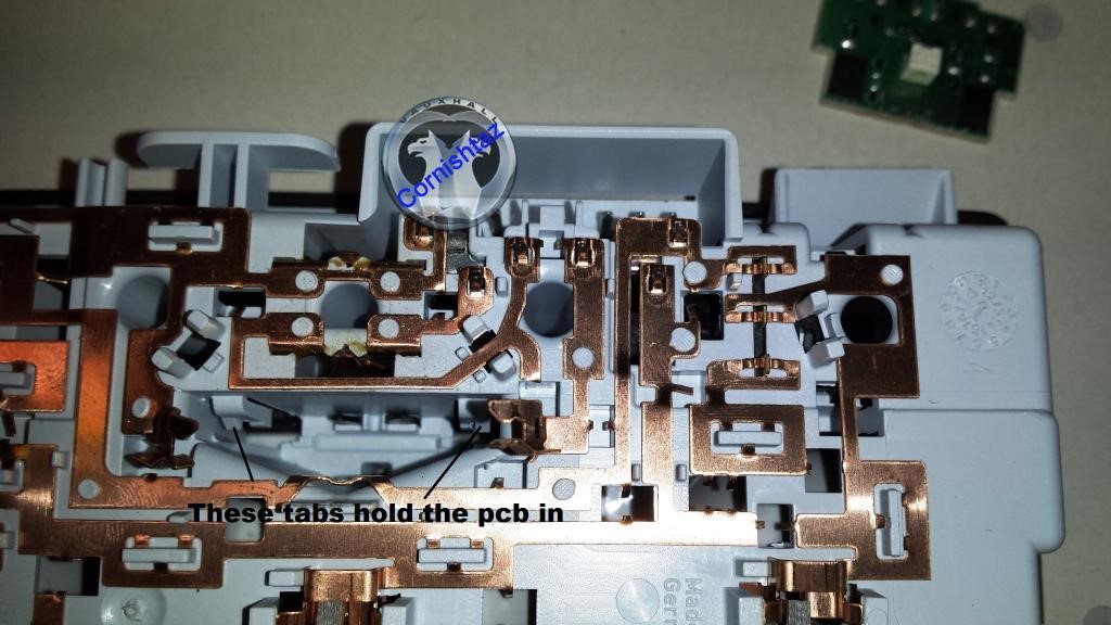

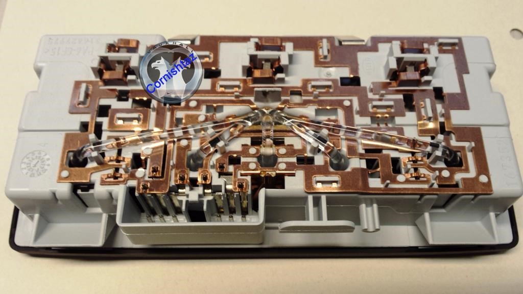

[Image: 3.jpg]

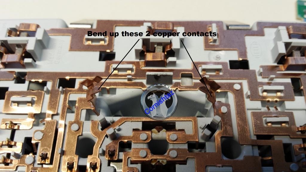

Then bend these copper tabs (carefully)
[Image: 4.jpg]
There are 2 small tabs holding the PCB in
[Image: 5.jpg]

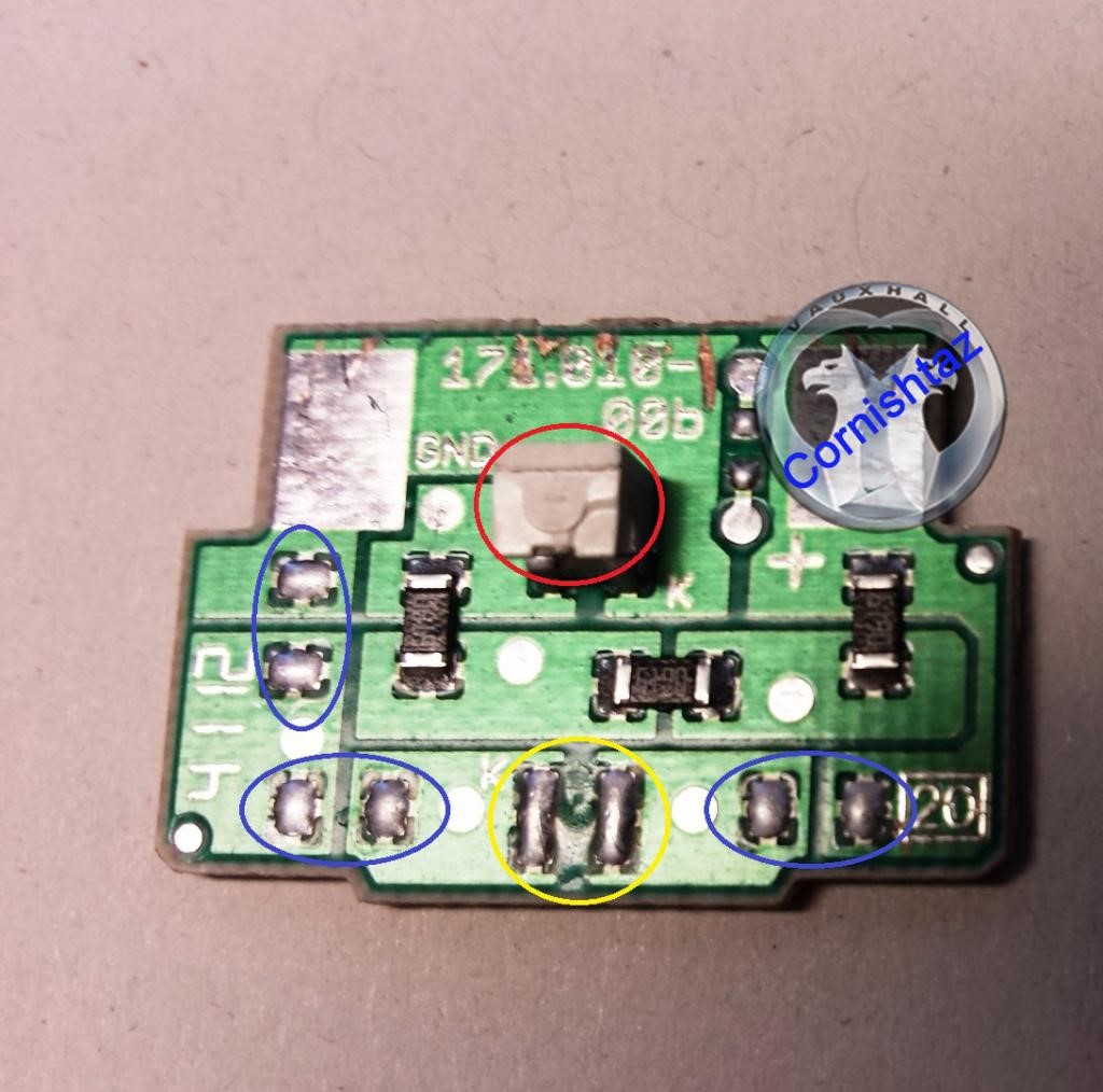

PCB LED for the switches circled red. I also added ambient lighting(early models may already have this my 13 plate didn't) You need to add a 2nd PLCC-2 sideled in the yellow circle and qty 3 619R smd resistors circled in blue
[Image: 6.jpg]

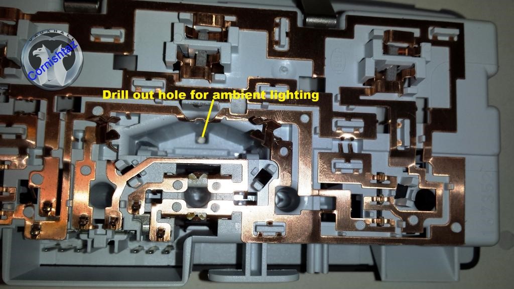

This is where the 2mm hole needs adding
[Image: 7.jpg]

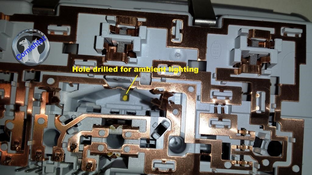

hole added(yellow square)
[Image: 8.jpg]
Completed
[Image: 9.jpg]

Hi baz, might just be me being stupid but what do I need to change just the switch colours? Do I just change the one circled red?? Can you send me a link to the led in red please.
Cameron UK Wrote:Hi baz, might just be me being stupid but what do I need to change just the switch colours? Do I just change the one circled red?? Can you send me a link to the led in red please.
Yes mate just the LED circled in red. There is a link in the items required above, its the same as what is used in the gear surround

I bought same resistors from the link (619R)
But on pcb i have different resistors. this 619r are smaller then other. On them is mark 5110. Those should be 511R??
This one? http://www.ebay.co.uk/itm/5-X-RESISTOR-0...XQrC9Sa7~6
Or should be some other then 0805?
Thanks!
The only thing I can think is Vauxhall changed the resistor for some reason. The ones I listed were the ones on the panel I removed from my 13 plate VXR
I will take picture tomorrow.
But if i'm getting it right. 0805 marks the dimension of the resistor.
So i need to measure mine and check with this table? i hope Big grin
https://www.westfloridacomponents.com/su...sizes.html
Yes 0805 is the size I'll have to double check the size
Thanks.
I'll take picture tomorrow for others to see, as well to know there are different type of resistor.
Just remeasured the resistor and appear to be 1206 size
This is the picture of mine PCB.
[Image: 2016_05_06_19_18_23_One_Shot.jpg]
Size should be as well 1206. So should i buy 1206 511R resistor or some other?
Thanks for help!
This is my pcb it looks like Vauxhall changed the resistor value.
[Image: 20160505_201723_zpsvsattb9x.jpg]
1206 511R should be ok
