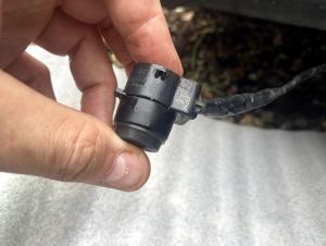

 I did look at the middle right parking sensor, and interestingly the sensor has been glued directly onto the wire (see photo). There should be a female attachment that the sensor locks into but it is gone.
I'm wondering if the problem is connected, do you/anyone have any ideas, or routes to go down to find the issue.
I'd like to know who thought repair was acceptable.
The problem is sourcing the correct plug isn't easy unless you find a cheap rear or front loom off ebay.
