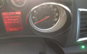

Once done start the car up and turn on the rear demist the LED should light up and go off.
[Image: DSC_0223.JPG]
[Image: DSC_0222.JPG]

[img=0x0]https://imgur.com/j8c9flg[/img]Allright, LED arrive yesterday. Just soldered it up and here are the pictures:
[Image: j8c9flg.jpg]
Splices soldered up
[Image: GjetKzz.jpg]
Taped up ready to put everything back in place
[Image: saguALl.jpg]
Upside. Wires are not so tidy but they are not in the way of anything so decided to leave it like that.
Also decided not to drill any holes (yet). I just let the LED poke trough in between there. Almost invisible when LED is not on, and still very visible when LED is on.
[Image: kwJDe41.jpg]
Led off -> Led on
[Image: nJBA6on.jpg][Image: FgubsrY.jpg]
It can also be mounted invisible like this. But it's a bit harder to see when the led is on. Presumably a more high powered led would make it more visible in the daytime.
[Image: 8FJ3aCw.jpg][Image: A7WX76D.jpg]
