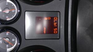

anywhere in the west mids that can do this?
[Image: sfa4ns.jpg]

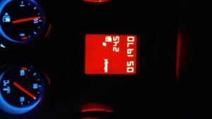

Is there a way to get just the trip on its own? I have the display type like in the first post.
Also what is aux menu display?
#54
(19:th-Jan-2017, 22:42:47)Badenj Wrote: Is there a way to get just the trip on its own? I have the display type like in the first post.
Yes it can be done.
Aux is meant to display if the AUX has something plugged in but it never worked on mine so turned it off.

#60
Just to let you know rusty I had already activated it lol
It came up as distance to destination which counts down till you reach zero.
But if you leave it as 0 it acts as the trip. Lol
