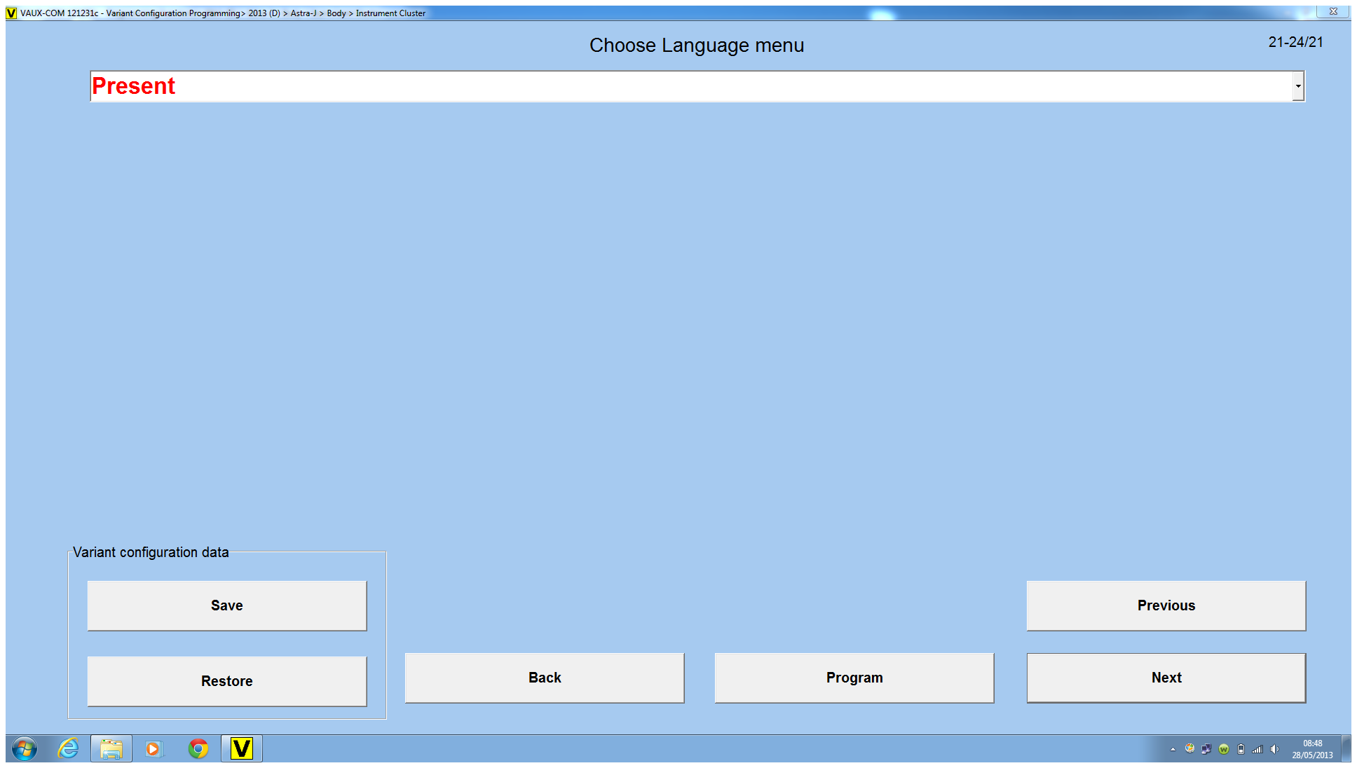

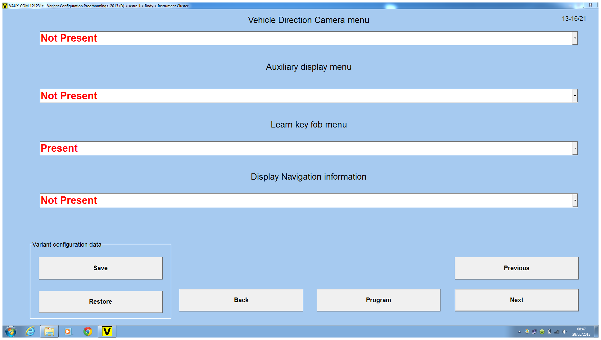

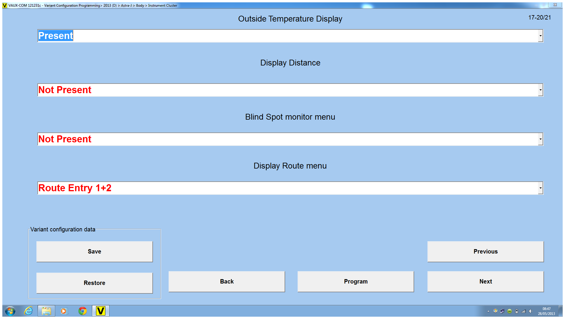

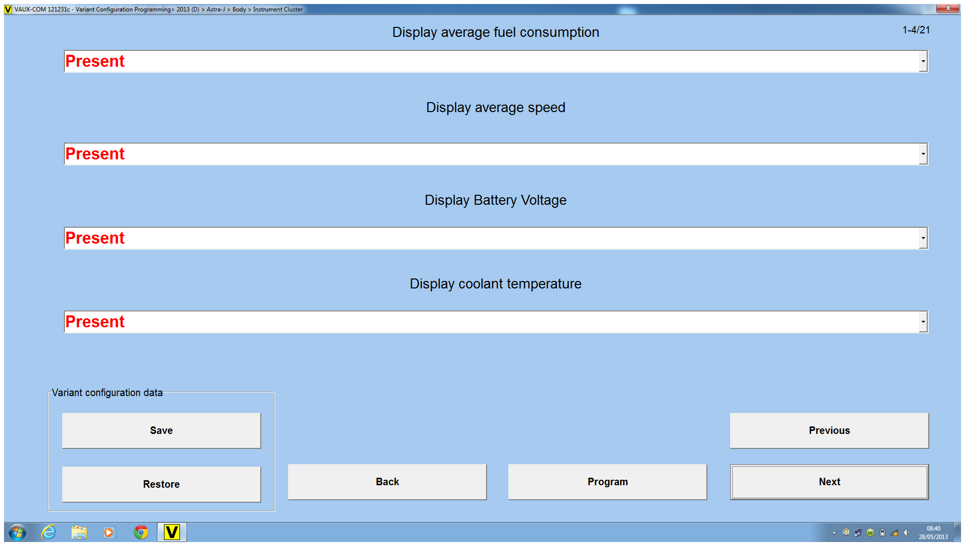

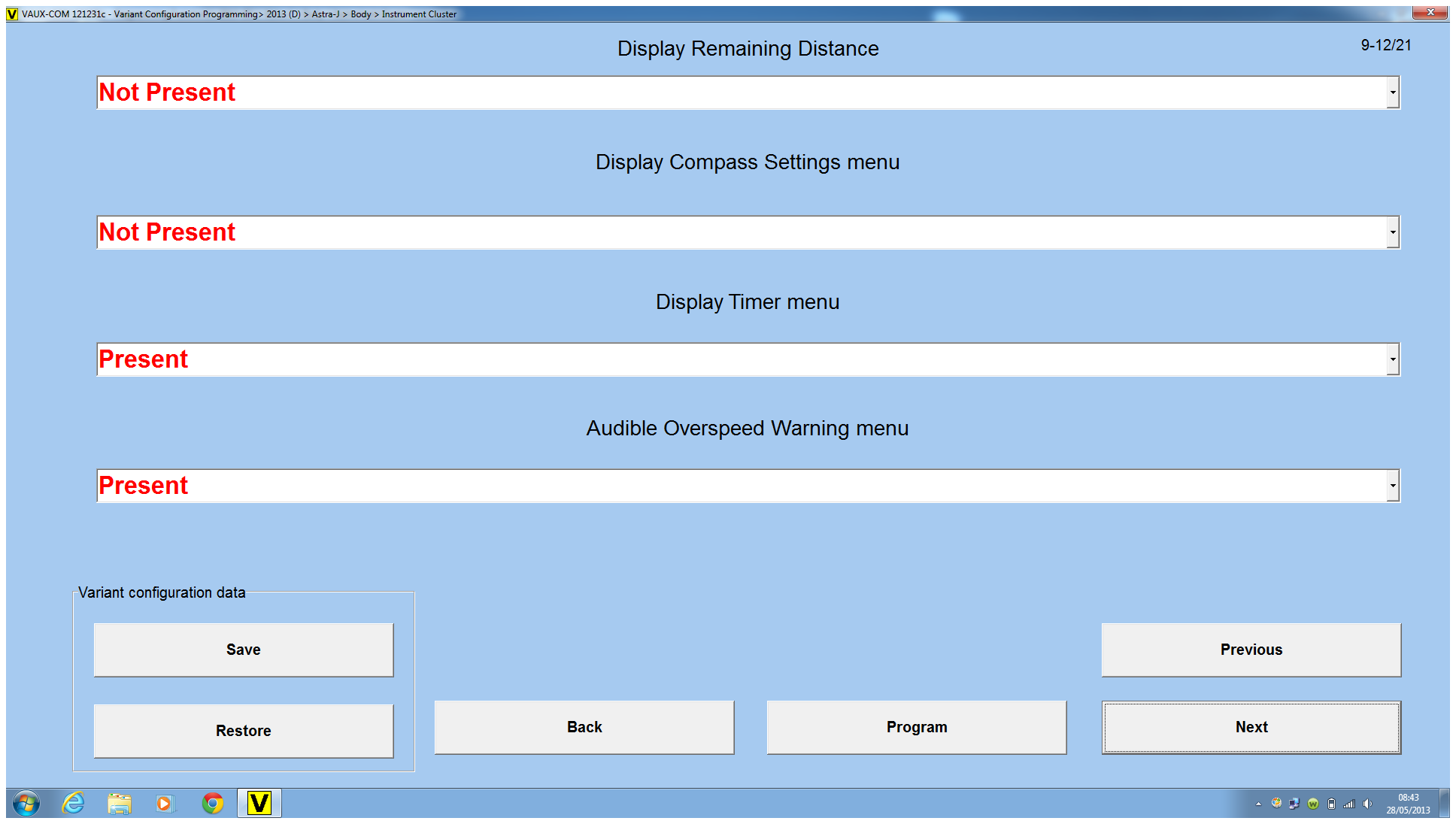

If you have or know someone with a Vaux-com it is much easier (I sold my Vaux-com)
[Image: hidden.png]
[Image: hidden1.png]
[Image: hidden2.png]
[Image: hidden3.png]
[Image: hidden4.png]
[Image: hidden5.png]

Hi!
I've the factory parking sensors (Rear and Back) on my J Sports Tourer.
It's possible to add the option that shows the distance between the car and the obstacle, like this?
[Image: opel_astra_sport_tourer5416273800947943846-1024x768.jpg]
That depends on what display you have.
If they are factory fitted you would have the correct config for your car already.
My display is like tucpal showed few replies above:
https://www.vxoc.org.uk/forum/showthread...2#pid10382
I think it's factory fitted because the beep sound is on the speakers and two different sounds, one for the front sensors and another for the rear sensors.
Strange. The factory ones show the distance display. Or mine does anyway
It could be that the UD7 hasn't been turned on on the IPC.
(22:nd-Jul-2016, 06:44:22)Rusty2009 Wrote: [ -> ]It could be that the UD7 hasn't been turned on on the IPC.
Maybe this could be a dumb question... but.... it's possible to enable that using OPCOM or something...?
Thanks?
(22:nd-Jul-2016, 10:54:06)Farrael Wrote: [ -> ]
Thanks?
MDI only to turn that option on.

Hi Guys,
Firstly, thanks to rusty for hooking my display up.
To clarify, i have the small display which only had millage and oil level.
Since Rusty turned on my options I now have:
Oil Level
Millage
Average Speed
Current (live) MPG
Average MPG
Thanks again,

also just a heads up when activating the hidden menus
avoid the compass setting it does nothing and by activating it
i lost my nav direction arrow menu
