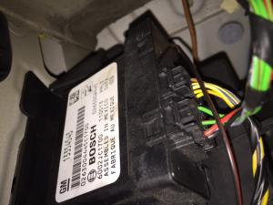

I've bought a PDC module for front and rear sensors on Ebay. GM number of this module is 13354532. The original module in my car is GM 13354543.
When i change the old module by the new one i get some faults on my display that there is something wrong with the PDC system. Probably because it needs to be programmed, but how? Opcom/vauxcom, Tech 2, MDI? And what are the steps to program it.
You shouldn't need to change the module.
The module will throw up errors as it's programmed to a different VIN and also the configuration is different.
MDI only programming.
Thank you! But I don't understand that de module not have to be changed.
My original pdc module only have 2 connections. My thougt i need a module whith 3 conections, but i don't?
What is the partnumber from your pdc module?
The partnumber from my module is 13354543 and has 2 connections.
(1:st-Dec-2016, 22:21:18)Rusty2009 Wrote: You shouldn't need to change the module.
But my module only have 2 connections. How do i connect the frontsensor loom to this module?
What is de partnumber from your pdc module?
I've never seen only a 2plug module there are all 3 plugs.
Here a picture from my 2plug module with partnumber 13354543
