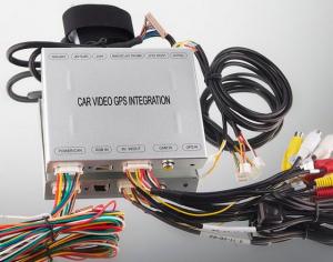

Like @Rusty2009 said stick with the CD500 and maybe consider to purchase a Video GPS integration box.

To Jerry:
Can i use such a device with some custom (user installable) navi program (with speeding cameras and other stuff) ?
I have to maybe use some rearview mirror that has an android OS integrated and reversing camera support. (if there is absolutely no other way)
The device have a built-in navigation module on Wince 6.0 system. I think you can install diferent navi sw.
But now you can also buy an Android version.
Ex.:
https://www.alibaba.com/product-detail/2...89943.html
Thanks Jerry.
This device is made espesially for 2014, 2015 year cars. My car is 2009 model. Will it work ? And there is mentioned some kind of touch screen - do i understand correctly that there is an extra touch screen bundled that can be installed in fron of the original screen ? (my original CD500 screen is 480x240 pixels)
Check pictures (touch screen) on this side
https://www.aliexpress.com/store/product...0.0.OBWTxI
This one looks promising. Only thing that's missing is Android OS. (Windows CE is a no-go)
Ideal for me would be a car video interface with reversing camera support, GPS, Android OS, wifi (for installing my own software) and touch screen that can be installed in front of the original screen. And it must be compatible with Insignia 2009 year model with CD500.
I have looked for such a device but no luck so far... - there are very many similar devices but each one has some missing property.
I fitted the interface box to the insignia nav 600 to get the reverse camera option
https://www.vxoc.org.uk/forum/Thread-Mul...ia-astra-j
it can also do other things like add dvd phone pc etc to it
but you need additional boxes adding to it.
so it can get over complicated and your glove box will have to store all the dvd boxs etc
now i did remove this from my car and install the factory rear camera as the interface box was interfering with the TPMS sensors
there is an external power box a small black box on the loom that was the issue i would recommend removing that black box
for that reason you can still make the rear camara work with out the loom from the main loom to the back of the navi you only really need the blue cable for that but as you want to have dvd etc added you would need to keep the black box and may have TPMS sensor loss issues unless you shield the black box to stop RF interference.
