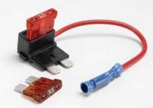

Maybe you should use fuse 6 or 7 and adapter:
Yep what Jerry said worked fine for me
I tapped into the rear of the 12v and when you have the key acc it works without issues.
