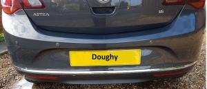

Got mine on today, was easier than i thought.
