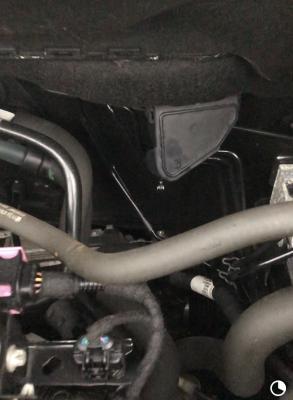

It could be just rain water.

I did think was it water that’s come from the scuttle panel and out from there.
But cos it had the pipes I wondered if it was a leak

I know the coolant bottles are prone to crack at the bottom around the bottom pipe. but you said it's clear water with no smell.

Yeah definately clear with no smell

Your photo is showing the drain for the scuttle area. Perfectly normal for water to pee out of there when it's raining. Just make sure to keep it clear and not let it block up. It's a much better design than Vauxhall used to have.
There are also drainage areas at the rear of the front wings. You should see water peeing out by the sills.

Yeah notice the sills drips especially when car driven off.
