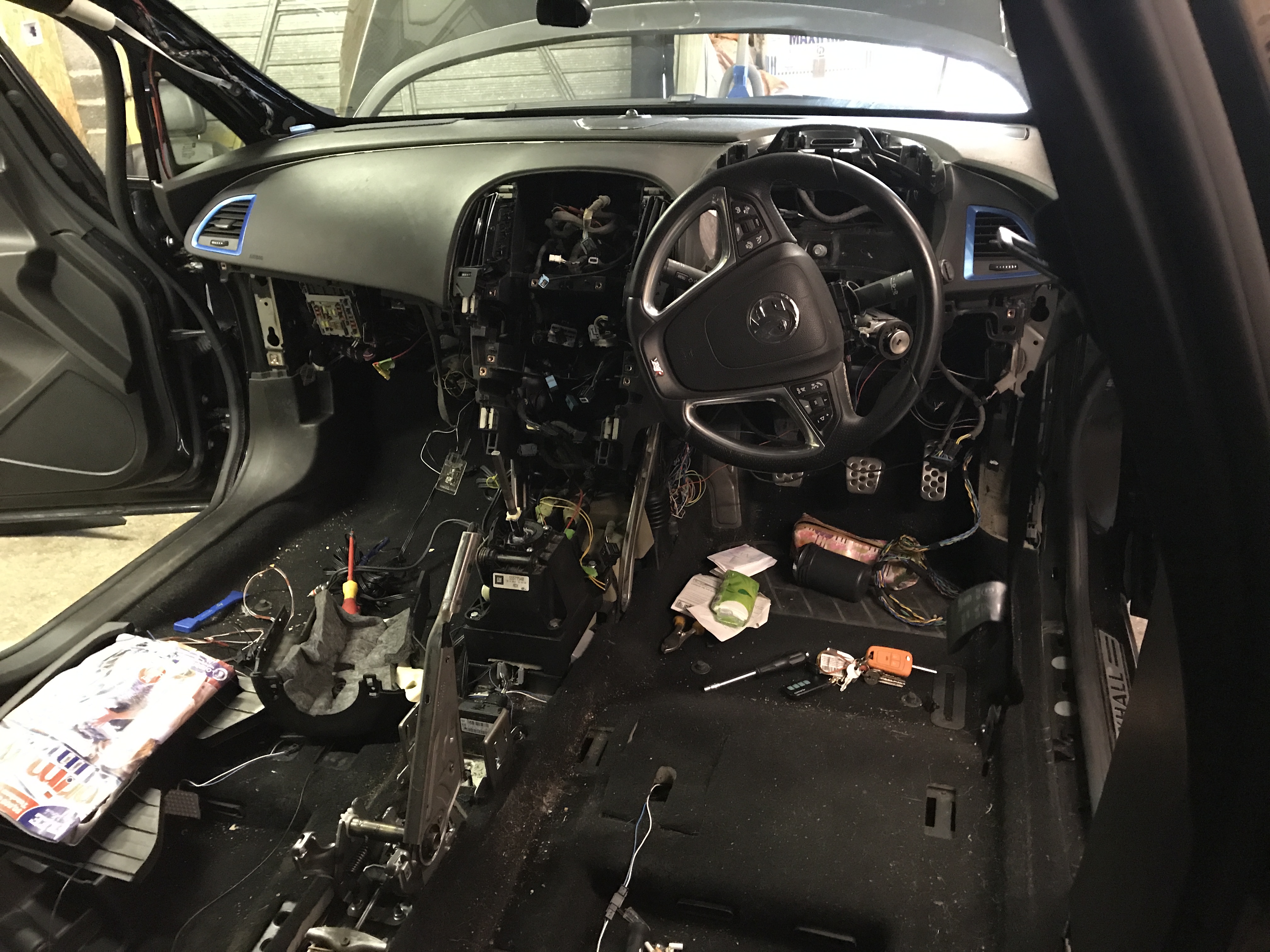

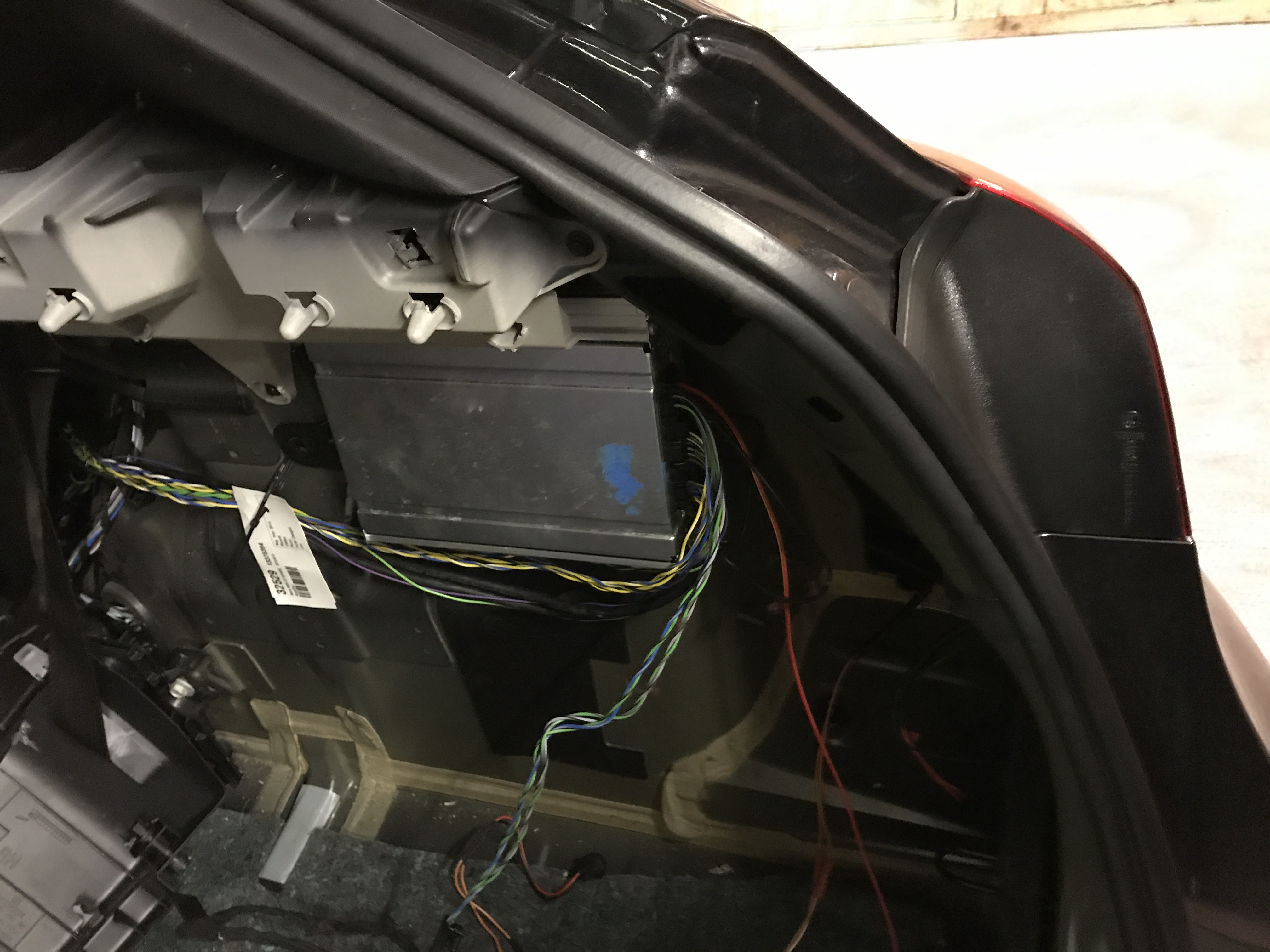

Sub wiring I can help you as my car is in bits as I remove the AMP wiring.
I'll grab some pics for you.

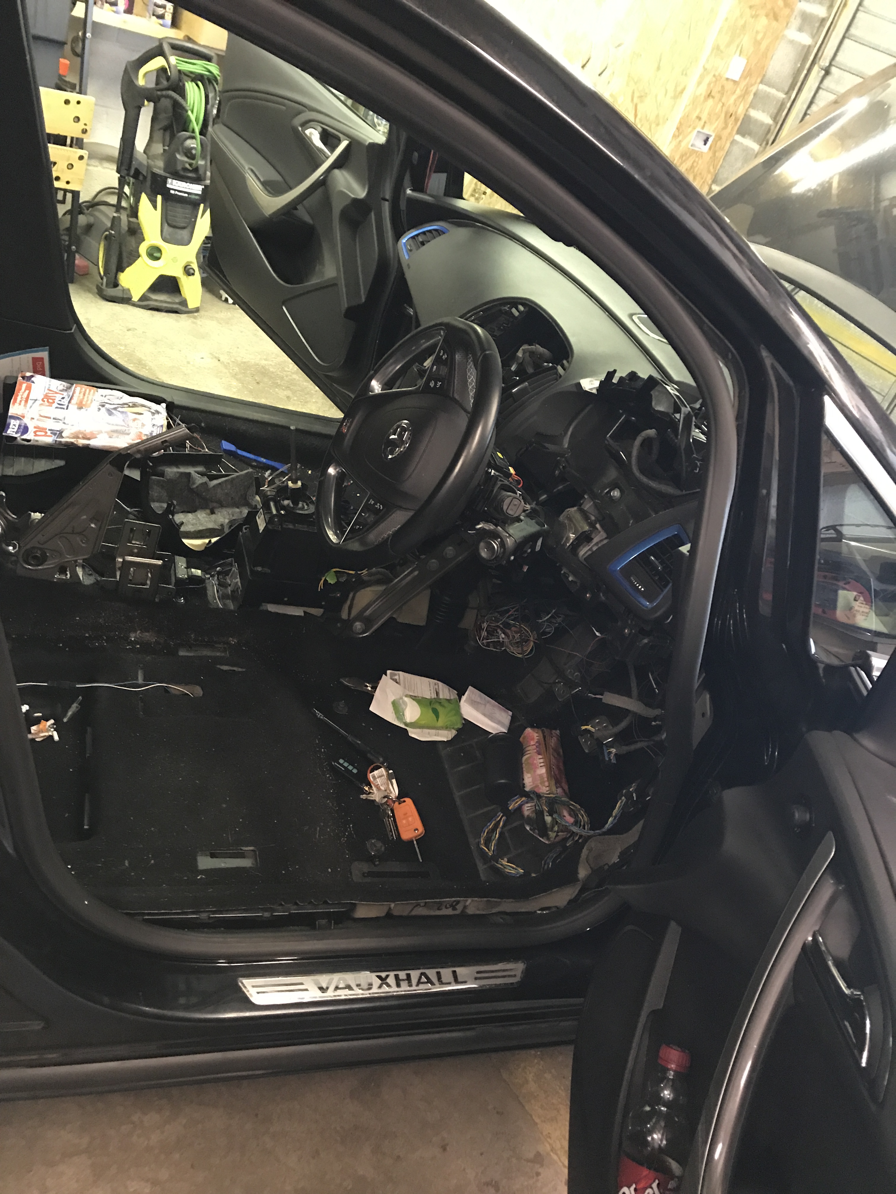

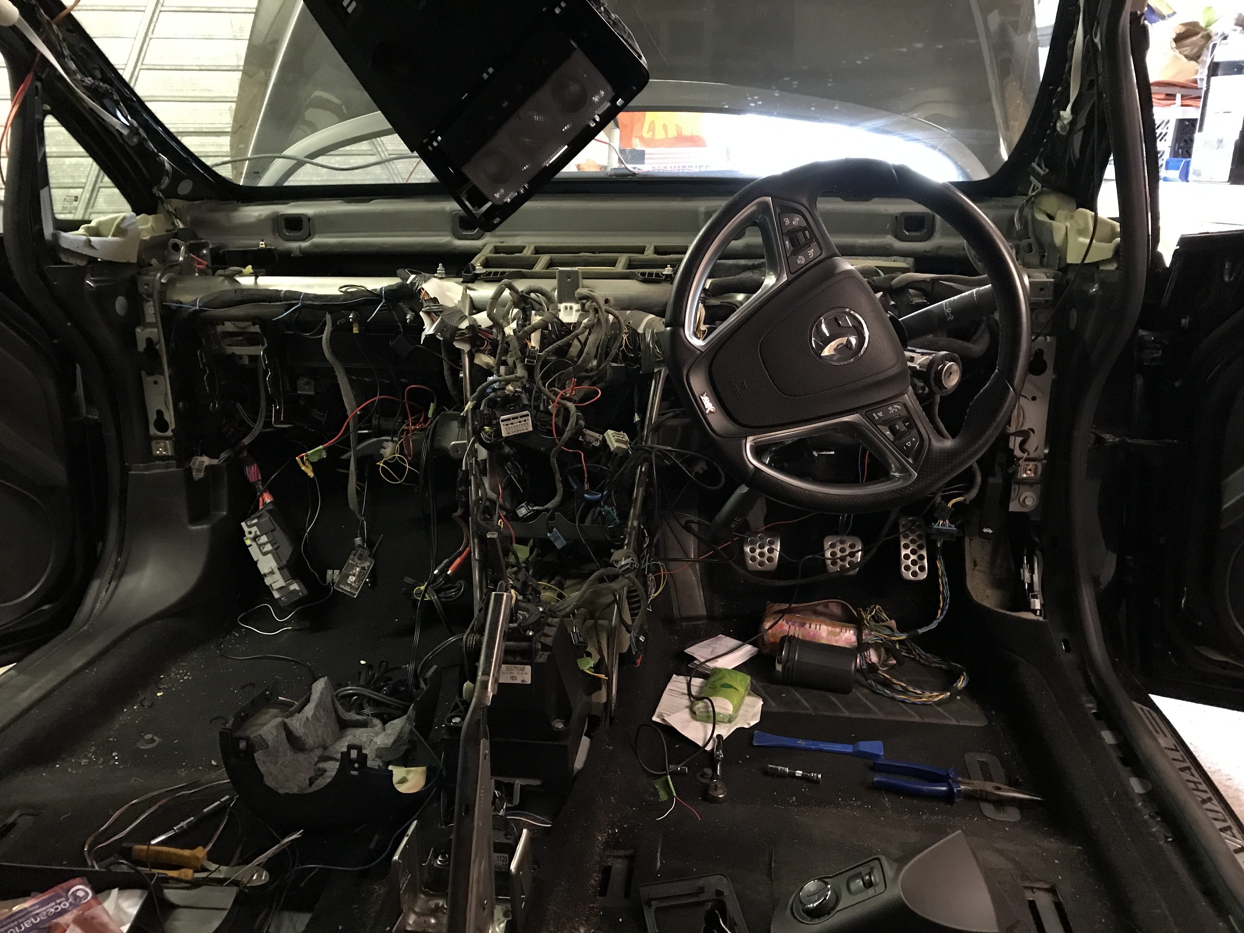

Mine I'm installing the infinity sound system got the dash out etc as I need to make all the wiring changes.

Need to run all new wires from the radio plug to AMP.
Then from the AMP to the speakers.
Once that's done swap speakers for the better quality ones.
