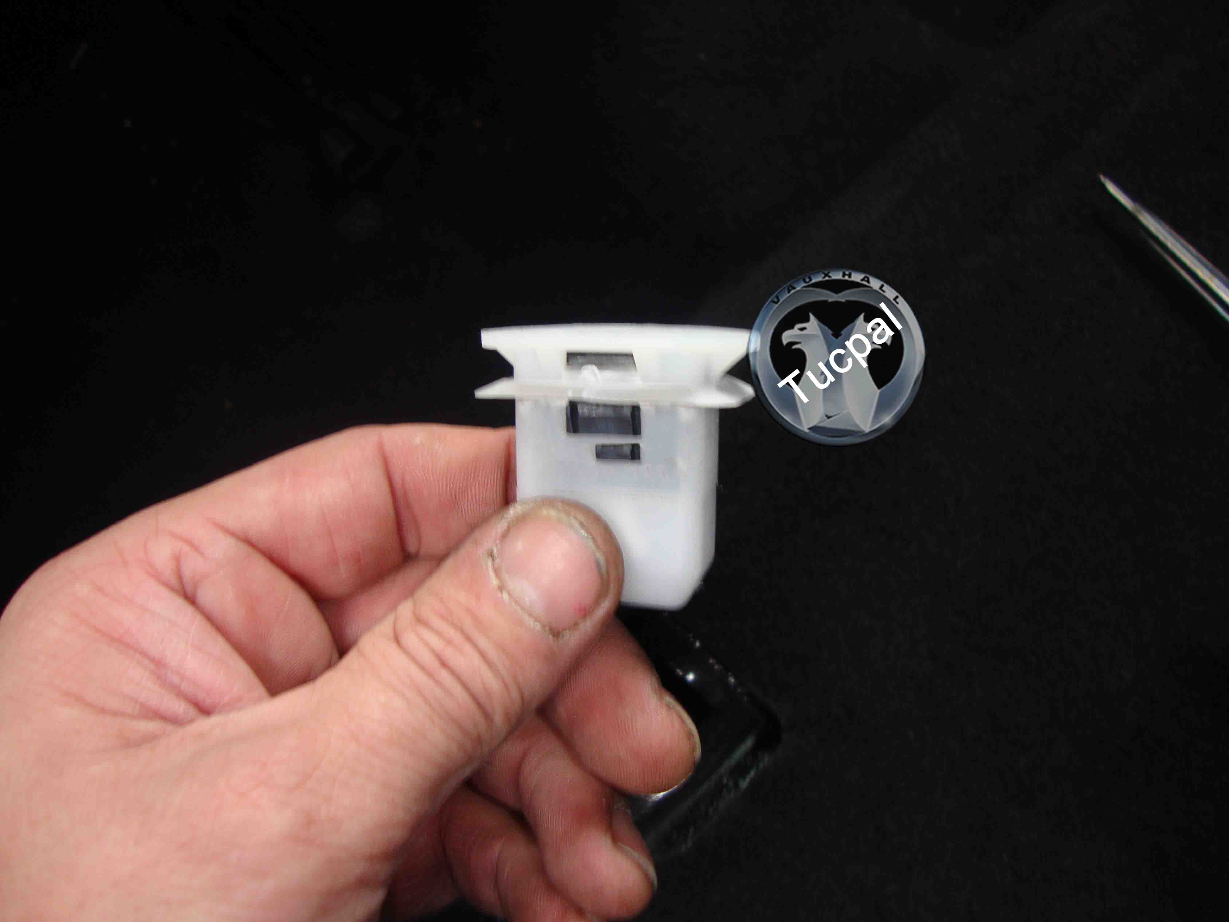

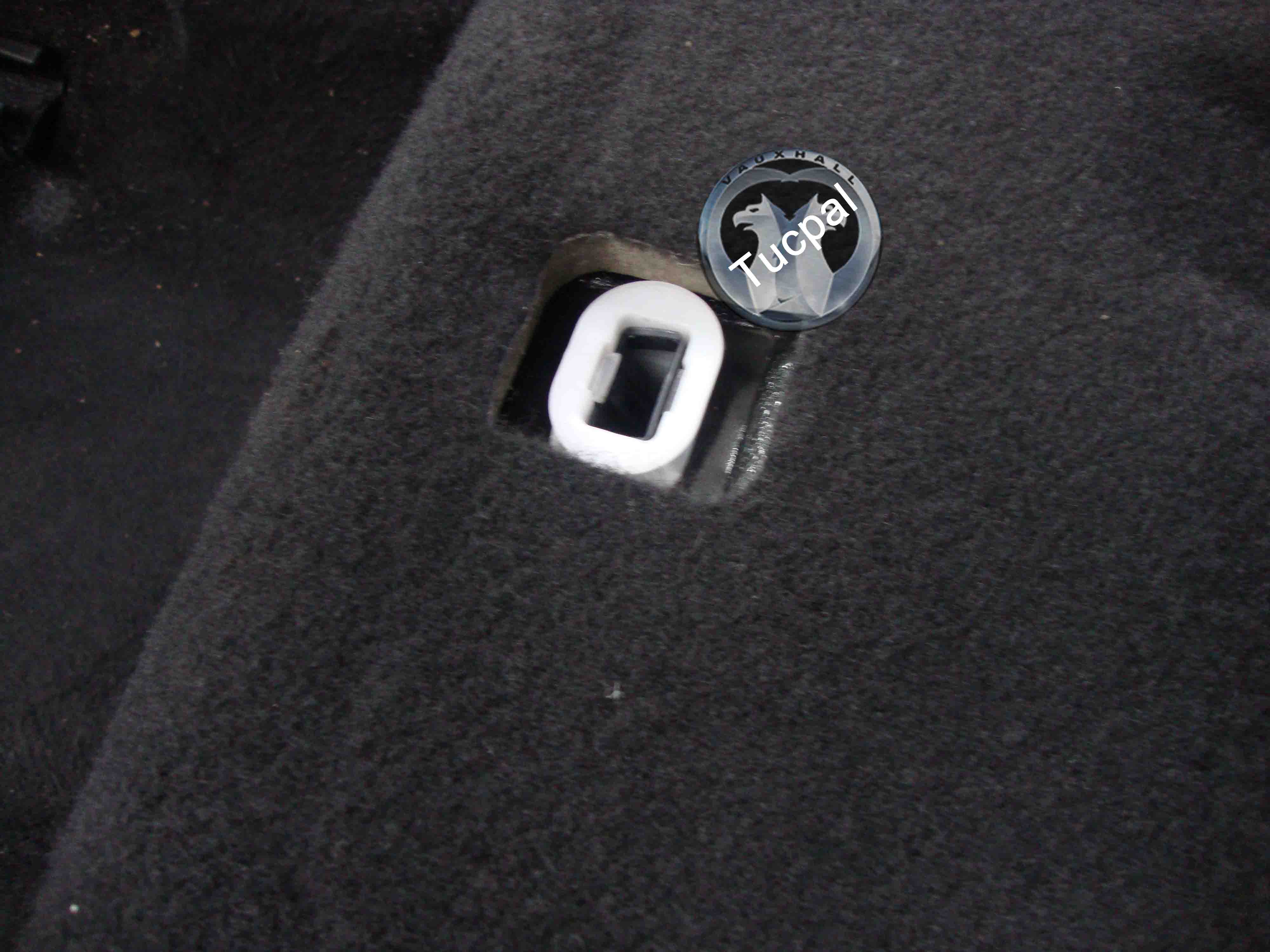

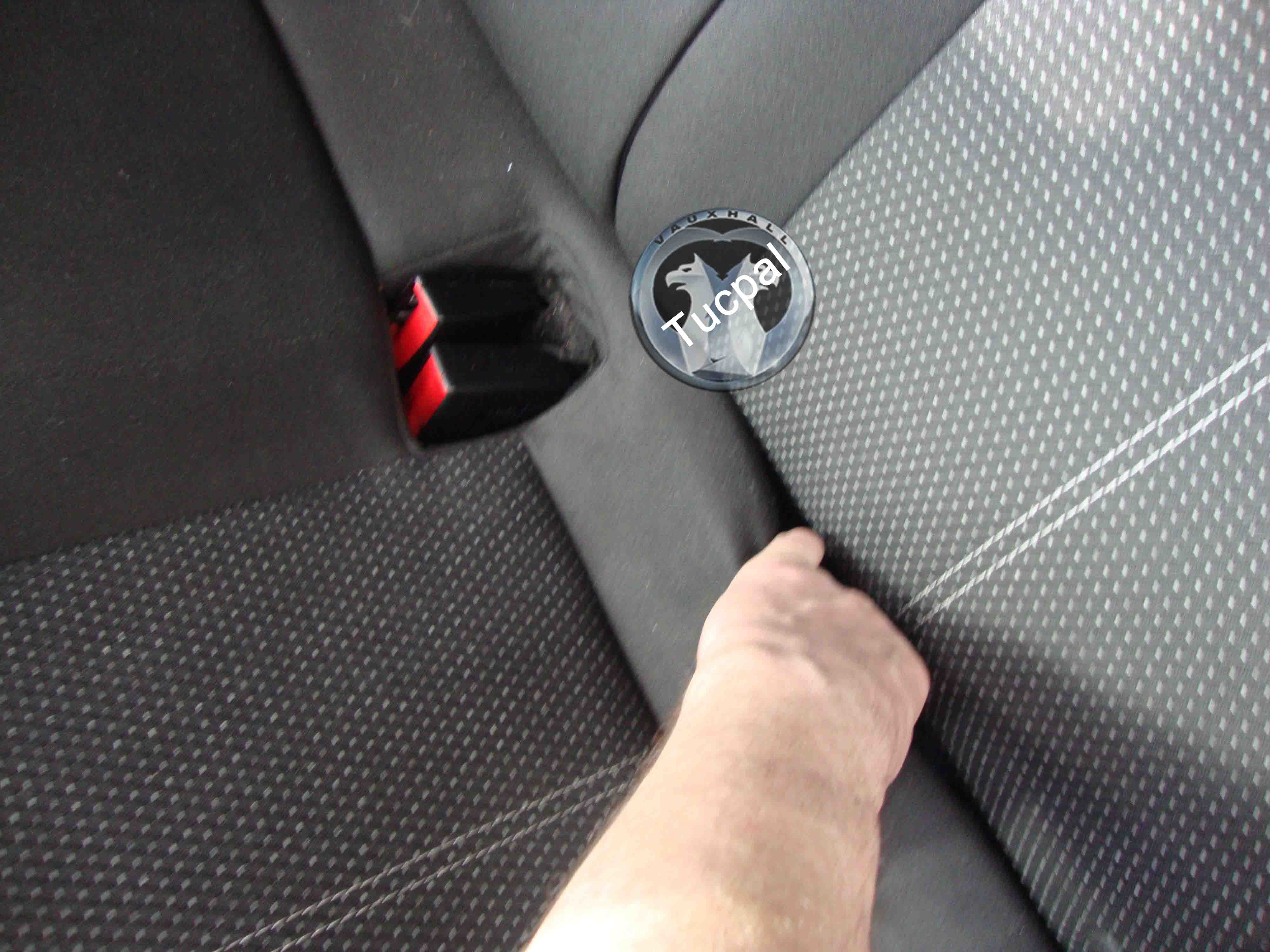

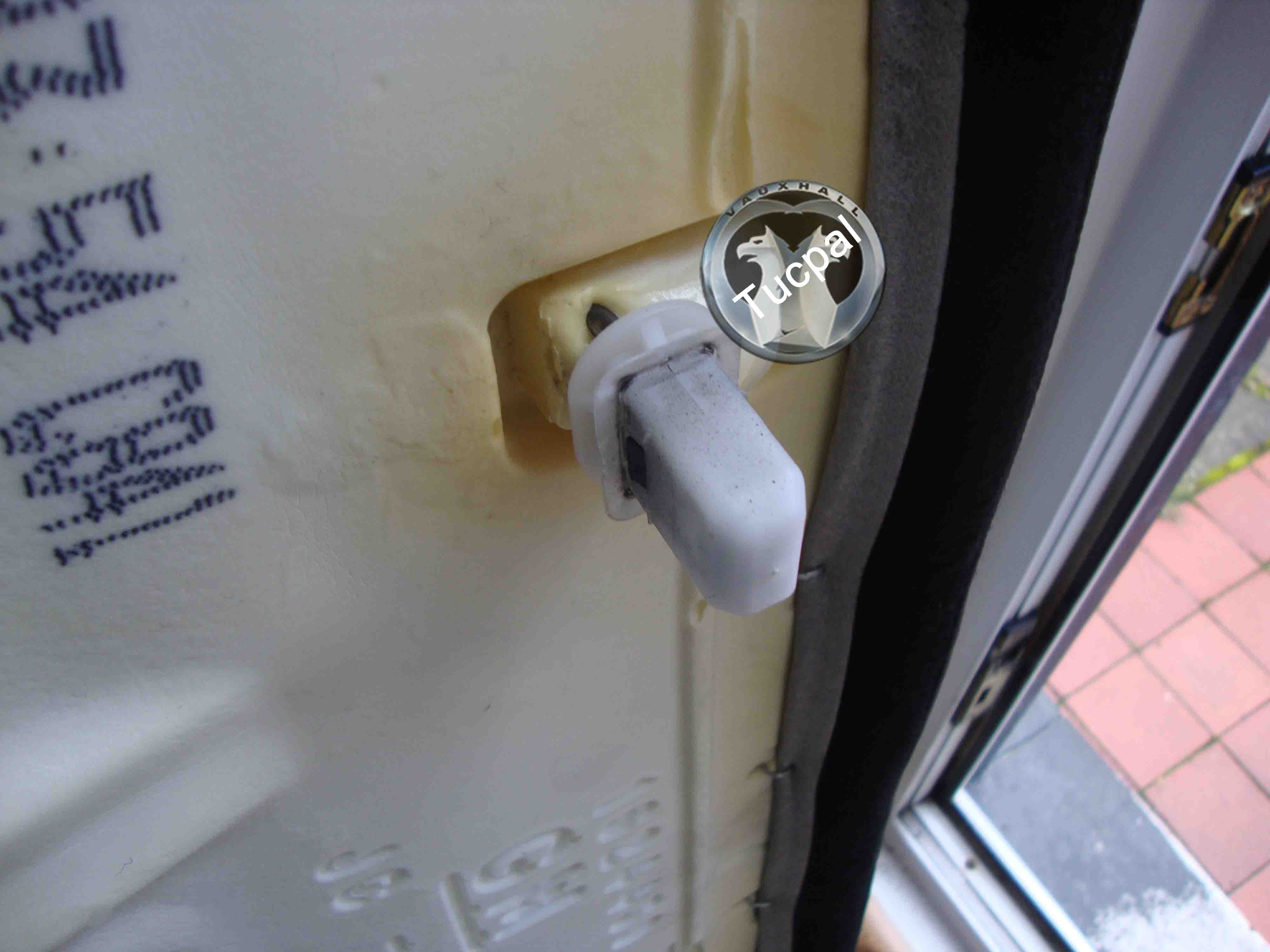

look at these pictures from the how to
see the white plastic cap they need to be pushed onto the black metal clips
on the bench first before the lower bench is put back in place
and then clip the bench back in to the holes

when you take the lower bench out they tend to stay in the holes
then they need to be removed from the holes and put back on the clips on the seat

You need both parts and both must be on the metal U clip before you fix the seat back down, the above part number has the white and black part.

you are going to have to push real hard to get the new ones back on the metal hooks
then when they are on the hooks then fit the rear seat and push the seat down above were the caps are so they go in the hole
