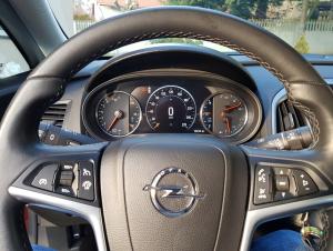

Hi did anyone actually manage to use the insignia cluster on the Astra J?
@Jpbroad1970 & I have made some progress.

We hae got as far as power up & trying to get all the steering wheel controls working.
(15:th-Aug-2018, 14:49:19)Roksab Wrote: @Rusty2009
for that small lcd IPC you don't need steering wheel comands from Insignia, you can use left stick....
We have tried to use left stork but it won't do anything. everything else works off the Astra controls.
With the insignia controls we can cycle the menus and set speed limiter and and c/c but can't control Radio (most likely need the HMI module).

Guys why don't you create interface between LIN bus and Astra's buttons using ADC? It is very simple. I did it and it works ok.
https://youtu.be/jATZ0IdqApc
(8:th-Nov-2020, 12:16:17)zaapp Wrote: Guys why don't you create interface between LIN bus and Astra's buttons using ADC? It is very simple. I did it and it works ok.

Other things was realised as usuall. Only IPC navigation buttons are remaped.
@zaapp Can you tell us more? Is the new cluster fully functional? Any bugs?
(9:th-Nov-2020, 13:29:09)DNT Wrote: @zaapp Can you tell us more? Is the new cluster fully functional? Any bugs?
As you saw on video it is fully functional. It is same as red display but with some colours

Every cluster change involves you to change VIN, PIN and IMMO bytes (last one is needed to disable immobiliser DTC).
You can use Arduino and MCP2515 like me or Canny from last Your post . Now i am looking for CAN gateway and i will be able to enable properly working oil temp gauge.

I've done something for now. Connected plus, plus after key, ground, and kan highway high speed. The board works, but not completely. I don't understand people who keep such secrets to themselves ...
(19:th-Dec-2020, 19:51:51)Milos1989 Wrote: I've done something for now. Connected plus, plus after key, ground, and kan highway high speed. The board works, but not completely. I don't understand people who keep such secrets to themselves ...
So did you use an MDI tool to program the new board?

I changed the vin number, pin code in the eprom. kilometers taken from bcm alone. i don't think it's that hard to solve the board.
maybe if someone else would bring out some details it would be nice.
I downloaded the eprom, used carprog to read it and changed the chassis number and pin code
