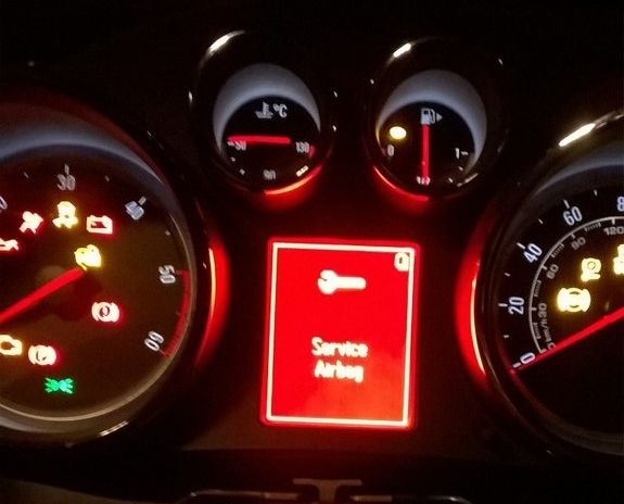

And i guess the last car had a few faults, as it's showing :
[Image: edb8fd4b-9583-48d0-94cc-2e7479506f56.jpg~original]
As well as service park assist (that'll be it not detecting a park assist module in my car) and one other, it's got the engine trouble light on all the time and the air bag fault light.
Then i get the expected 'washer fluid and coolant low... i want to add those sensors, not sure if they will be plug and play on the meriva tho.

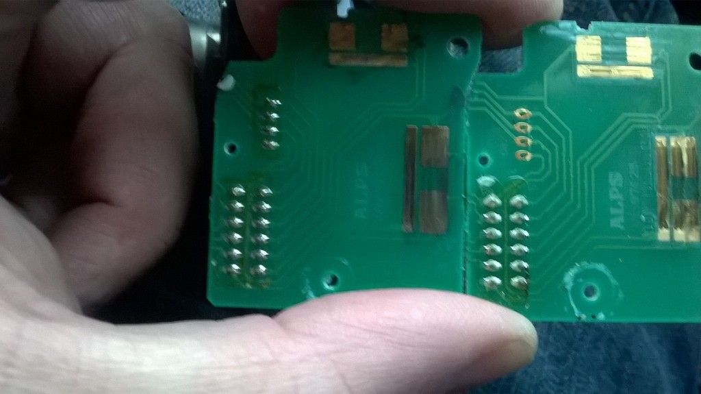

Figured out i will need to add extra wires, compared the pcb of the 2 stalks, the one with extra buttons has another 4 connectors (one shares what i presume to be the common power)

Now... do these extra wires go to the IPC connector.. if so, what pins go where
This is the stalks plug, i've marked where the 3 extra wires need to be
[Image: DIC%20stalk%20wires%20to%20be%20added.jpg~original]
Where do they terminate at the other end of the wires??
Am i right in thinking the wiring i need goes to the IPC plug? i've been reading that the washer and coolant low switches are conected to the ipc plug (because people bridge them out to turn the warnings off.. that's what i'd do for now, till i am back home with access to more tools to retro fit the sensors)
and seeing other IPC plugs they seem to have more wires in them... mine only has 8 wires to it.
I've put my original ipc back in for now, and i miss the big screen already.... i played with the vaux-com reading the display options on the ipc, tried changing one option and it refused to program, but i then pressed program with no changes made... it said it programmed... and now i've lost the white cruise control light, asr off and that on the 'new' ipc... tho the display said asr off and on, just the lights in the gauges get disabled by the damn vaux-com.
The level sensors go to the IPC but I think the stalk will go to the BCM I'll have a look.
Ok so you need to add the following wire from stalk to IPC.
Stalk pin 5 to IPC pin 28 wire 0.35 VT/YE
Stalk pin 6 to IPC pin 9 wire 0.35 BK/WH
Stalk pin 12 to IPC pin 10 wire 0.35 GN/WH

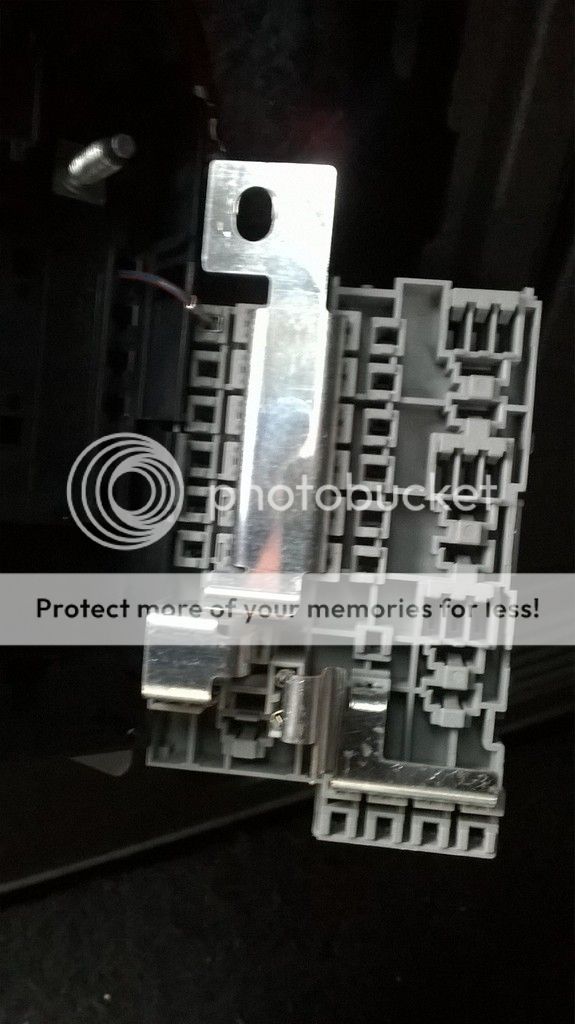

Meriva's header tank is like this:
http://ecat24.com/opel/images/Opel/S10/F/40.jpg
There's a fuse or relay bank directly under the front of it.. it sits behind the battery, i recall an issue where these tanks leak and bugger the electrics below it, so i'm not sure i'll try and fit a low level sensor to the tank by drilling a hole and that... especially as they go through the bottom.
I seem to have an almost empty REC in this car....

The meriva the rear fuse box is just that.. can add extra fuse takeoff pins to it, no electronics in it at all... and the trailer interface just needs the gmlan learning it's there.. to allow communication and do the rear fog lamp cut off when trailer connected (tho that is a german law requirment)... oh and the parking sensors need telling there';s a towbar, and the rear sensors de-activate automatically then trailer is connected (sensing the lights on the gmlan from what i can see in the diagram rather than using a switch in the 13 pin socket)

Well.. i'll admit that i've screwed up, i got impatient and tried to manually de-solder the eeprom from the KPH IPC i bought from a european meriva (as uplevel meriva B ipc's seem rare as hens teeth in the uk)
and in the process i lost pin 7 (or pin 2) so i couldnt get a dump of it's contents and had a dead ipc.
So when my hot air rework station arrived a few days later i popped the eeprom off the original IPC with the low level display and put it on the uplevel euro ipc to see what would happen.
hot air is so nice to work with for this kind of thing... tho a surface mount tweezer soldering iron would be handy for the led's, as it's easy to burn them with the hot air (kapton tape ordered)
I was surprised the IPC started up... gauges all work, but i get so many menu's... like:
[Image: Main_options.jpg]
i believe the IPC thinks its now a petrol one, as i dont have the glow plug light anymore (it is a diesels ipc, and glow light worked before i destroyed it's eeprom) but notice the 'bio-power' meter for E85 bio-ethanol.
Battery level as a percentage? some things i get no readings for due to missing sensors i guess, but not sure why battery level wont show, tho it's usually voltage rather than percentage.
I also have to press the cancel button 8 times on starting the car, as i get these warnings:
[Image: Startup.jpg]
Some items i will fit the parts for... but 4x4 i doubt will ever make it to my list of mods Big grin
oh, and airbag is i believe a stored setting in the IPC, there's 100% nothing wrong with mine, but the insignia's ipc did the same, and both IPC's are from crashed cars... i do only have 2 DTC's now tho, for security code not set in the ipc and bcm, so im hoping that when i can set them i can clear the airbag warning indicator and engine trouble light thats on.
