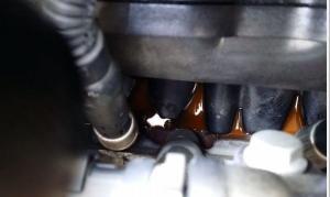

Yes a new set of o rings sorted it out. Before the fix I would get seepage from the bit that sticks up to align the o ring. They can do the job without removing the cam belt. Its fiddly but can be done. Ill see if I can find my photos of the leak.
2nd picture is where the coolant used to sit. O ring on the far left was the culprit but they replaced the lot.
