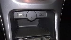

i've just finished another work on the infotainment/connectivity side: just added 3 usb ports.
My car hadn't got the USB front connection, so after fitting the M072 i decided to install it. You can see the plastic a bit "ill cut"  Looney. But it works nicely!
At the back, i've replaced the lighter by two USB ports. Here are the pics:
Next to come: led DRLs, but that doesn't belong to this topic.
