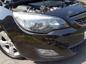

Need some info on resealing the headlight back up after installing my projector lens and hid kid do I use the silicone form or double sided thanks
Have a look at the how-to Tucpal did as that will give a link for what he used.
Have a look at this thread
https://www.vxoc.org.uk/forum/Thread-Pro...a-j-5-door
this is the stuff
http://www.ebay.co.uk/itm/BOLT-ON-PANEL-...xy4dNS1~Sy
or you can use this stuff also probably do the job better
http://www.ebay.co.uk/itm/Windscreen-Sea...SwGvhT5f5W
but i would fit the lights to the car and do the light aliment first before you reseal them
makes life alot easier
(31:st-May-2016, 12:13:07)kyle-astra-j Wrote: Need some info on resealing the headlight back up after installing my projector lens and hid kid do I use the silicone form or double sided thanks
How did you get your headlight apart? using the oven at [x] temp for [x] minutes, did it have staples as in tucpals tut, how did you get around the staples. I was going to buy an old second hand unit off eBay and have a practice to see if it was worth the hassle.
Contact @nemo his old ones may be for sale
you have to cut them open as the seal vauxhall use will not come apart with heat
have a look at the how to
I believe most after market headlights use butyl which is more pliable and easier to remove compared to original factory headlights which tend to use permaseal which is much tougher to remove as it's stiffer and needs to be put in the oven a number of times.
How did you get the headlight apart... oven or dremil etc
Very nice glad you got it all done
Dremel didn't cut the top part
