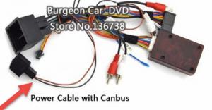

Anyway was just looking at the loom that comes with the unit, it has a box inline which says Envision for 2015? also a plug which says door alarm? just trying to work this out so I know where I'm at when fitting, if anyone can tell me what these are about? my car is a 2012!
Cheers Ronnie

It looks like the door alarm wires go to the speaker in the kit

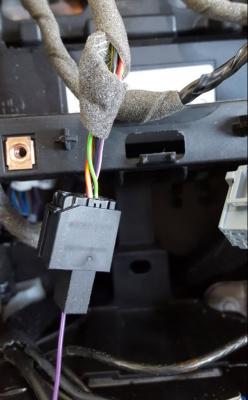

Does anyone know where the green and black wire plug in this pic goes?
Also I see there are 2 mic jacks one on the screen and one on the DVD unit, I guess the bluetooth mic goes to the DVD unit?
Cheers Ronnie
The plug (green/black wire) goes into the spare connector that is left over from the factory screen!

Yeah I missed that one when I plugged it all in, I only realised and it's for the radio controls lol.
Haha. I did the same first time out. Had it all back together but none of the controls worked.
Yeah that's what happened to me too. Once you know how it only take minutes to take it sort again lol

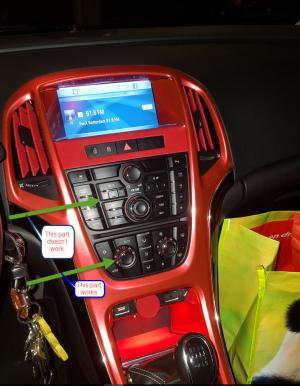

I thought you could maybe know this problem what I have whit my Android radio. I bought this model:
http://www.aliexpress.com/item/Android-4...49594.html
Im trying to replace my CD500 radio unit in my Astra J whit this Android. Normally its a replacement for a CD400 model but the fitting is the same like a CD500 model. After I installed the radio I saw a little problem. My middle console (see picture) did not power up so I was not able to use those buttons. The rest of the functinality was working fine like climate control, park sensor, door detection etc..
I think there must be a little difference in the wiring diagram of a CD400 model comparing whit a CD500 model. I think that it could be the original backplate connector of the screen, there goes one purple wire from the CANBUS to that connector. I saw on the pics from your link that there goes two wires to that connection (green and black).
The mine looks like this:
So is there anyway to power up the middle console whit that Android radio? If there is anyone whit a great idea please let me know otherwise I'm afraid that I need to send it back the.
Kind Regards
Amir Khezri

Yes that spare plug from the old screen should work so yes there might be a slight difference in the wiring for the cd 500 unit. Not sure what to suggest through.

I had this problem, one plug from back if screen fits in to that part. I missed it at first but when I looked a second time I realised and it powers the buttons!
Can you maybe more specific about that connection, as far as I know i didn't had any connectors left for that see picture.
I think I'm missing more cable's for that connectors what powers up the console.
I think thats the connector what you mean right? Thats the one what comes from the back of original screen.
(8:th-May-2016, 21:41:33)Amir Khezri Wrote:
(8:th-May-2016, 18:14:20)Tonto Wrote:
(6:th-May-2016, 00:23:50)Amir Khezri Wrote: Hi Sheppy,
Kind Regards
Amir Khezri
The plug that the old screen plugs into is on the main wiring loom.(centre top black plug next to the speaker
[Image: 5265db5e88e7d0e7b23398edb48e3a16.jpg]

Hi Tonto,
Thank for the reply I thought also that it must be there somewere for the middle console. Can you maybe tell me were the green and the black wires go from that connector
(red arrow)? I have the same CANBUS like you only one difference in wiring I guess see pic here below:
Like your can see I have only purple wire going there to my backscreen connector. And on your pic there were one black and one green one. Maybe if I can see how to connect that connector then I will be there and the middle console will power up and then me happy :-).

Which unit is that wiring harness from? It looks almost the same but not quite.
Oh I'm not sure then mate, why unit is that for?
Without pulling it out I can't remember properly mate, sorry.
