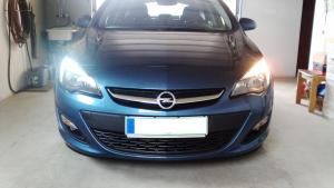

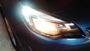

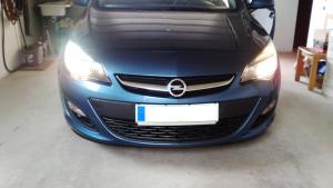

To share some pictures
Before I fitted factory LED DRL headlamps I tried with China LEDs.
Link:
http://www.aliexpress.com/item/7443-7440...7781abd522
LED vs. Halogen
SideLight
Poslano z uporabo Tapatalk
(19:th-Feb-2016, 07:23:48)Jerry Wrote: To share some pictures
Link:
LED vs. Halogen
SideLight
Did they dim when you turned on the sidelights?
Yes, but in my opinion not enough.
With main beam they are still to bright. I think.
Smile
You can estimate yourself.

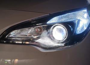

For almost a year I use bulbs 5x Led Cree. On the left and on the right Cree light bulb with a blue filter similar to PIAA.
[Image: 3b185f9fddc49aa3gen.jpg?t=1458507059]
[Image: 64e5b4c851decf3agen.jpg?t=1458507075]

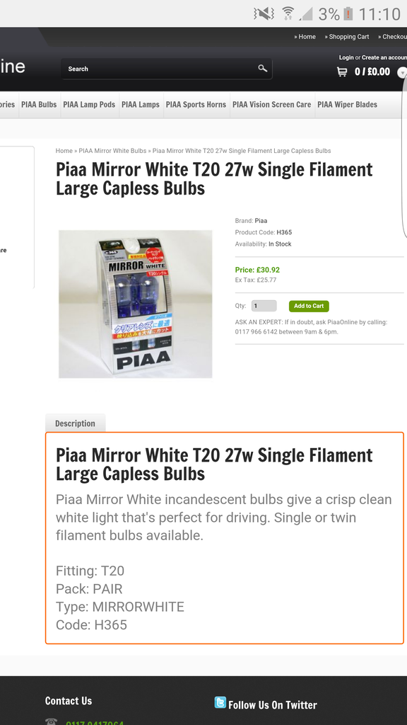

Recently bought these:
https://rover.ebay.com/rover/0/0/0?mpre=...2022372933
Can’t fault them
