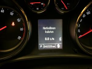

Hi Mates,
I changed the leds of the uplevel display in my speedometer, but just have a look
[ATTACH=CONFIG]193[/ATTACH]
I have made an instruction in how to disassemble the speedo, but only in german, you can find it here: KLICK
that looks alot better i like that
That looks much better been wondering what colour to do mine think White looks really good
Looks great, can you do this to the cd400 screen??

I want to change the colour of the dial surround from white to Red or Blue.

I did mine last night and it turned out really good. Pic with phone so colors are not 100% to naked eye colors are solid black and white.
[ATTACH=CONFIG]389[/ATTACH]
On my way home i noticed my rev counter doesn't go past 2k and sometimes stays at 0. Hope it's just a bad connection. Also when you desolder old led's be careful not to lift pads. Led's have large contacts so they need to be heated up properly.

your solder iron should not have more than 350°C, just give the led on the board some solder on both pins.
If done, just heat both pins at the same time with a little more solder so you can move it with the solder iron simply away.
After that just clean the pads.
For the rev counter it sounds like you put it too tight to the ground plate. Check the gap there, must be around 2-3mm.
Yeah need to check that also, it's a pain to remove whole speedo again
Just takes 5min. to get it out ;-)
