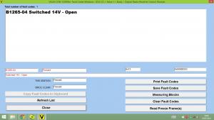

Guys..... I need help!
I took a trip to ***** yesterday to have my DAB programmed to which it was successful however DAB wont show in the radio display because there is a error code stored in the car indicating that there is no power going to the aerial. I've checked my cabling and all seems ok, so i'm literally as a loose end as to what to do next.
***** said sort the power issue and the DAB will appear. The aerial is wired into the front power socket via the purple cable.
#96
if this is with rusty,s aerial sure he will be along to help
#97
Does the 12v socket work?
Just thinking you might of blown the fuse when hooking up the aerial.
Although I had issues with Lewis's I really can't it being the Aerial as the DAB module wouldn't be picking that up anyway, I would say it's more the DAB module.
Have a look at this
http://workshop-manuals.com/vauxhall/ast...dtc_b1265/
#98
Yeah I plugged my car charger in and it started charging my phone so it's ok on that front.... I think.
I plugged the original aerial in but the error code didn't clear. What issues did you have with Lewis's?
(16:th-Jul-2015, 21:08:44)bhalay207 Wrote: Yeah I plugged my car charger in and it started charging my phone so it's ok on that front.... I think.
According to ***** it needs to pick up power from the aerial amplifier to work.
#99
No it doesn't as Lewis's has used an aftermarket aerial and we had no problems.
Have a look at the link I posted I my post above.
Could the cable be took long? Although that said you wired into the cigarette lighter aswell didn't you?
