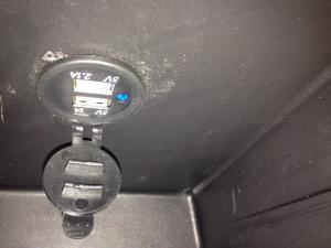

This is what I used, I drilled a hole in the top of glove box for it.

Also @Rusty2009 do you have any photos of where you drilled the hole in the glove compartment? Wouldn't mind doing that with mine as I'm after wiring another USB cable in for my phone...Taking it you just used one of the standard circle drilling drill bits?

I'll get you pic later mate when I go out, I used a holesaw to drill it but I still had to make it bigger using a file.

Here's the pic.
Perfect! I'd still be able to run a micro USB cable up to the roof lining if it was plugged into one of those two plus if I did it like you have wouldn't I? I mean the cable doesn't need to be ran behind the glove compartment or anything does it?
