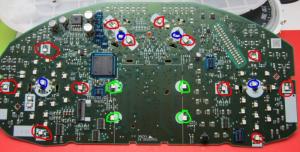

Iam not Rusty (edit: Iam too slow haha), but I can answer your question ;-)
These are PLCC-4
[ATTACH=CONFIG]341[/ATTACH]
Blue circled is for the arrows
Green circled is for the lcd
Red circled is for the dials

Jens the greens are PLCC-2 aren't they?
i got the SMD today Plcc 2 and Plcc 4 so i will have the correct one ether way
