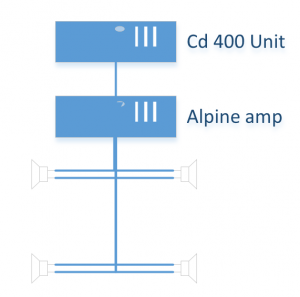

Great how to! So you connected both L and R channels to your sub? Installing an amplifier should be your next how to

Hi guys would anyone be able to put up a how to on how to wire the amp to the head unit not 100% sure on the leads and wire routings.
(20:th-May-2015, 13:41:32)Hashtagkegs Wrote: Hi guys would anyone be able to put up a how to on how to wire the amp to the head unit not 100% sure on the leads and wire routings.
it's in the first post mate for the speaker wires into the box then RCA cables come out and run to the AMP.
The RCA cables I ran mine under the centre console and then under the back seat into the boot.
The power runs from the battery through the firewall and along the passenger side kick panel then up into the boot.
The wake up you can come off the back of the 12v socket and run it along with the power cable.
Ground stays in boot area.
I then ran all new speaker wire from amp to doors.
