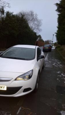

Thanks for this, here is a pic of the finished thing. Next is roof and rear bumper insert, unless I can get hold of the styling kit insert.
Looks good mate.
well done good job
