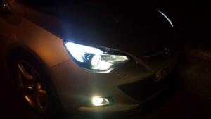

Hi just fitted 9012 bulbs from lushlighting which look white and look a lot better , But my Automatic Headlights dont work now any one else had this problem please cheers Clive

Tried that and YES it works again thanks a lot !! Next question brought LED number plate lights and they come with a resister I think to stop any error codes they say put them away from the bumper etc because it gets hot . But the all plastic any idea what to do with them I now it sounds silly but should I put some electricians tape round it ? Thanks again I am getting to old for this modding lark
Just need fog lights doing 😀
they look very nice
