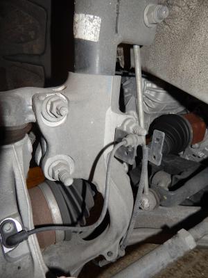

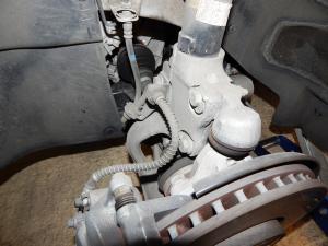

Some pics taken today
[ATTACH=CONFIG]65[/ATTACH]
[ATTACH=CONFIG]66[/ATTACH]
[ATTACH=CONFIG]67[/ATTACH]
[ATTACH=CONFIG]68[/ATTACH]
[ATTACH=CONFIG]69[/ATTACH]
These are of the courtesy car

I think when I did mine I unbolted everything apart from the hub
