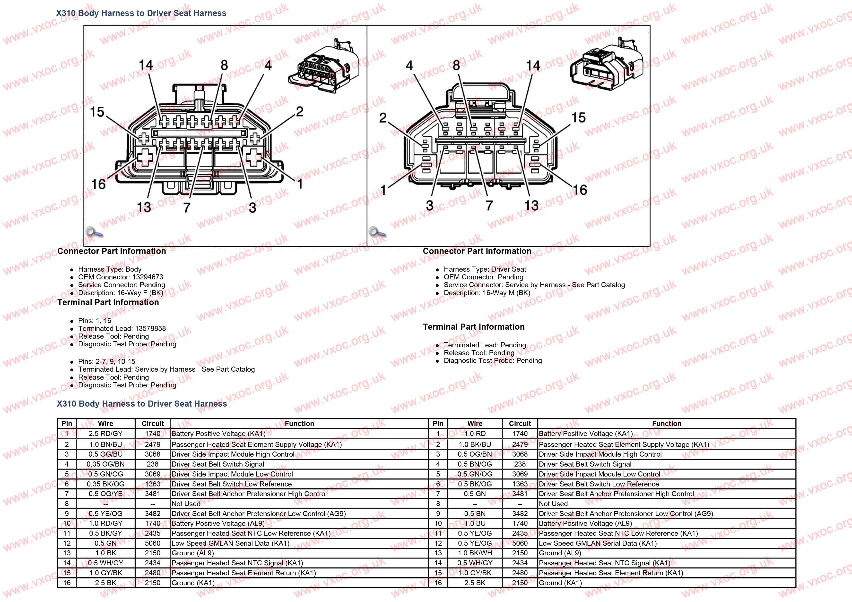

Hi all after some help,, Looks like my car has the 21 pin connector under the seats,, dose anyone have the wiring diagram for these connectors ??
James.
(28:th-Nov-2016, 12:34:52)jj120979 Wrote: Hi all after some help,, Looks like my car has the 21 pin connector under the seats,, dose anyone have the wiring diagram for these connectors ??
James.
Should be in the first post.

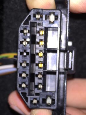

this is my connector under the drivers seat its slightly different are the pin the same??
[attachment=771]
[attachment=772]
if someone could let me know if they think i have the correct wires for the heated seats i would be very greatfull

Hi guys, replaced my seats today in my 11 plate, with seats from 14 plate, drivers is heated etc with electric lumbar, passengers just heated. Passenger one fitted fine but my drivers seat connector is totally different, can anyone point me in the right direction? Will I have to entirely unpin the connector then either use old connector housing or just spice them in one by one?
Here's a photo of the drivers side connector. Passengers was same as old seats and no Probs!
https://www.dropbox.com/s/lwjqz9kebq5kuv...3.jpg?dl=0
(24:th-Sep-2018, 14:36:12)letsgetrdy Wrote: Hi guys, replaced my seats today in my 11 plate, with seats from 14 plate, drivers is heated etc with electric lumbar, passengers just heated. Passenger one fitted fine but my drivers seat connector is totally different, can anyone point me in the right direction? Will I have to entirely unpin the connector then either use old connector housing or just spice them in one by one?
De-pin and use old connector is your quickest option.
Thanks for your reply, ignore my snip job but I done it temporary, tomorrow I will solder and seal. https://www.dropbox.com/s/93oxcd7d212mdr...4.jpg?dl=0
I used the old connector from old front seat and then just wired up every wire it had (very few). Car side I'm good to go I have every pin there, just trying to work out what to do with two mysterious wires, namely a smaller red one and a second grey / black cable but with a bigger amount of black so I'm guessing BK/GY, but can't find any mention of it.
This is what I'm down to - https://prnt.sc/ky68fx
I've been referencing this from this forum - https://www.vxoc.org.uk/Images/vxoc%20as...arness.jpg
Any help on what the last red and bk/gy could be would be appreciated.
Thanks for the reply, I've used the old adapter from original seat and only wired up the wires it had (very few), could do with some guidance on the remaining wires in terms of where to pin them, I've tried staying to the pin layout on page one but I have a couple of extra cables that I'm unsure what to do with, namely a small red one and an aditional BK/GY one which are not listed on the drivers side cable layout, so I'm unsure what they do or where to put them, however like I said I have all the pins car side so more than enough pins to accommodate, just don't know where to place them in the plug seat side.
Ive been referencing this from another post too - https://www.vxoc.org.uk/Images/vxoc%20as...arness.jpg
Any guidance one what to do in regards to the mysterious two cables would be greatly appreciated! Excuse my temporary cabling I had ten mins before school run to get it up and running and wasn't sure how car would react to an unplugged drivers seat haha!
Pin 11 Black/grey = Passenger Heated Seat NTC Low Reference
I can't find any refence to the red one but is it 1mm?
It could be pin 10 = Battery Positive Voltage (LUMBAR DRIVER-SEAT)
