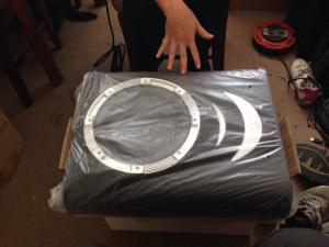

Well my little Sub arrived today not sure I would class it an under seat sub tho.
#52
big seat then but still it looks good
