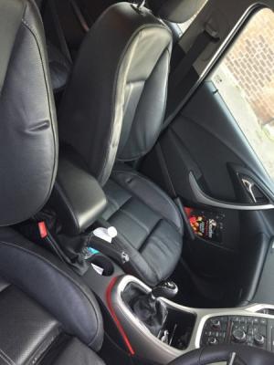

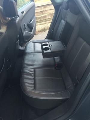

They managed to install everything and get everything working minus the heating element anyway! I'm made up with it Big grin see the photos below of them installed in my car Smile
[ATTACH]331[/ATTACH]
[ATTACH]332[/ATTACH]
[ATTACH]333[/ATTACH]
He forgot to take a photo of the cable under the seats though :-/
#65
Looking good Doublethumbs
Get a hair dryer on them seats and get the wrinkles out.

Hi Guys,
So the cowboy who fitted my seats appears to have not done the back one properly and/or broke the clip while doing it. Basically the back seat isn't clipped into the actual base properly so I can lift it up really easily. From feeling around it feels like one of the metal prongs which is covered with a black plastic clip isn't actually clipping into the base properly...it actually feels like the black plastic clip is broken.
Does anyone know where i can get another one of these from?
#74
There should be a black bit which goes into a white bit or other way round, I will get the part number later for you it will be a Vauxhall or autovaux order thou.
#75
I've seen the black clip which sits on top of (covers) the metal prongs which are in the seat cushion, that's still there but feels broken and just isn't clipping into anything in the seat frame...so not sure which I'd need...ill order both if they are cheap.
Thanks a million Smile
#76
Could you not take the part of your old seat?

Yeah probably the garage that broke it! But all sorted now and cleaned the interior too with the leather cleaner Smile
Just out of interest what did people pay for their seats. Found someone selling a set in Leeds and swears they in great condition but bit for to go if price isn't right.
