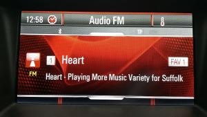

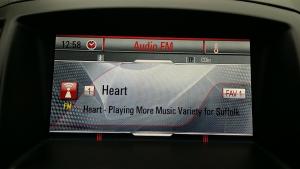

A couple of weeks ago I did the 600 to 900 upgrade so i could get the red background. Everything went great and worked superb. Yesterday my USB and SD stopped working. I get on screen at start up at warning as shown on attachment saying 'Unsupported UB device'. I have tried a soft reset by opening doors closing door turning off on etc and it never worked. I have disconnected the battery for 30mins and still the same. Would I be able to use the v208 update cd iso to try to fix this. I read somewhere this is a fix for it but dont want to try if its not compatible with the 600-900 update. Any ideas/suggestion/help much appreciated
I upgraded my 600 to 900 last week and all worked great. I love the red background. Anyway yesterday my sd/usb stopped working and I get the attached message up. Do I need a new module or will I be able to use a v200 / v208 cd to upgrade the navi? I tried discconecting the battery ofr a 30mins and that didnt work but I did read online that the v208 update will sort this issue. Has anyone got any help please?

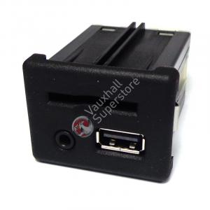

2. unplug all plugs from radio sd port and usb and replug them in.
if that fails
it's a new SD port.

Not a new USB unit a new sd unit.
The sd puts power to the USB.
I am guessing the Navi card is not being read tho.
yes my SD card isnt being read so my sat nav isnt working.
Also my usb/SD units are both in the same module as in pic so I would have to buy the whole thing.
Now Im on v208 is it possible to go back to v200 or get red background on v208. The blue/white just doesnt look good with the red dashlights

TBH I'd stick with v208 as it's the official Vauxhall release and just change the theme back, I take it you want the red/white theme that comes stock?
I had the red/blue theme but only used the red. I like the red carbon effect one from an earlier post. Is it easy to change the image pics in the iso

Many thanks Rusty2009, I have just received my new sd/usb and reinstalled the v208 update with new image files. Everything is looking great again.

I use this software at work to clone unreadable SD cards that need to be upgraded as sometimes the upgrade goes wrong, so I just put the backup back onto the SD card.
http://hddguru.com/
Phil.
Does anyone know if a bricked Navi 600 can be restored?Followed the directions to upgrade so not sure what went wrong but now have no infotainment,no parking sensors,no start stop :(.any help will be appreciated
If its bricked you need a new unit, is there anything on the screen?
The radio will not stop your s/s from working that is more down to low battery or something else.
after a lot of reading i came across to this file you upload which look exactly what i am looking for.
my question is: there is 2 files which one i use or have to be both of them uploading one at time?
i have already upgrade to navi 900 following the guide here
(31:st-Jul-2016, 22:52:20)tucpal Wrote: ok try this v200 with better poi speed cam icons and night sky in nav map night mode
insignia startup and shutdown logos it should be set up for ople and griffin units
gray carbon day and red carbon night themes.
https://www.dropbox.com/sh/j3kovjd6eq6z9...drSta?dl=0
I am having trouble installing the update. It keeps failing flashing fail in white and blue. I'm not sure if I wrote the disc properly but have burnt it about 10 times. Can anyone help or is anyone in the buckinghamshire area to help.
Thanks in advance
Karim
after several attempts, I eventually got the CD to run.  It spends about 5 minutes reading the CD going through the deletion stage etc but always finishes with the word FAILED.
Is there any way of going back to the NAVI 600??  I have installed the USB DNL and it was successful but I am now without any entertainment system.
Simon
are you using a quality CD?
It does fail on the CD iirc at about 50% you then insert the USB
Als ik begonnen ben met de upgraden 600 naar 900 kan ik dan nog terug?
Groet rob
Can this be done without th SD car inserted as have just got a new to me insignia and there is no SD in the slot or with the car?
Hey guys! Trying to update from navi 600 to navi 900 managed to install the stuff from the memory stick but I can't do the stuff from the disc. I burned the disc with windows 7 manual burning. That is the disc
And the file which I need to upload on the disc is that one, right?
Sd600_900.iso
