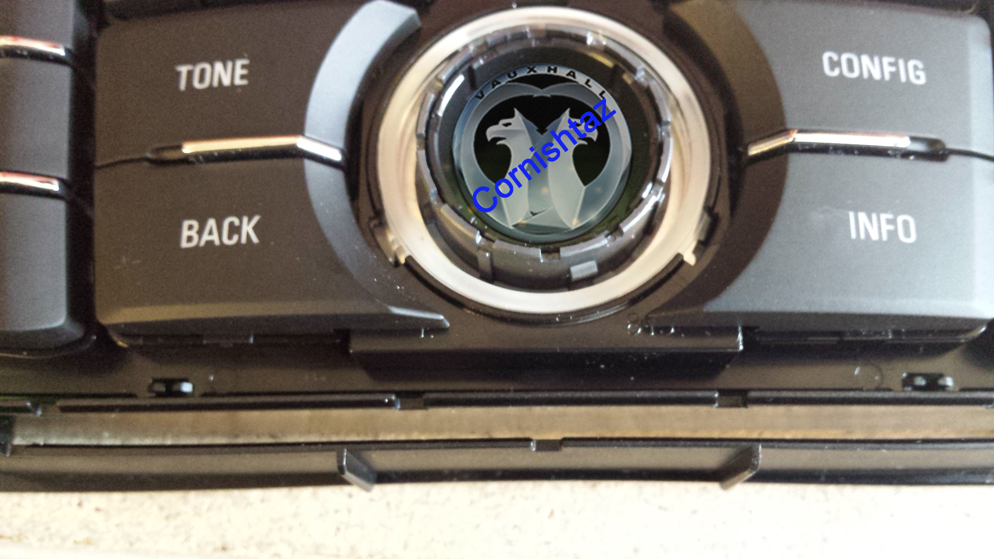

This is How-to for changing the LEDs in the stereo and centre console switches
Tools required
Stubby Philips s/driver
Small flat blade s/driver
7mm socket
T8 driver
Fine tip soldering iron
Qty 30 805 smd leds for stereo

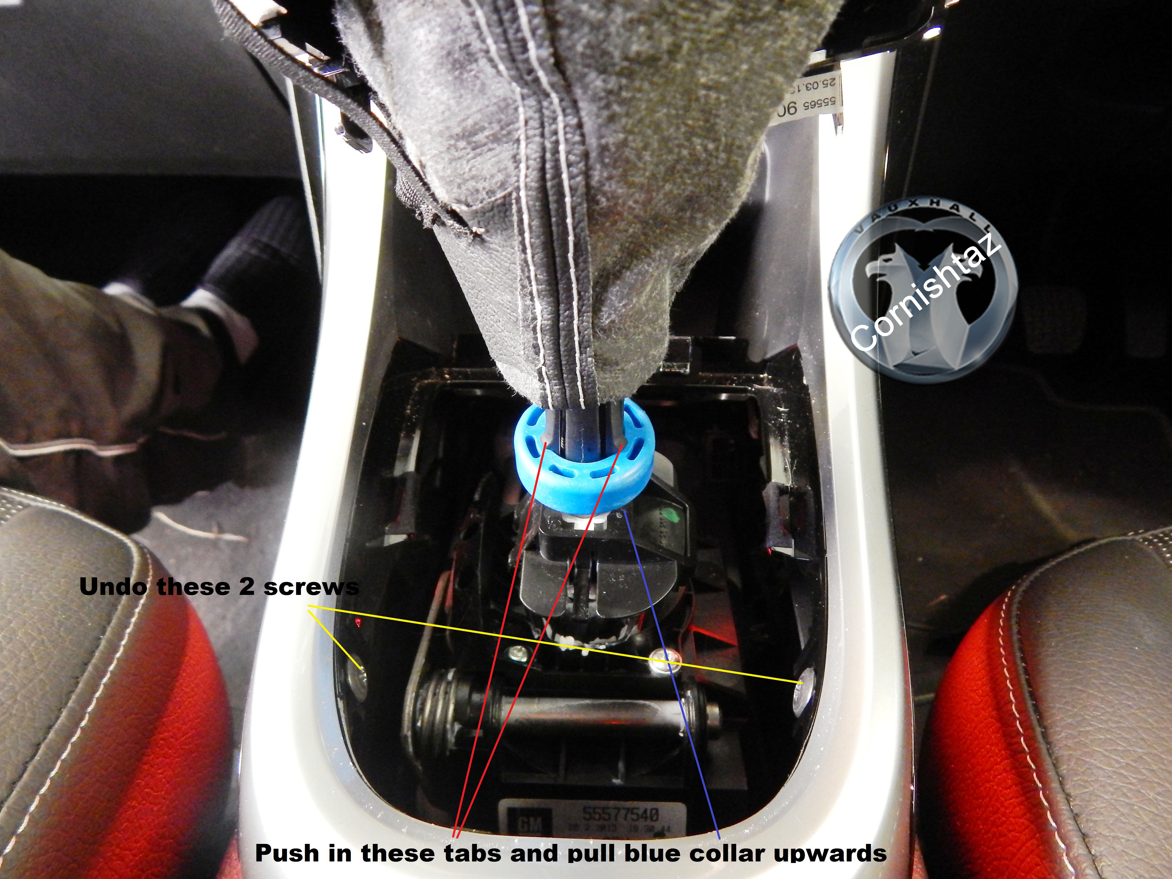

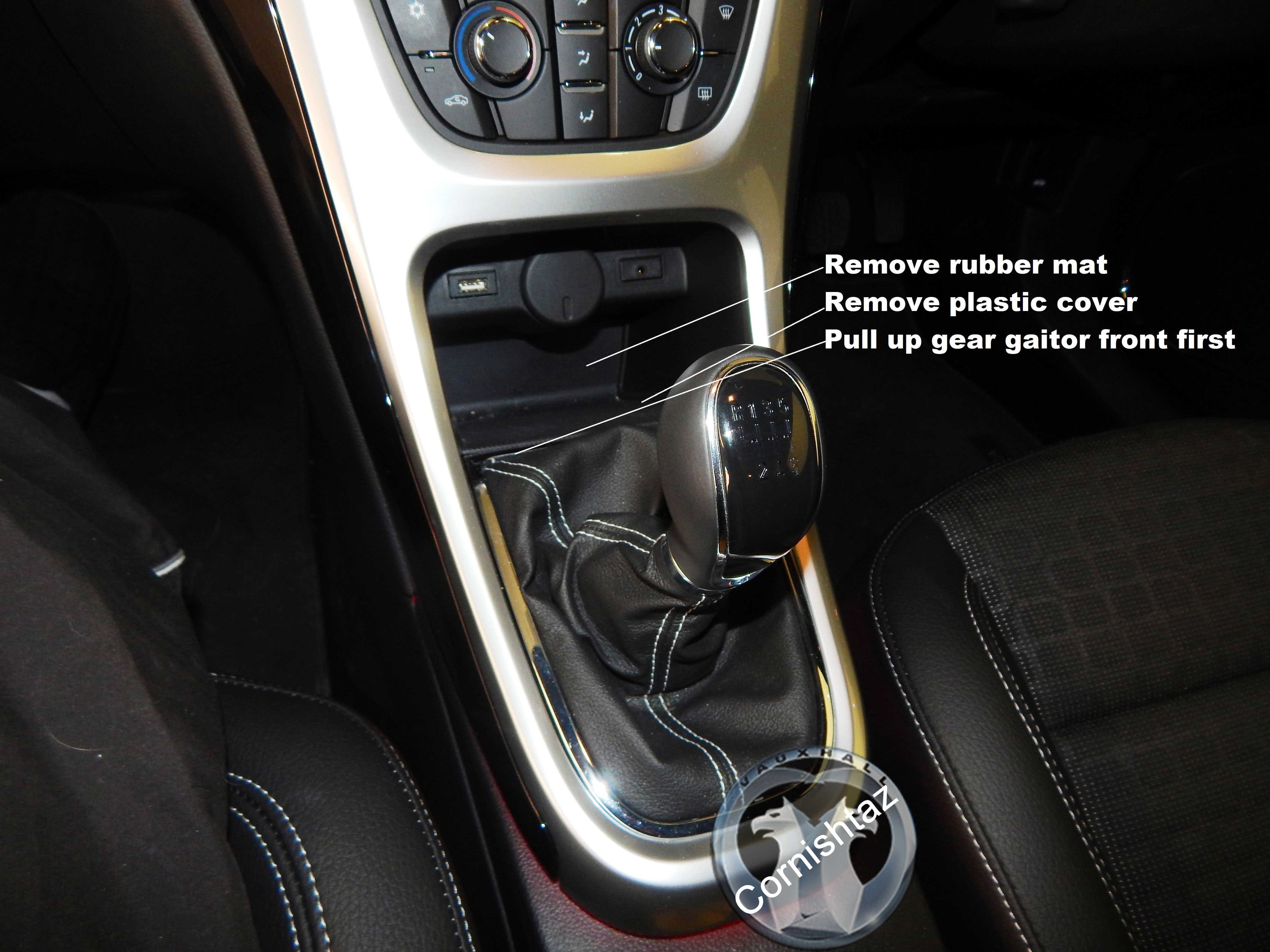

Start by removing the following parts. 1. Rubber mat 2. Plastic cover 3. Gear gaiter
[Image: 1.JPG]
I removed the gear gaiter completely by pushing in the 2 black tabs and lifting the blue collar. You can remove the 2 screws holding the centre console surround, then remove the surround completely.

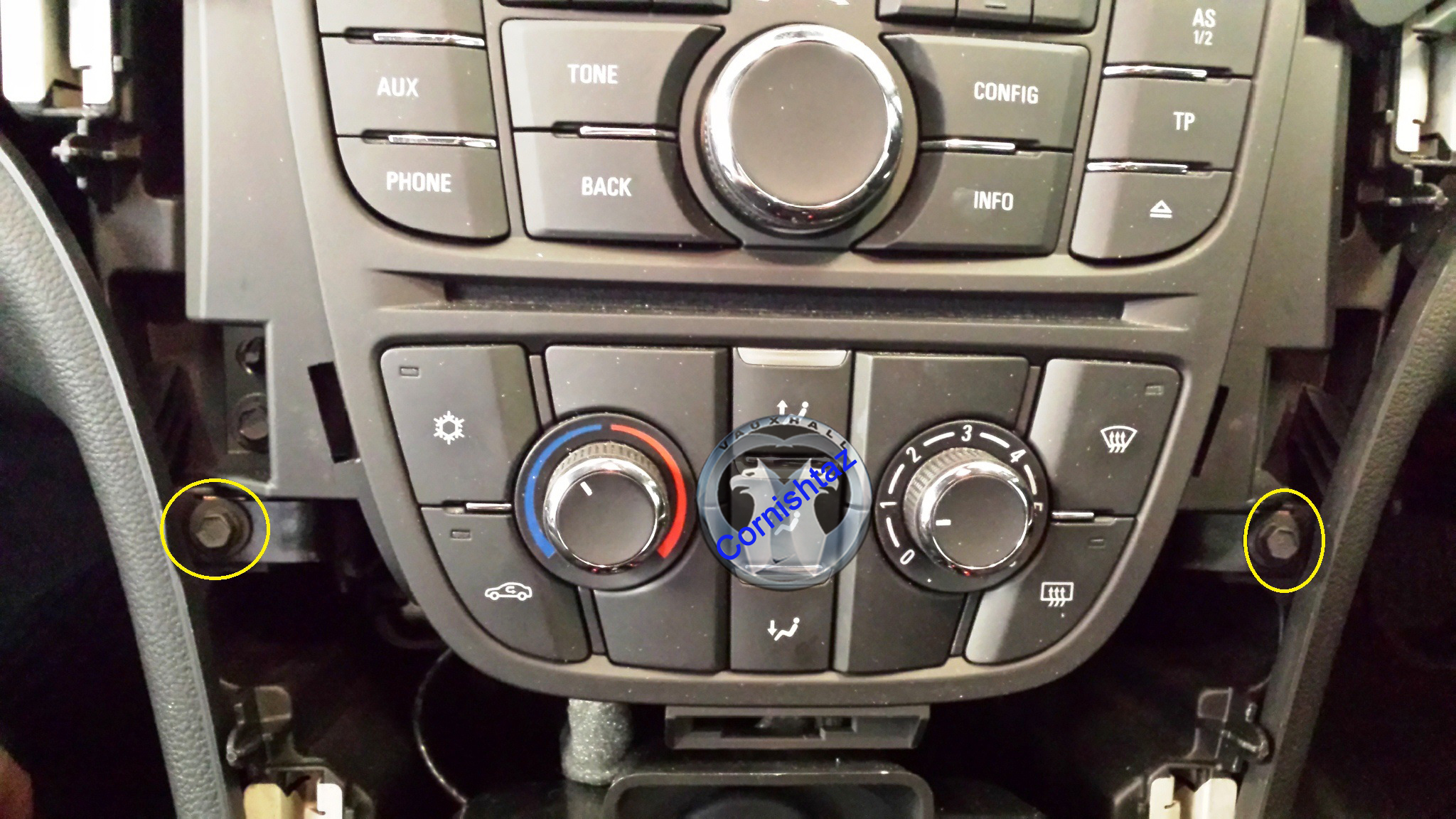

There a 4 7mm bolts to be removed
[Image: 3.JPG]

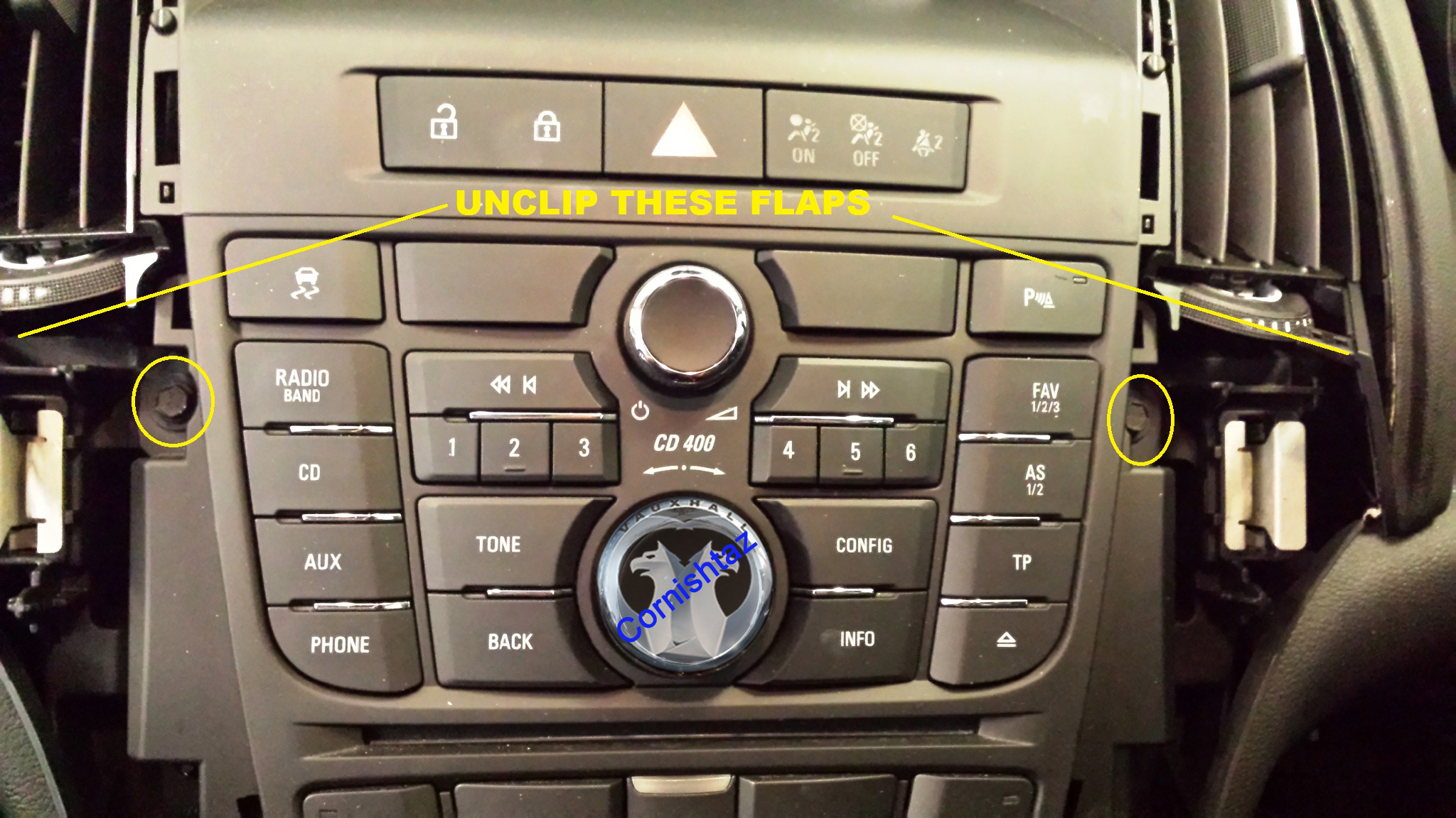

2 are located behind two flaps by the centre air vent
[Image: 4.JPG]

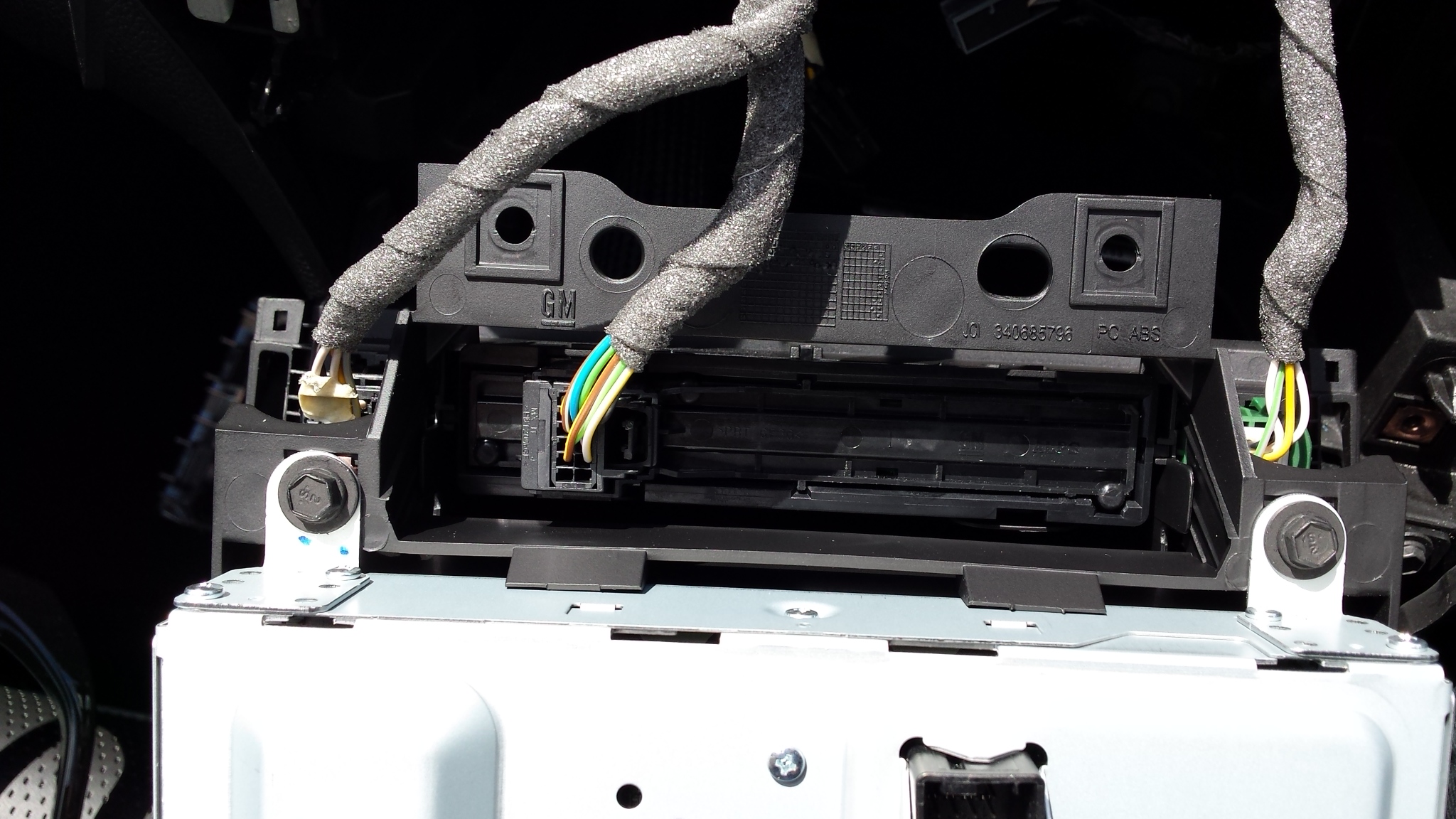

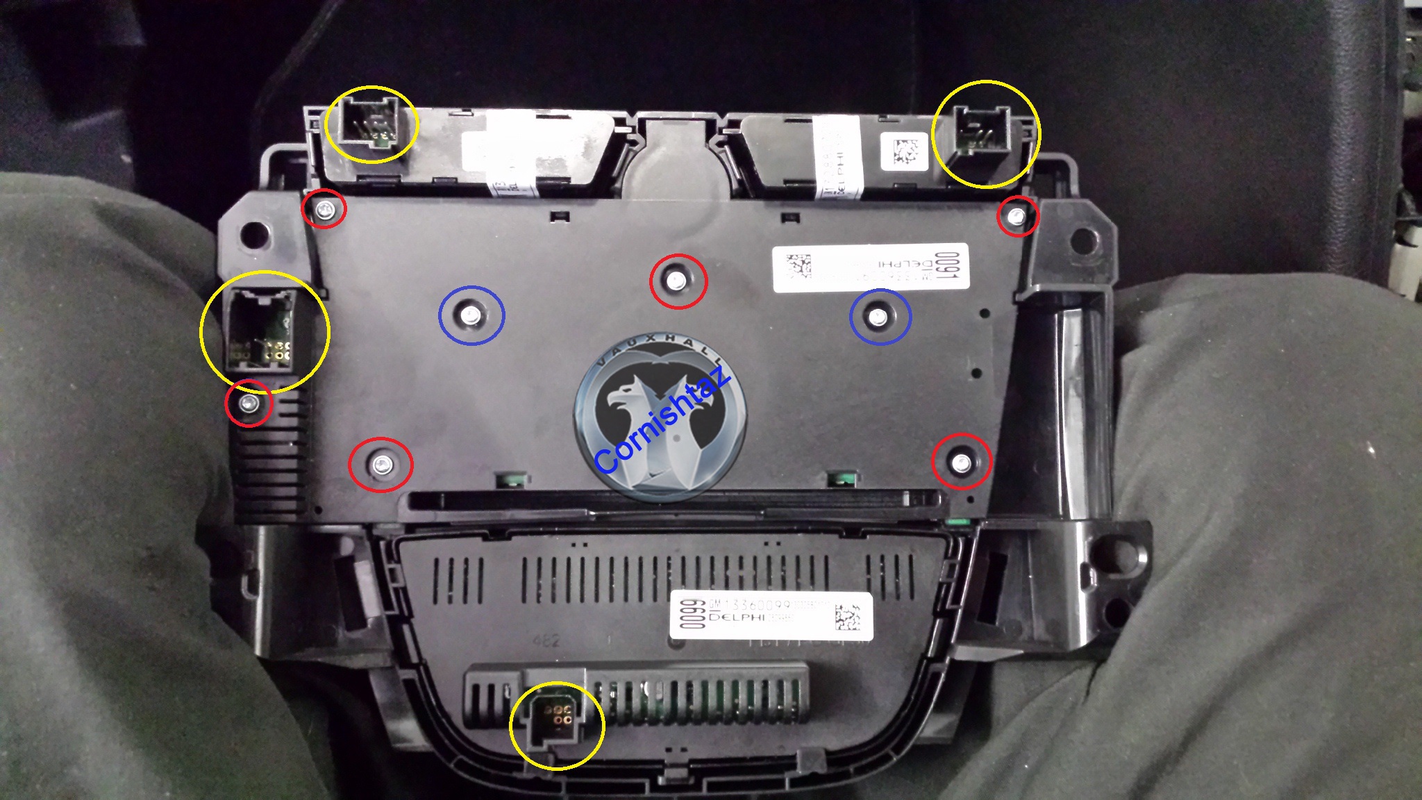

Disconnect the elec connectors circled in yellow, remove T8 screws circled in red and remove the stereo buttons from the housing
[Image: 5.JPG]

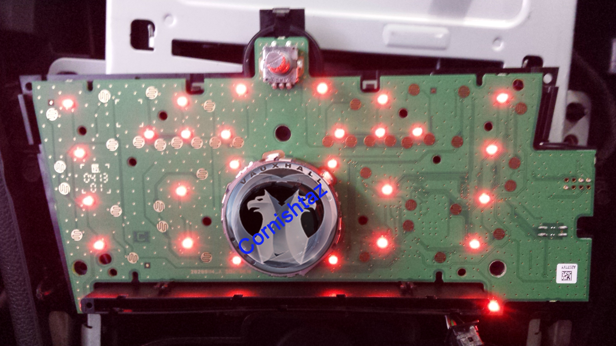

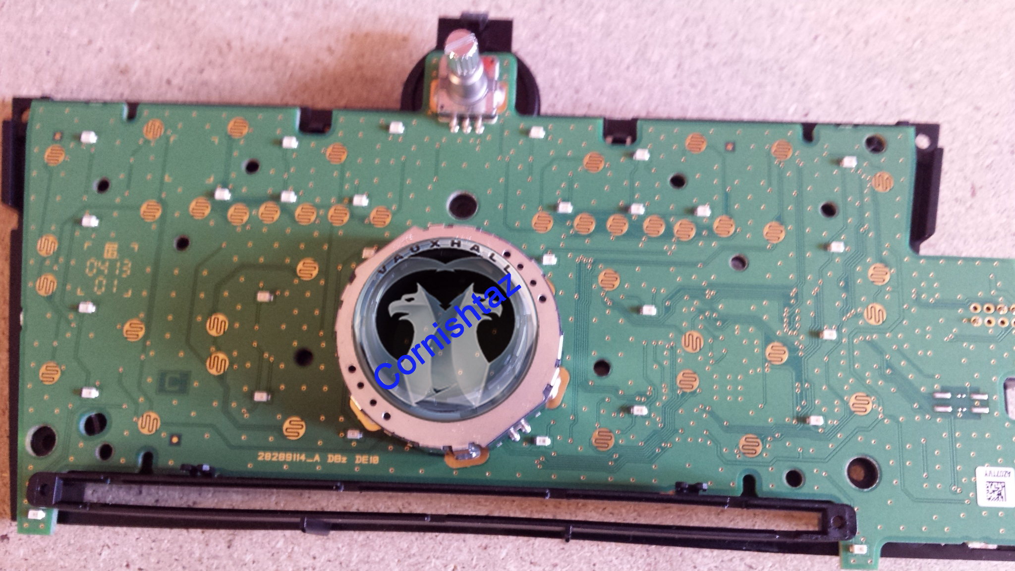

Remove knobs and rubber cover to expose the circuit board
[Image: 7.JPG]
[Image: 8.JPG]

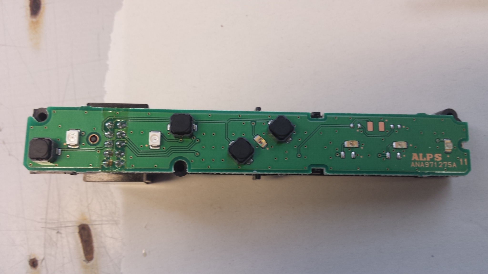

Tabs for removing TC/Eco/Park assist Switches 1 at each end of the switch
[Image: 9.JPG]
Carefully remove the label and remove switch back unclipping 4 tabs
[Image: 10.JPG]

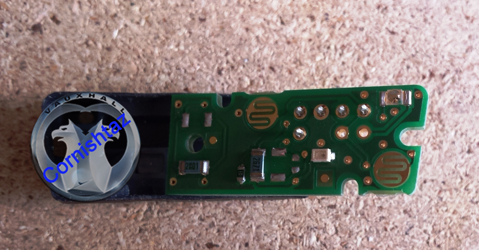

Replace the lower 805 smd led
[Image: 11.JPG]

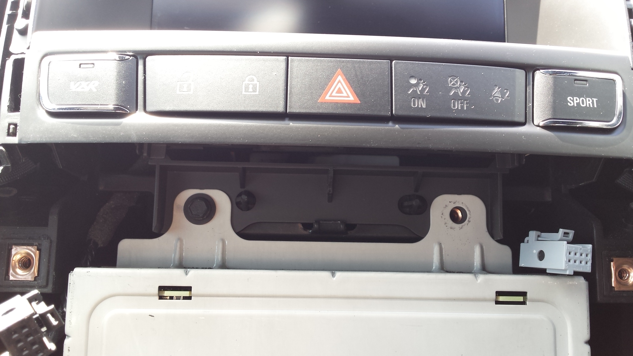

Remove 2 7mm bolts holding stereo and display surround
[Image: 12.JPG]

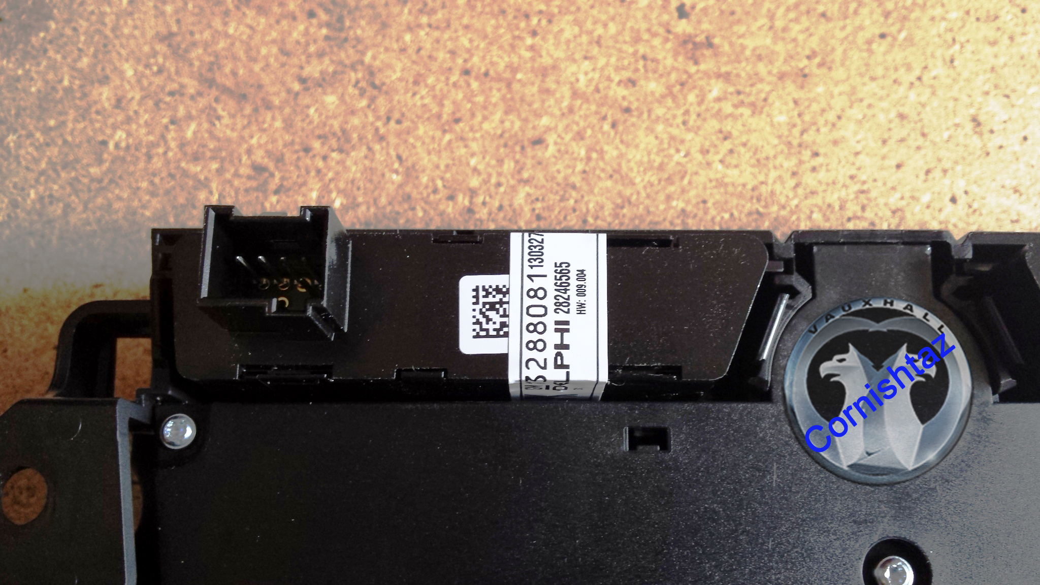

Remove the switch electrical connectors
[Image: 13.JPG]

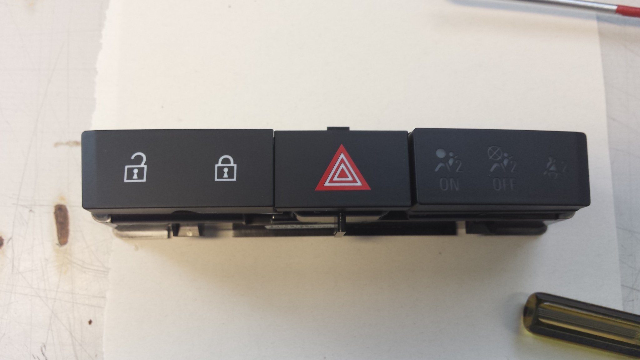

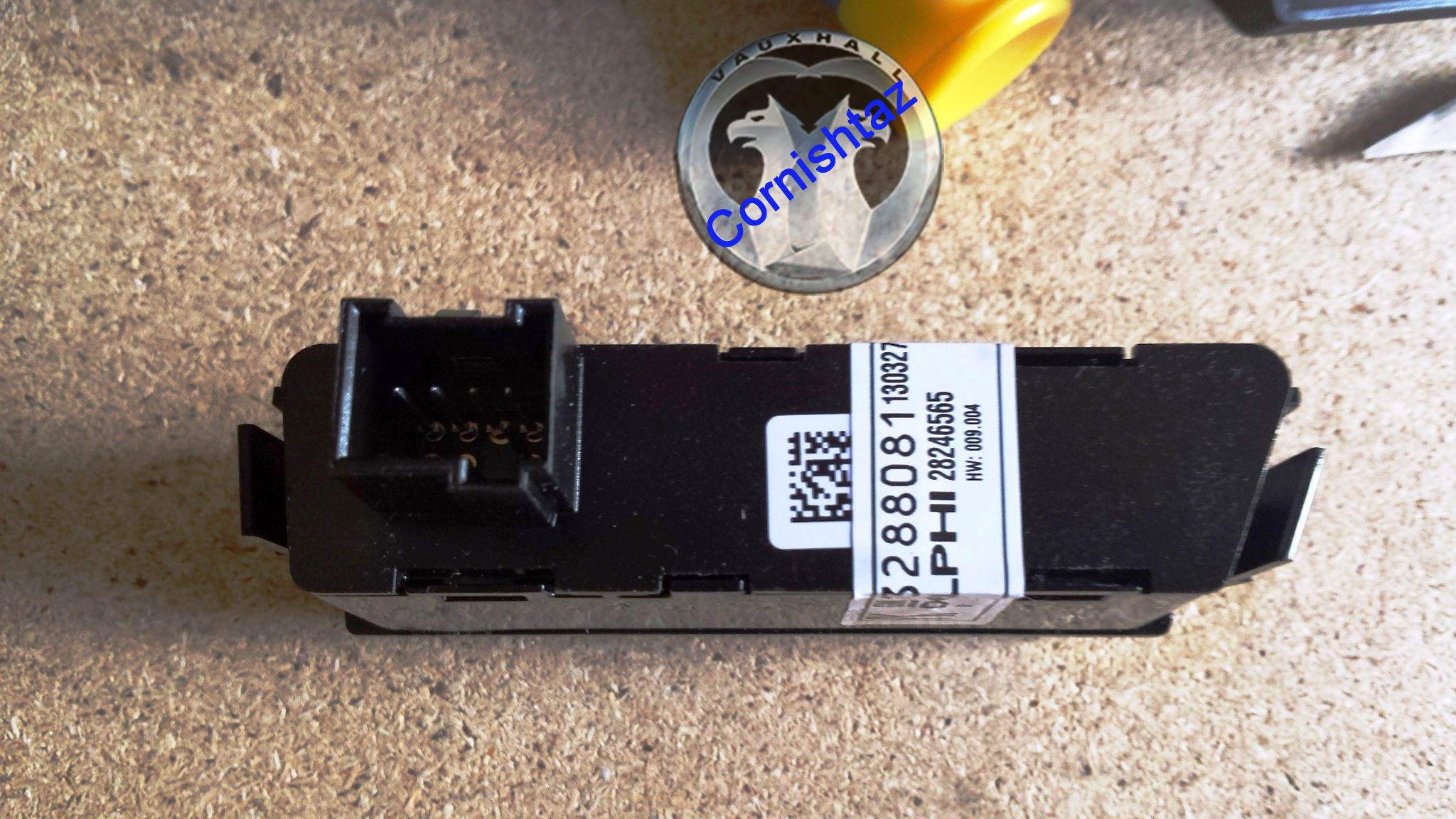

Door lock switch assembly
[Image: 14.JPG]

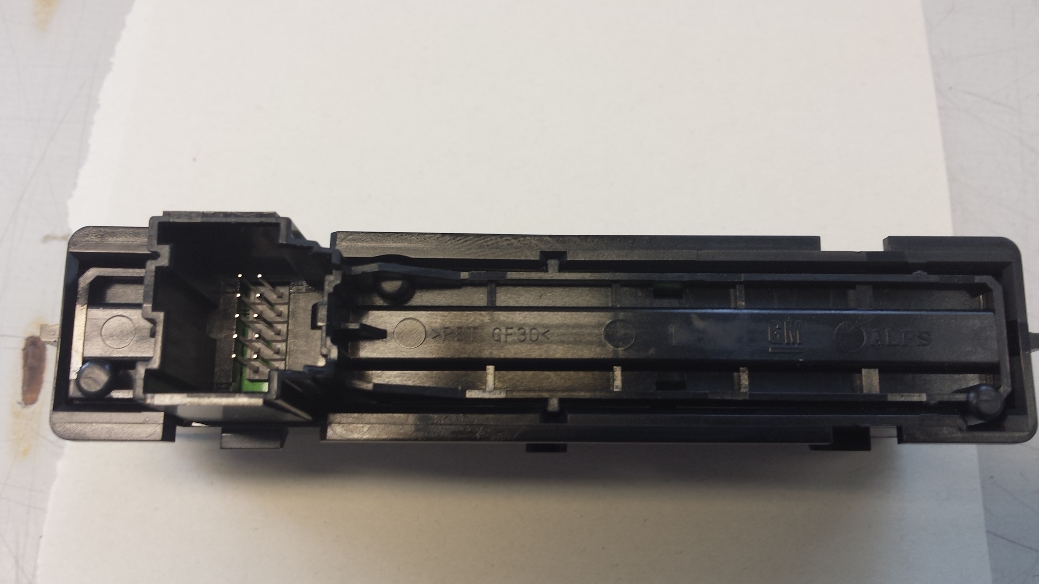

Remove the rear of the switch assembly
[Image: 15.JPG]

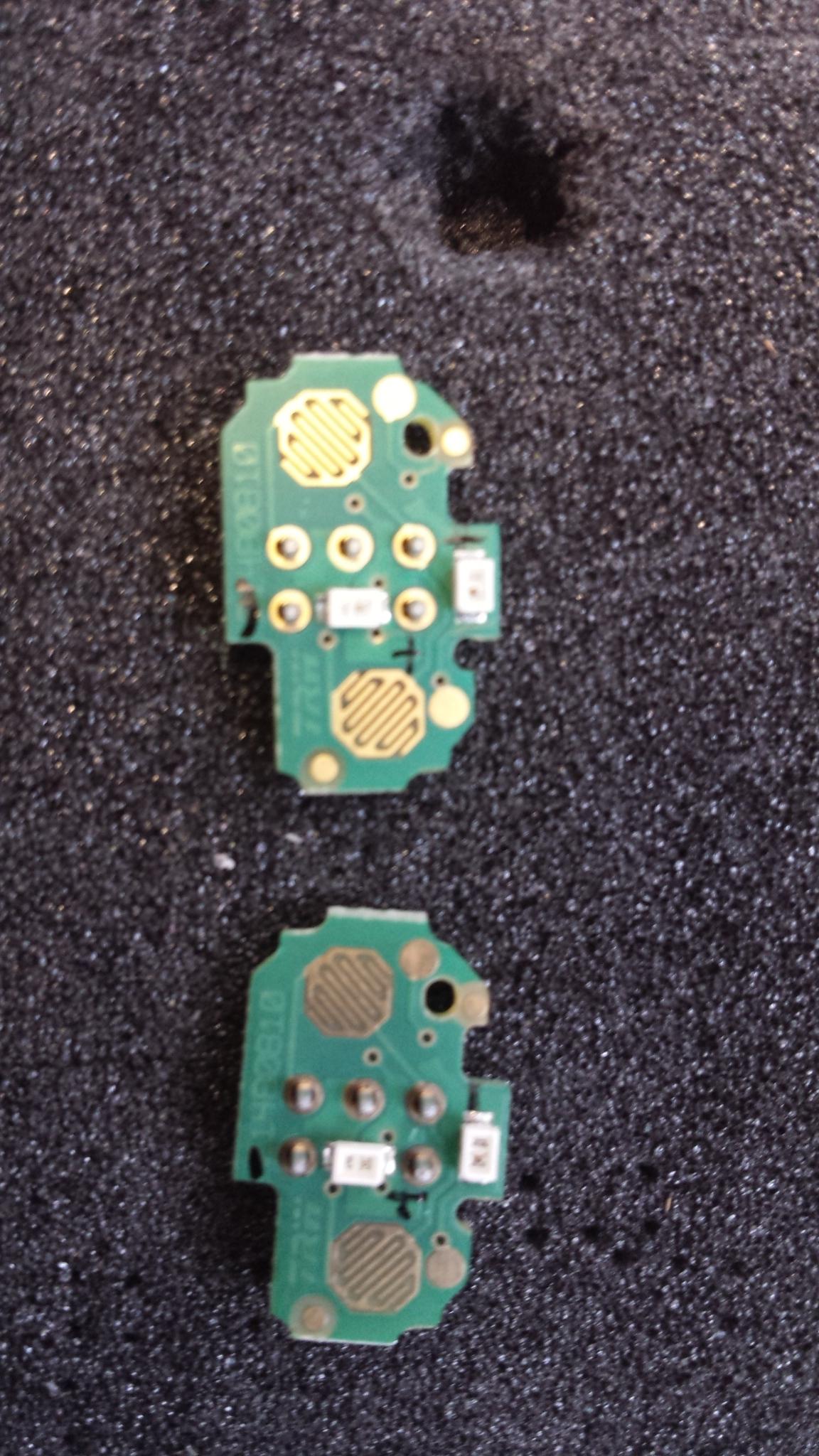

Qty 2 PLCC-2 leds required(lefthand 2)
[Image: 16.JPG]

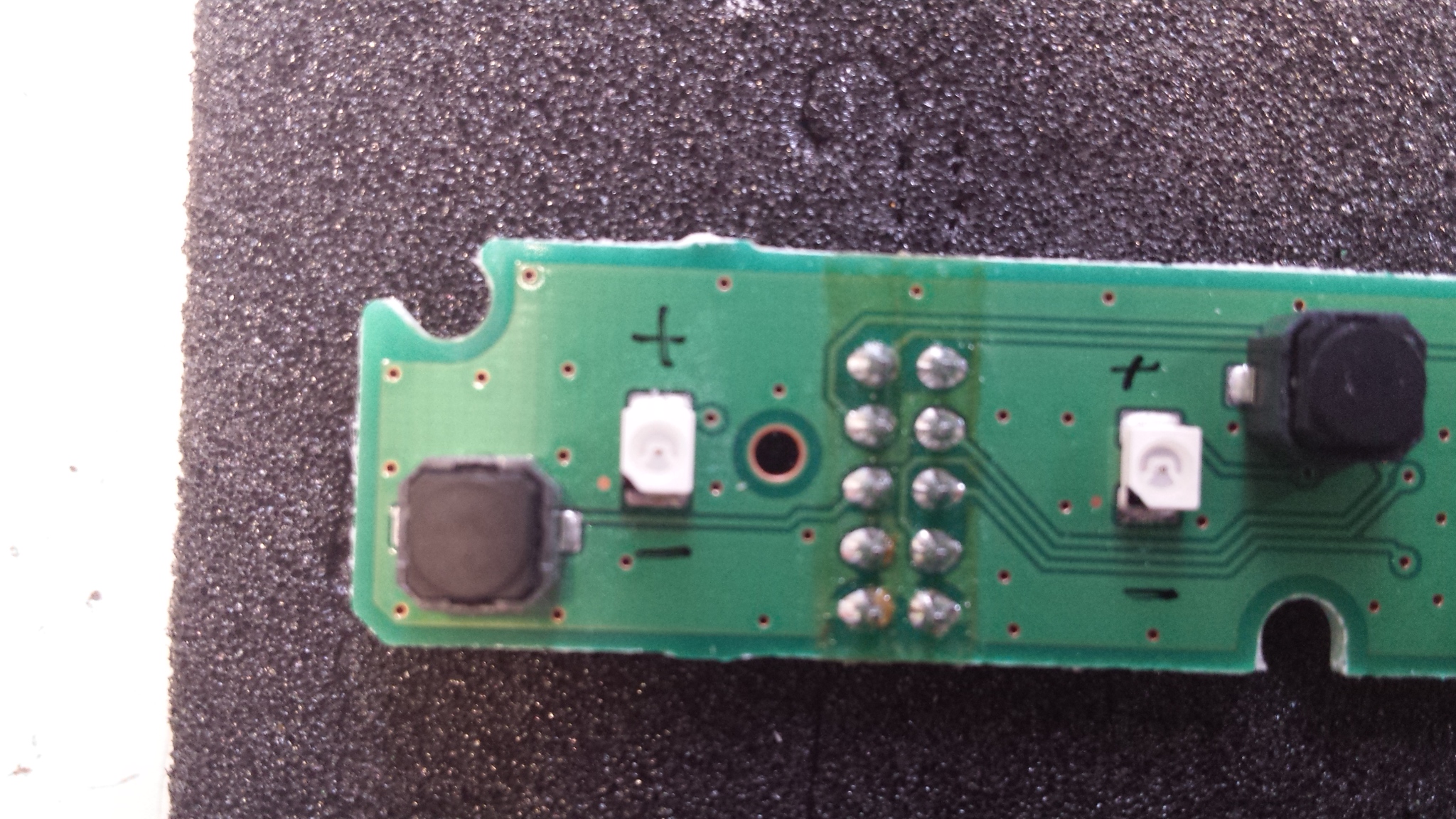

Switch led orientation
[Image: 17.JPG]

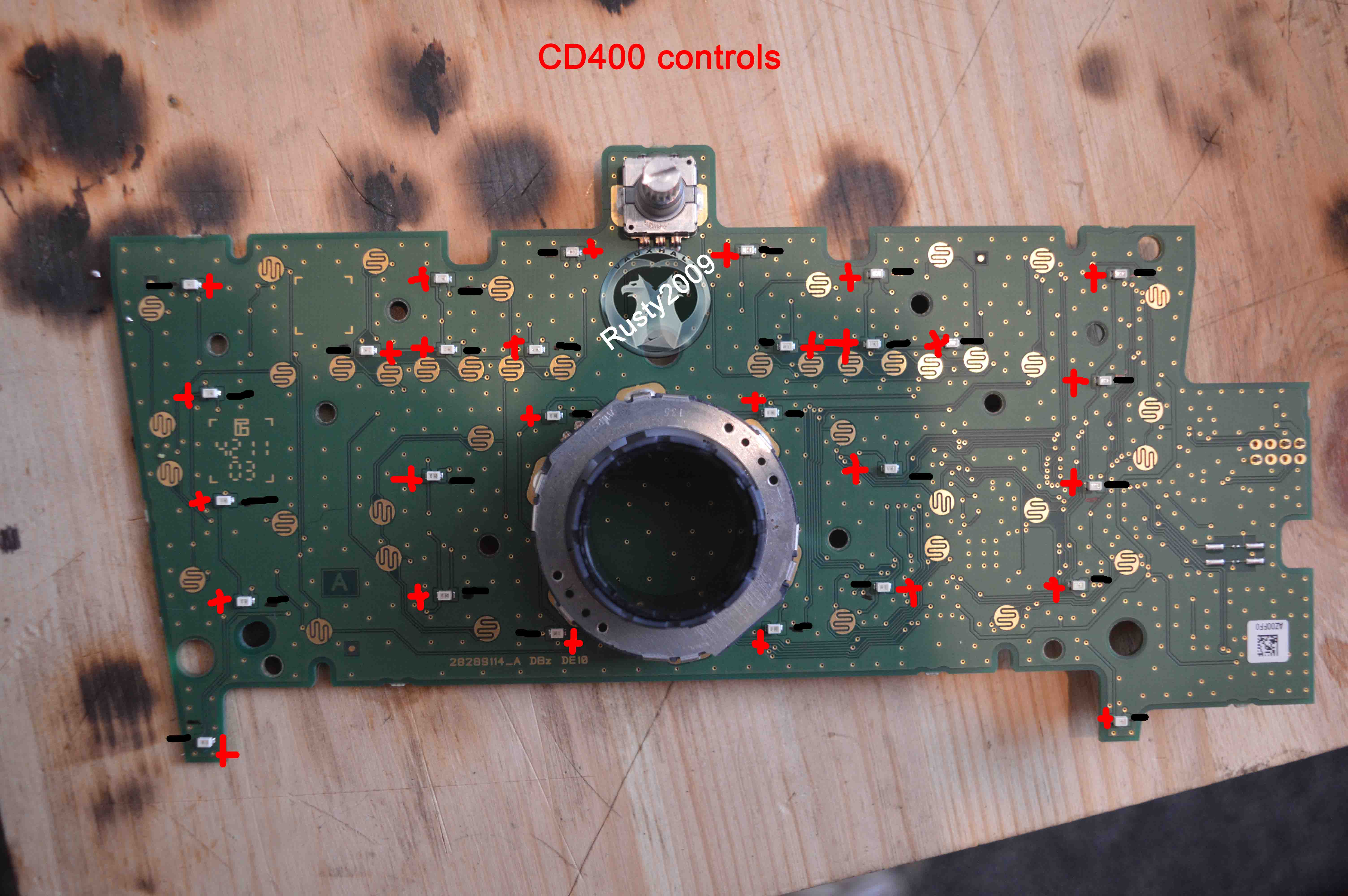

Here is a image showing the positive and negative of the led's on a CD400 board
[Image: cd400.jpg]
