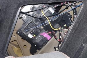

Speaker wires go into the 4 coloured pins in this pic.
[Image: 2.jpg]
Pin 33 = RED = Right Rear Speaker Signal (-) (Factory colour = Blue/Black)
Pin 34 = Orange = Left Rear Speaker Signal (-) (Factory colour = Green/Black)
Pin 41 = Green = Right Rear Speaker (+) (Factory colour = White)
Pin 42 = Pink = Left Rear Speaker (+) (Factory colour = Green)
Please take note the factory colour can change and is only given as a guide.

Thanks Rusty, it says Red, Orange, Green ,Pink, is that the colours of the converter wires?
As i can see the wires from converters are Red, Green, Black, White?
No it's not the colour of converter wires these are just colours which the OP used to highlight the pins/wires on the plug.
Have got a link the converter you have & I'll have a look for you.
(12:th-Dec-2019, 13:27:59)Rusty2009 Wrote: No it's not the colour of converter wires these are just colours which the OP used to highlight the pins/wires on the plug.
This is the converter I bought, https://www.ebay.co.uk/itm/2-RCA-Line-Ou...313c18f977
I really appreciate your help Rusty!
I plan to install the subwoofer this weekend.
Ok so I'll list as colours from the converter to the radio pin.
Green to Pin 42 (Pink highlight)
Grey to Pin 41 (Green highlight)
Brown to Pin 34 (Orange highlight)
Black to Pin 33 (RED highlight)
Hope that makes sense.

I manage to find everything what i needed. I used colors for speakers as was written above.
Power i else is taken from left side in boot of estate.
Picture in attach if someone will needed.
