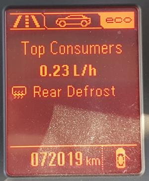

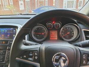

#56
Lightbulb
This is how mine looks when it is doing a regen.
[Image: dpf%20image%201_zps2ddo8alo.jpg]
This is how mine looks when it is finished doing a regen.
[Image: dpf%20image%202_zpsstgu0jcr.jpg]
#57
Happyblue module, right?
#58
Yep..
#59
