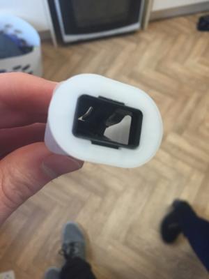

Got the clip today and the back bit is already tightly stuck inside the white bit...can I just slot the whole thing onto the metal prongs or do I have to remove the black bit and fit that first...?
[ATTACH]355[/ATTACH]
Nvm, all sorted now the other one was all snapped and cracked:
[ATTACH]356[/ATTACH]

yer they just push on to the hooks on the seat as they are with the black bit still inside the white bit
then just bang the seat down and it will fix in place
glad you got it sorted out :cool :cool
