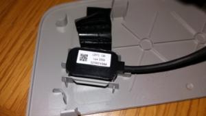

Picture 5)
Here is an image.

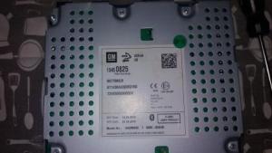

Picture 3)

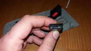

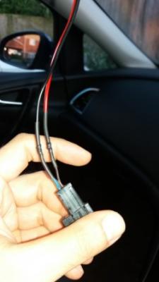

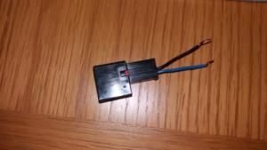

I have managed to feed wire from mic seated in roof panel around and down to central console.
Picture 3, 6, 7 and 9)

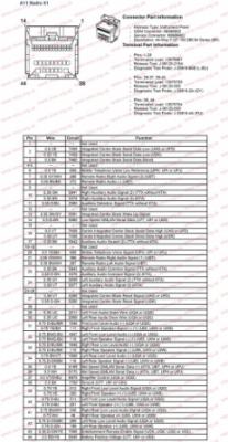

I used 2x1 core wire as female connector on mic gives me wires output of 2 BUT input is 3 wires comming from microphone, as sen on pic.

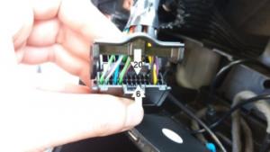

Picture 4 and 10)
I was guided by this to find correct pin on harness connector taking pins 6 and 20.
After completing it i have got no joy. Microphone is not working. I can hear other side speaking with on car speakers but that person cannot hear me.
Tried swapping a wires 6 to 20 and 20 to 6 position. Nicht, nada.
What it went wrong?
